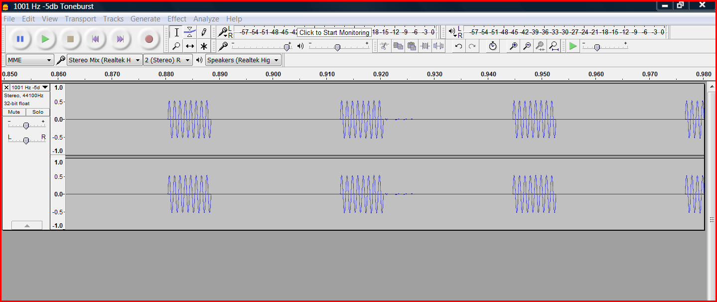

As you have a scope, here is a 1001Hz toneburst which will stress the amp far less than continuous power testing. Measure the peak to peak amplitude across the load resistor at the point visible clipping distortion sets in, and then calculate the RMS voltage. The file is an MP3 which can be burnt to CDR etc or used from an MP3 player as a source.
Example, 23 volts peak to peak across 6 ohms would be 23/2 = 11.5 volts peak. 11.5 olts peak multiplied by 0.707 gives the RMS value (8.1 volts RMS). Watts would be the RMS voltge squared divided by 6 ohms... 11 watts RMS.

One way to see the onset of clipping is to use a triangle wave.
The peak clearly shows the onset when viewed on a scope. This assumes a signal generator. Always start with the output level from the signal generator VERY LOW.
The difference in useful power measured right before clipping and somewhat below clipping is minimal.
It is sufficient to see that the output of the amp is able to reach up to or nearly up to the power supply rail voltage on the scope. That verifies that the amp meets the nominal published spec.
You can work that backwards to a nominal power rating merely by measuring the rail voltage and plugging 0.707 of that into the Ohm's law power equation, WRT a nominal load resistance - like 8 ohms.
