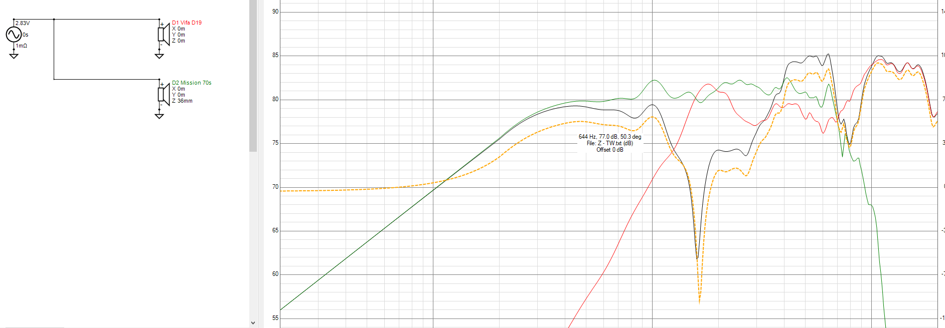

If you want to determine the Z offset at a fixed distance and angle
1. Measure driver 1
2. Measure driver 2
3. Measure driver 1 + 2 in parallel
4. Load #1 and #2 into a simulator (check minimum phase checkbox) and wire these in parallel with the source in the simulator (no crossover components)
5. Overlay #3 onto the response
6. Increase the Z offset on the driver that is furthest away from the mic, until the summed curves of #4 match #3
For example - in the following (using numbers above):
#1 = red
#2 = green
#3 = orange (dashed)
#4 = black

I just want to optimize my designs and I feel that physically aligning the drivers in the z plane would help with some alignment issues I have seen with my other builds.
Got it, that makes total sense. I will design a rig so that I can easily measure this offset using your method. Thanks for the help
