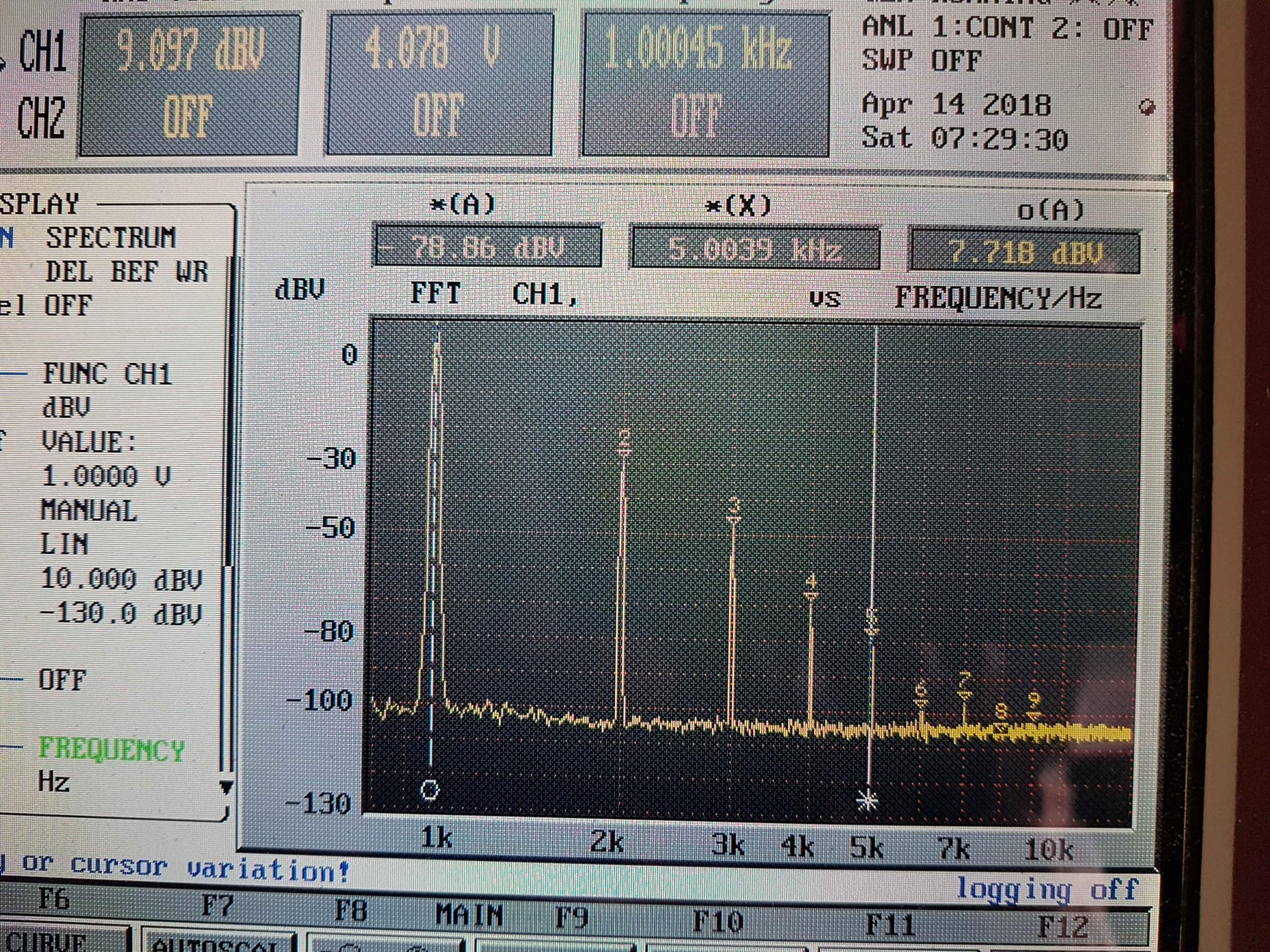

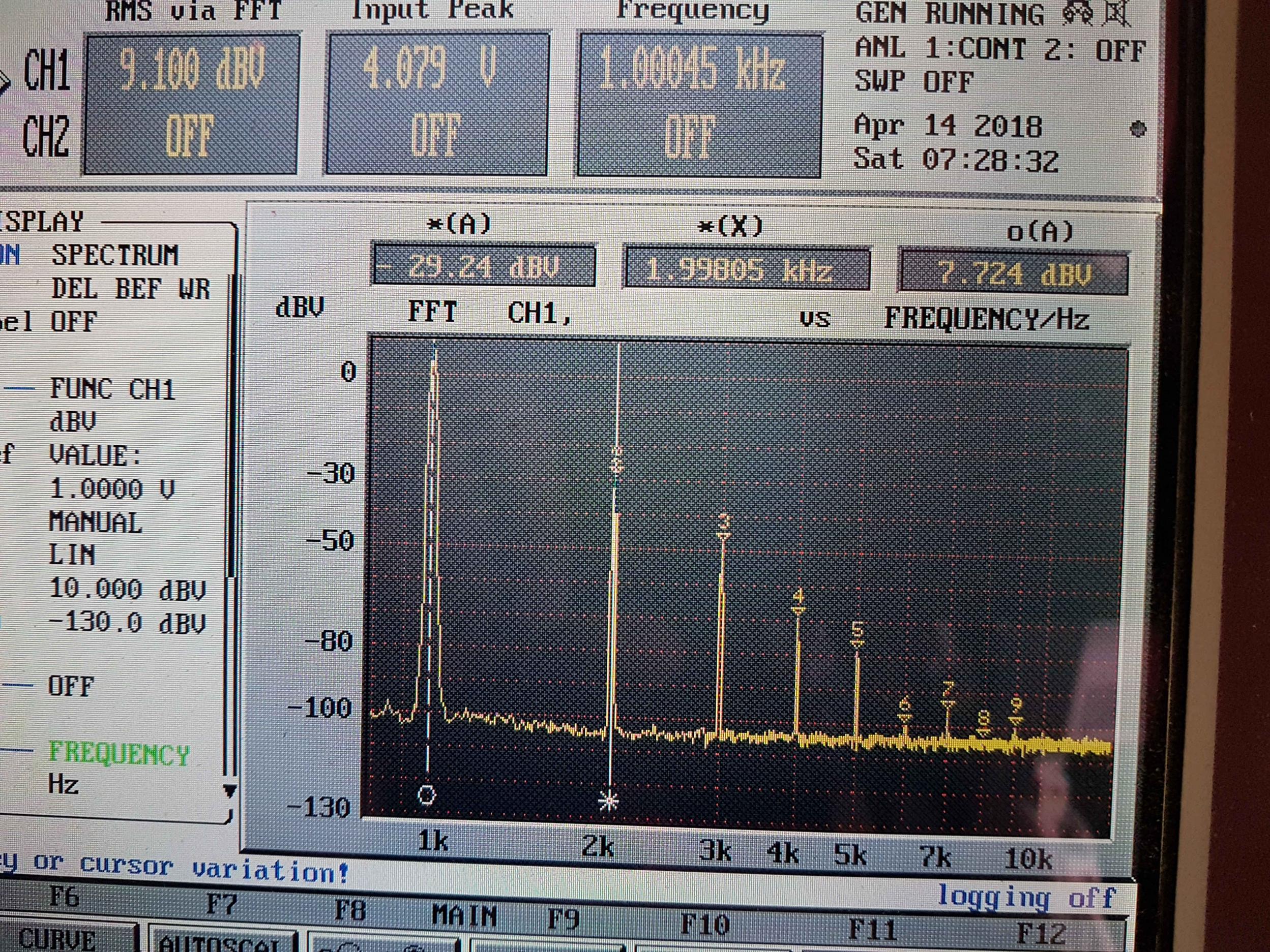

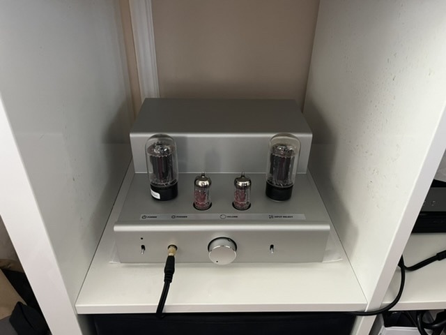

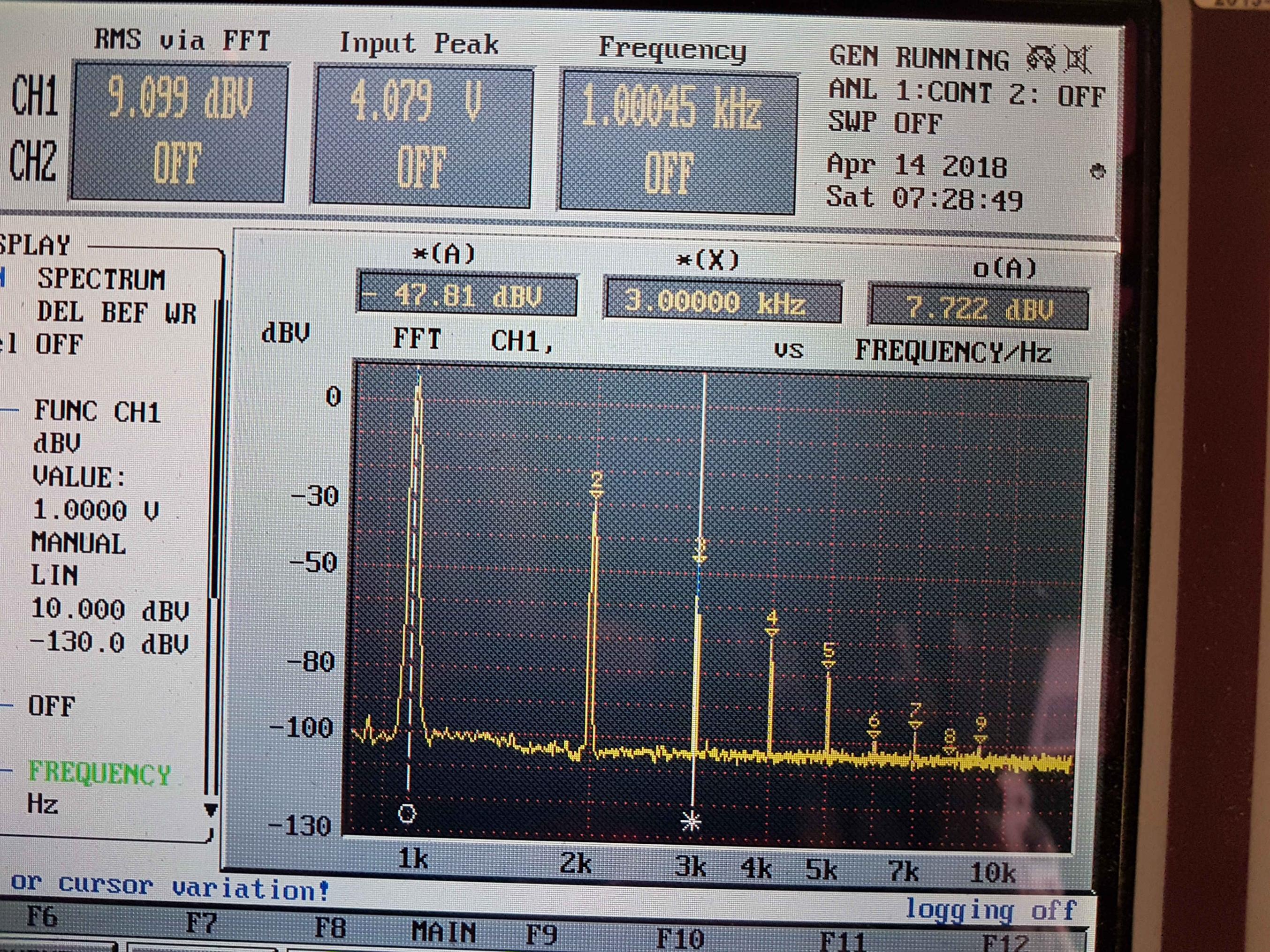

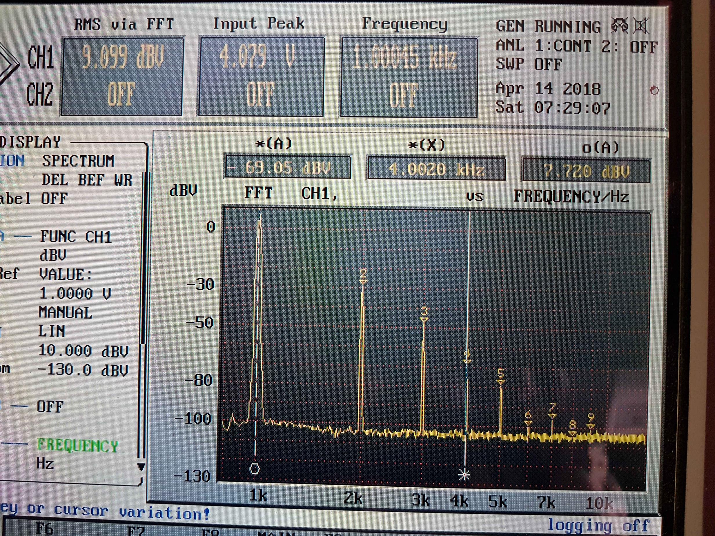

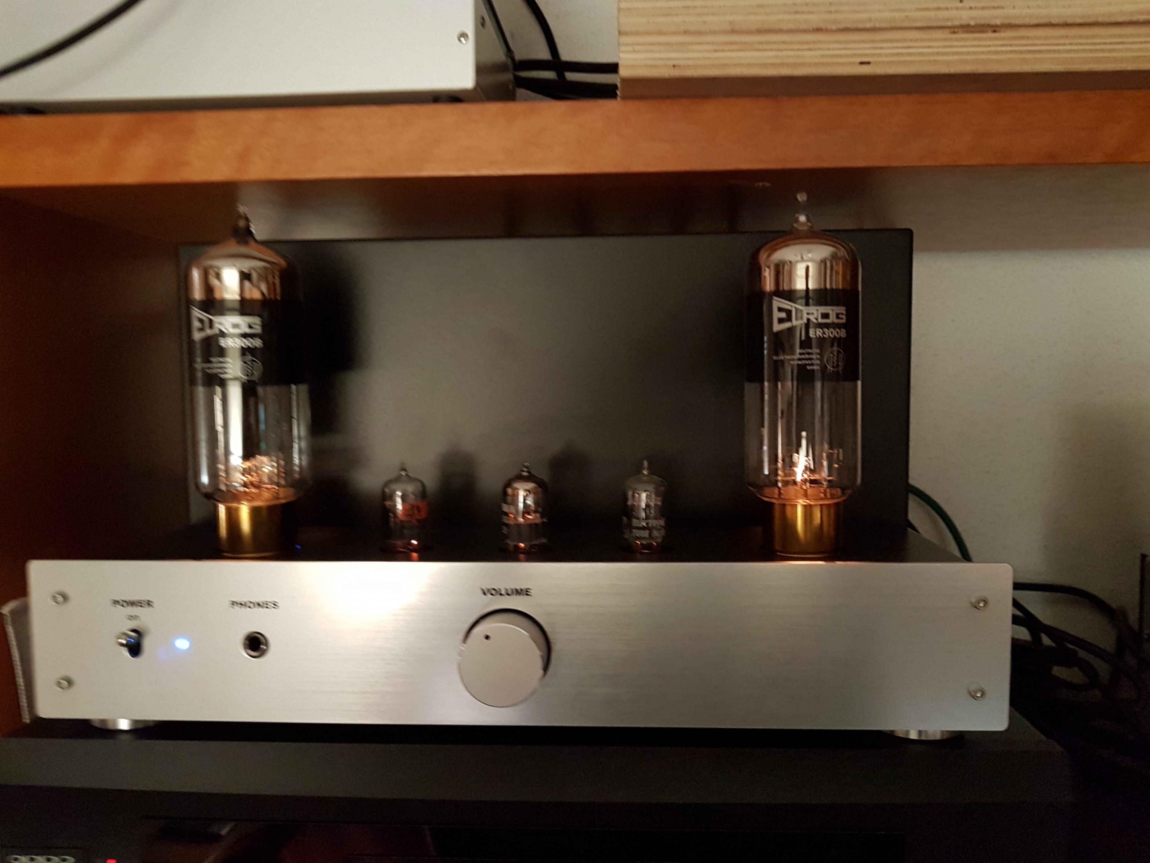

Hello all. I own a TU8600 some month already. I have done a lot of tube rolling and at least I found the tubes like me (12AU7 RCA clear top, Tesla E83CC and EML300b Mesh or ELROG 300b.

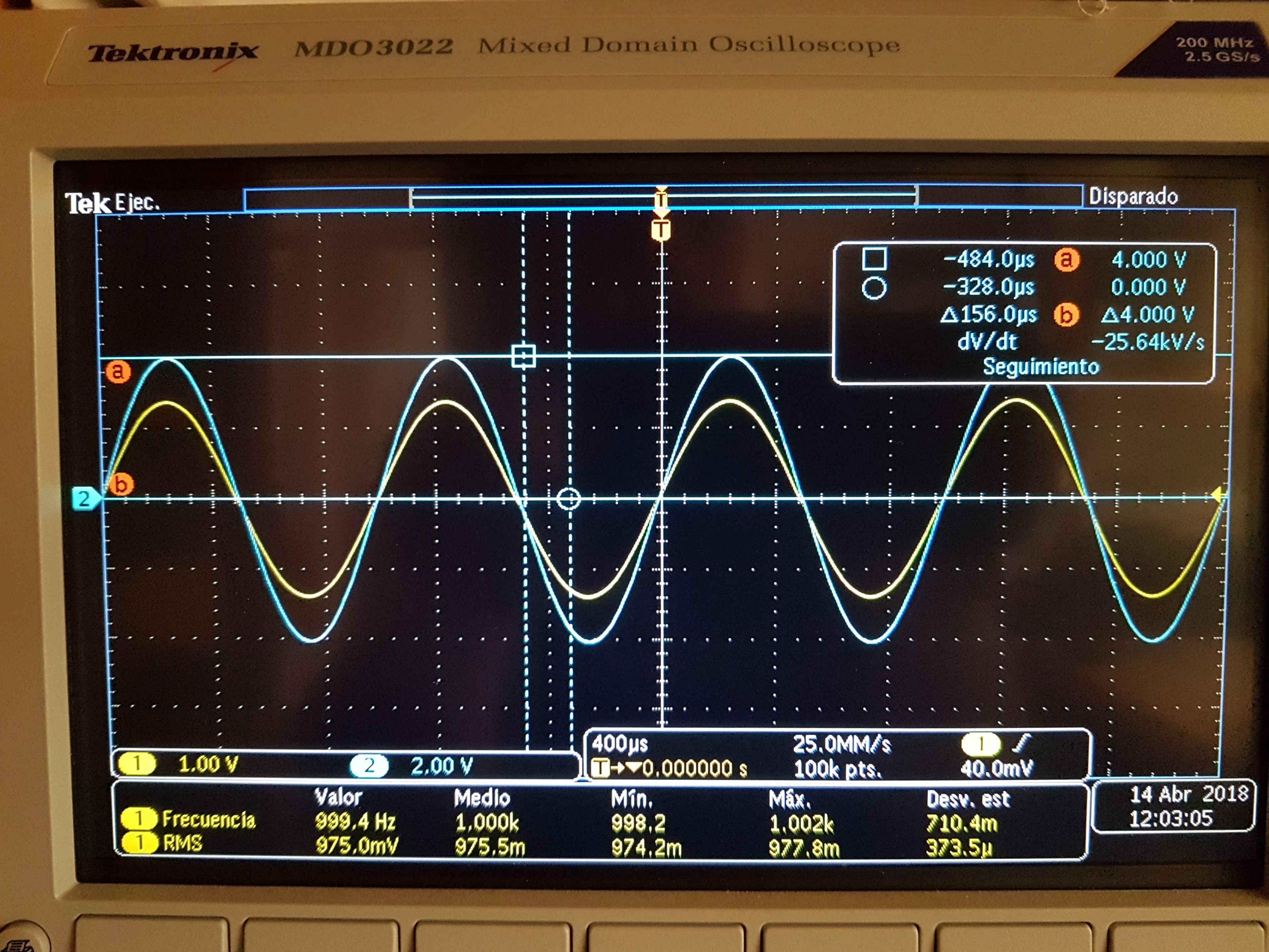

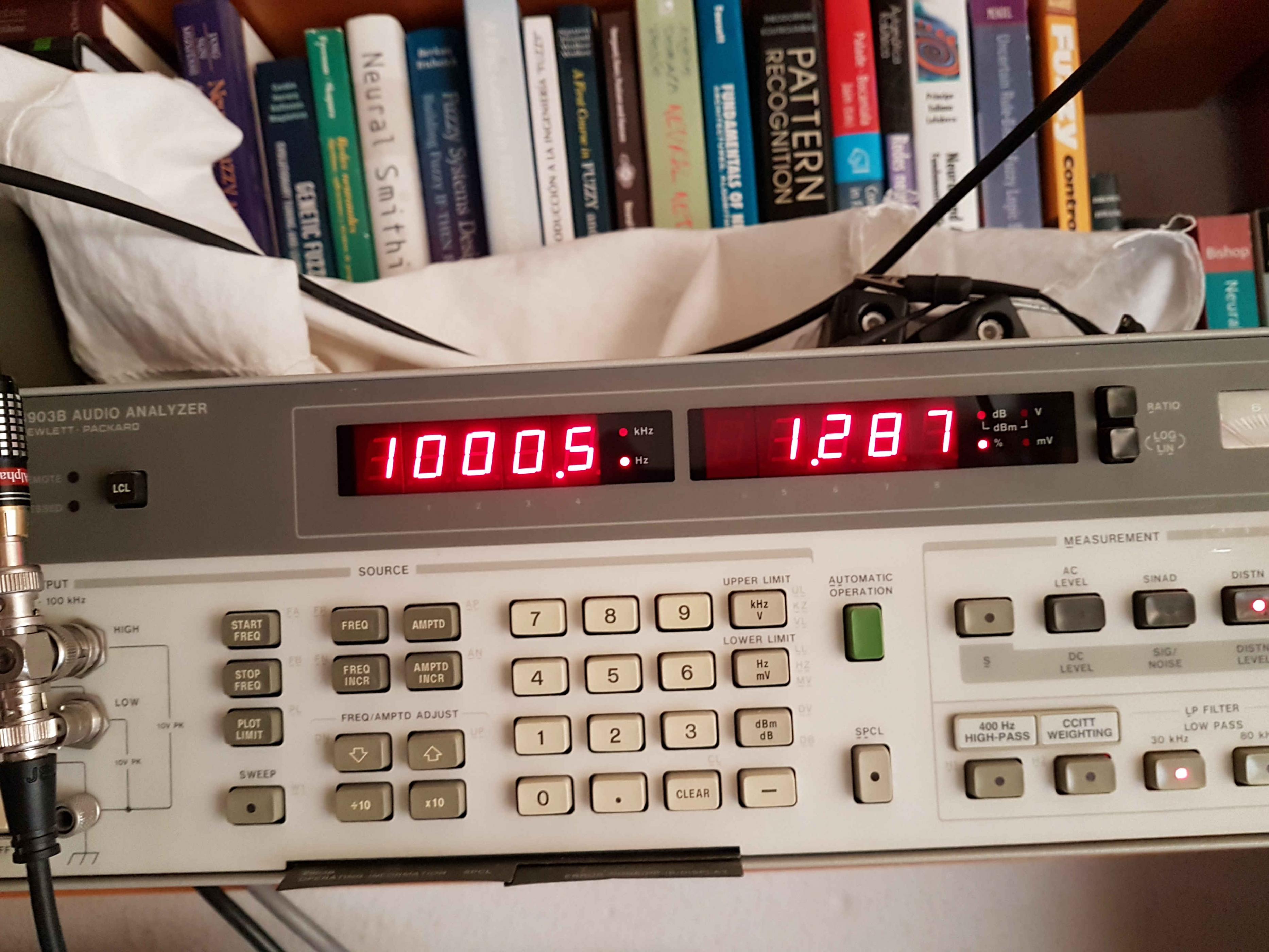

Well, using the ELROGs, I have measure the distortion pattern (1Khz, 1Wrms at 8 ohm). Really horrible.. But the sound is wonderful.
Can somebody explain me because this horrible distortion pattern sound so good????

Hi Jama,
I just saw this older thread regarding measurements on the TU8600. Looks worse than the TU8200?
see the measurements at
https://www.kenrockwell.com/audio/elekit/tu-8200.htm
I use the TU8200R as a headphone amp with my headphones having ~ 105dB/V sensitivity, running it less than 0.1 Watt region and it works great. ie very low distortion. When it's driving speakers it's only at polite levels ie 76dB average volume and speakers that have >>6Ohm over most freq and 86dB sensitivity. So for my speakers it's around 0.3W average.
Actually, what average power do you listen to the TU8600? maybe it's much less than 1W so the distortion could be a lot lower.

Hi Nick. Really liked the elekit. I owned both amps, 8200 and 8600. For me 8600 sound better. But to be honest, in this moment I sold both amps. With very complex music (like a symphony of Mahler) distortion is very obvious (as any SE) in some passages . So, I searched some amp that was better, and I found it.
Using old Quad ESL57 and modulus 86 of neurochrome I have not heard any distortion in the same music passages. Lows a lot better (in a electrostatic speaker) and all music is more clear and lifelike.
And, yes, when you down the power output I measure better distortion pattern.
