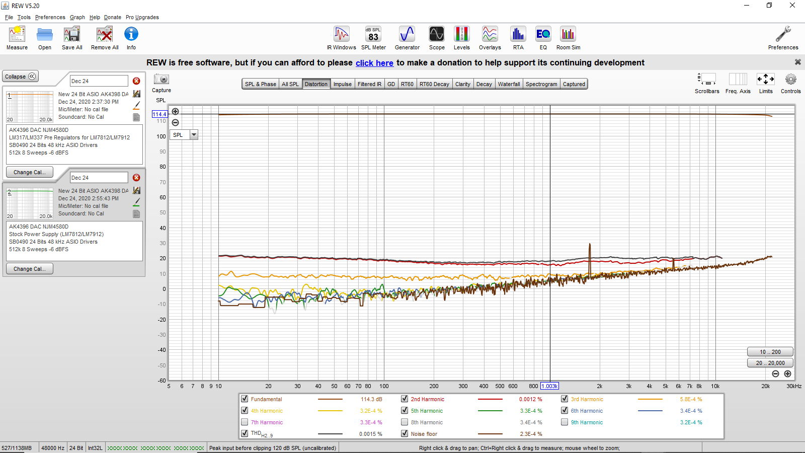

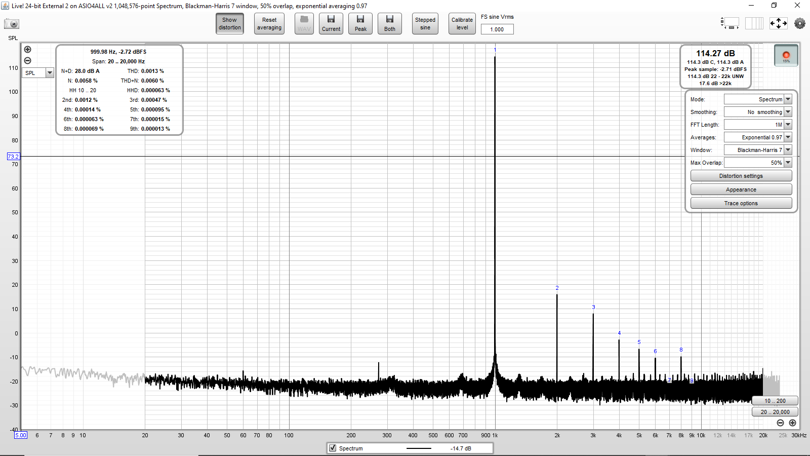

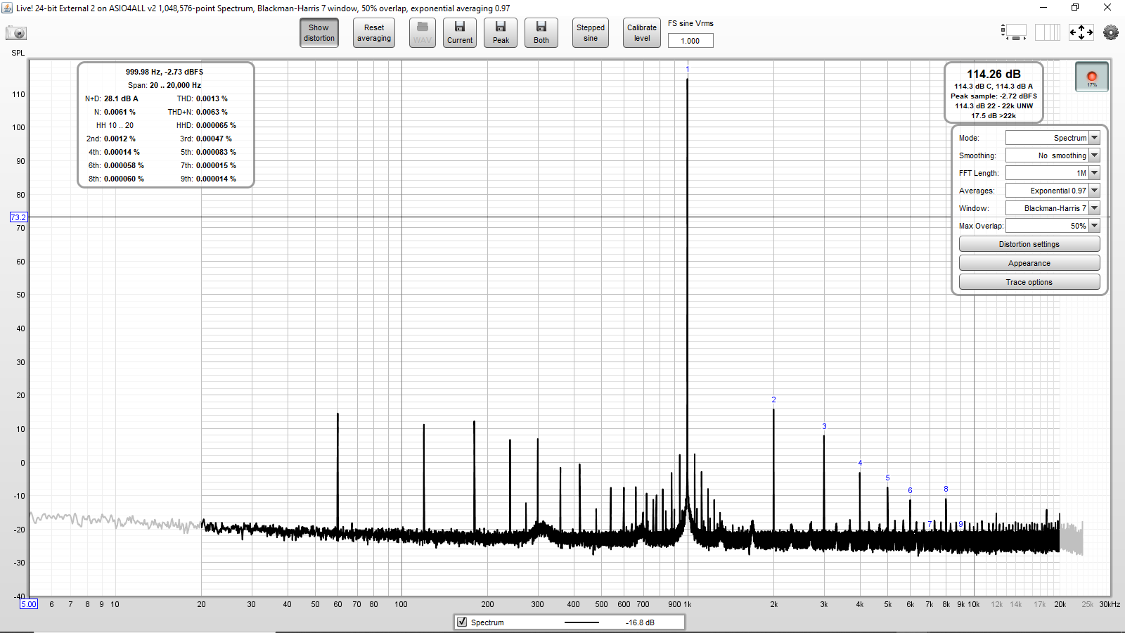

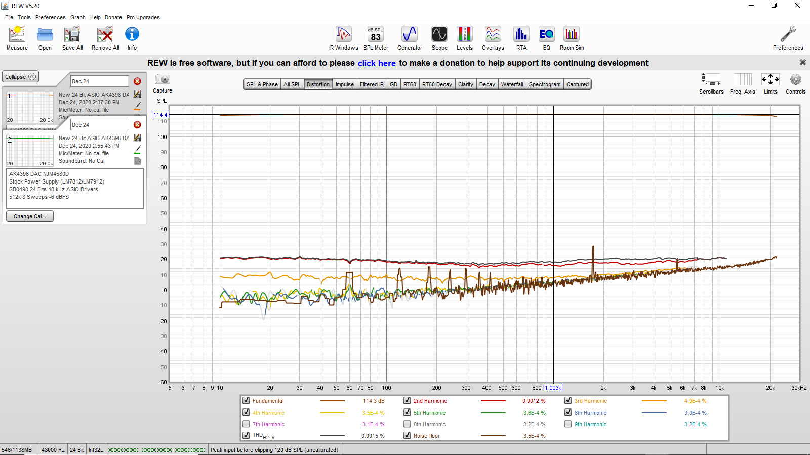

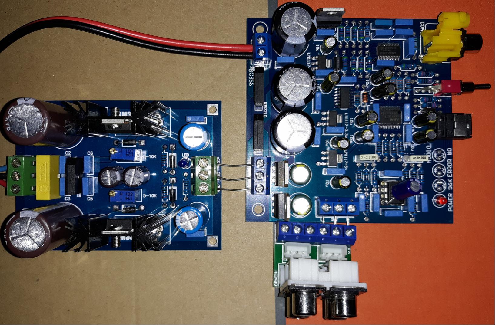

In case it helps someone else in a purchasing decision I have enclosed measurements of an affordable AK4396 DAC. (It was only $16 on AliExpress.)
The measurements were done with REW with the optical output of a USB SB0490 driving the AK4396 routed back to the Line 1/2 inputs of the SB0490. ASIO drivers were used (ASIO4ALL at 24 bits 48 kHz).
The distortion is at the limit of my SB0490 to measure. It is still worth measuring because it could help detect a major layout or power supply issue. I have measured other DAC boards and found quite bad performance due to layout, design, power supply, etc.
Two sets of measurements are enclosed. One set with the stock onboard power supply (LM7812/LM7912) for the analog section. The second set uses an external LM317/LM337 supply as a pre-regulator to feed the LM7812/LM7912. This eliminates the 60 Hz (and harmonics) seen with the stock configuration. The pictured LM317/LM337 kit only costs $5 from AliExpress (you solder it together) and it greatly reduces 60 Hz. (And no modifications to the DAC board.)
I think it is a very nice board especially since it costs only $16. I still might add 10 uF ceramics under the film supply bypass capacitors around the AK4396 and the output op amp. I am using an NJM4580D as the output op amp but I did not see very much difference in measurements with the stock NE5532P.
FYI: The spike near 2 kHz is something in my system that I can't seem to track down. That is not the DAC under measurement.

  • AK4396 1 kHz Spectrum SB0490 SPDIF Optical to AK4396 to Line In 12 24 Bits 48 kHz.png
  • AK4396 512k 8 Sweeps SB0490 SPDIF Optical to AK4396 to Line In 12 24 Bits 48 kHz.png
  • AK4396 1 kHz Spectrum SB0490 SPDIF Optical to AK4396 to Line In 12 24 Bits 48 kHz LM317 LM337 An.png
  • AK4396 512k 8 Sweeps SB0490 SPDIF Optical to AK4396 to Line In 12 24 Bits 48 kHz LM317 LM337 Ana.png

I plan to take a slightly different track since I would like to include measurements before and after my changes. And I would like to try a few different approaches such as pre-regulators and perhaps shunt regulators. Right now my idea is to not bring AC power onto the board but instead use pre-regulators in an aluminum project case and then twisted pair and aviation connectors between the power supply and the DAC board. Currently I am using just LM317/LM337 with a huge improvement in AC line related harmonics (as show in the first post spectrums). I think I might end up with a much simpler and cleaner looking modified board that way. Perhaps the external pre-regulated power supply and then 10uF ceramic bypasses under the board plus a few low ESR caps under the board.
