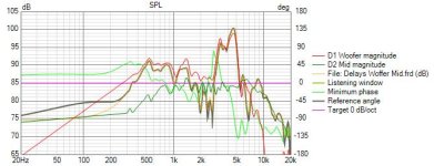

Woofer/Mid - Mid is -270uS which equates to 93mm this is not far from a geometric calculation using Pythagoras (88mm).

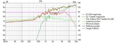

Mid/Tweeter - Tweeter is +20uS which equates to 6.9mm which again sounds about right for a dome mid and dome tweeter.

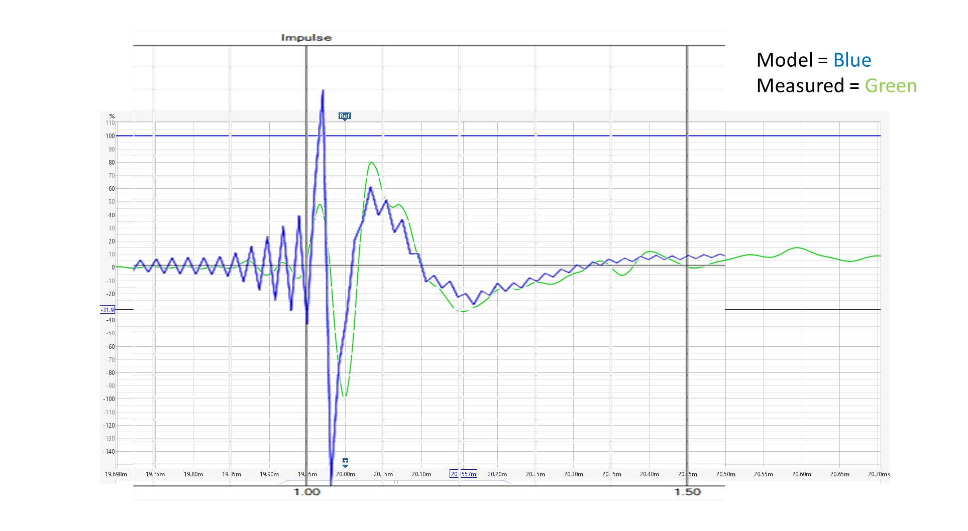

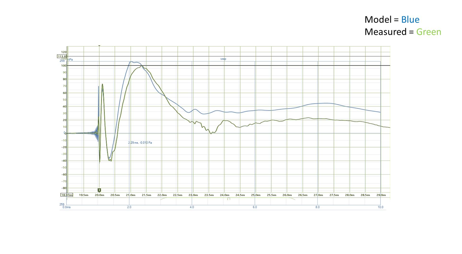

That said, I modeled up a crossover in VituixCad without adding the offset above, measured the combined speaker response (also with inverted mid to get nulls) and individual driver. The whole speaker model vs measured response matched very well and the step/impulse response also was pretty comparable. Which seems to suggest the data has the acoustic offset embedded in it and my method seems to be correct but something doesn't quite add up with respect to the acoustic offset.

- Woofer/Mid Offset at Mid= -270uS
- Mid/Tweeter Offset at Tweeter = +20uS

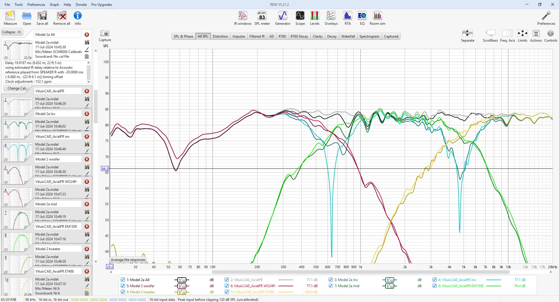

- VituixCad Model2a (my model designation)
- VituixCad Model2a vs Measured full speaker and individual driver responses (note the null at 60hz if from the chamber)
- Step Model2a vs Measured
- Impulse Model2a vs Measured
I'm not sure how Virtuix works, but usually I set the reference point to the driver whose axis I'm measuring on. Usually the tweeter. Everything else has an acoustic offset relative to that. So with Xsim for instance, my tweeters are always 0" delayed but my mid-woofers are often 1.25" or so or more, depending on the driver size and location. In a 3-way I'd expect the woofer to have the most offset.
Be sure to include the safety caps in your simulation for adjusting the offsets.
Using interferometry, that means I leave the tweeter distance alone, and then start to increaase the distance on the mid until the combined output is correct. Then you simulate the mid and woofer, leaving the mid alone and adding offset to the woofer.
In theory, the absolute numbers don't matter as much as the relative offsets from driver to driver.
Also, nothing wrong with designing a speaker on the mid axis instead if that is the driver that will be at ear level. Honestly I think there are some benefits to this approach as well. In this case your mid is 0" / 0uSec and your mic is placed on mid axis.
