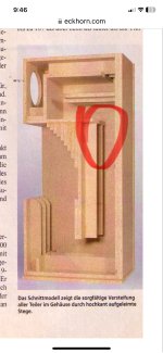

I understand that the Fostex enclosures are considered as suboptimal over here, yet following the measurements, I would be quite interested in building the BK208 box for a 8" horn-suitable Fostex driver. But, no space now!
I also like its looks and that it is quite doable to make with only straight angles to glue together.

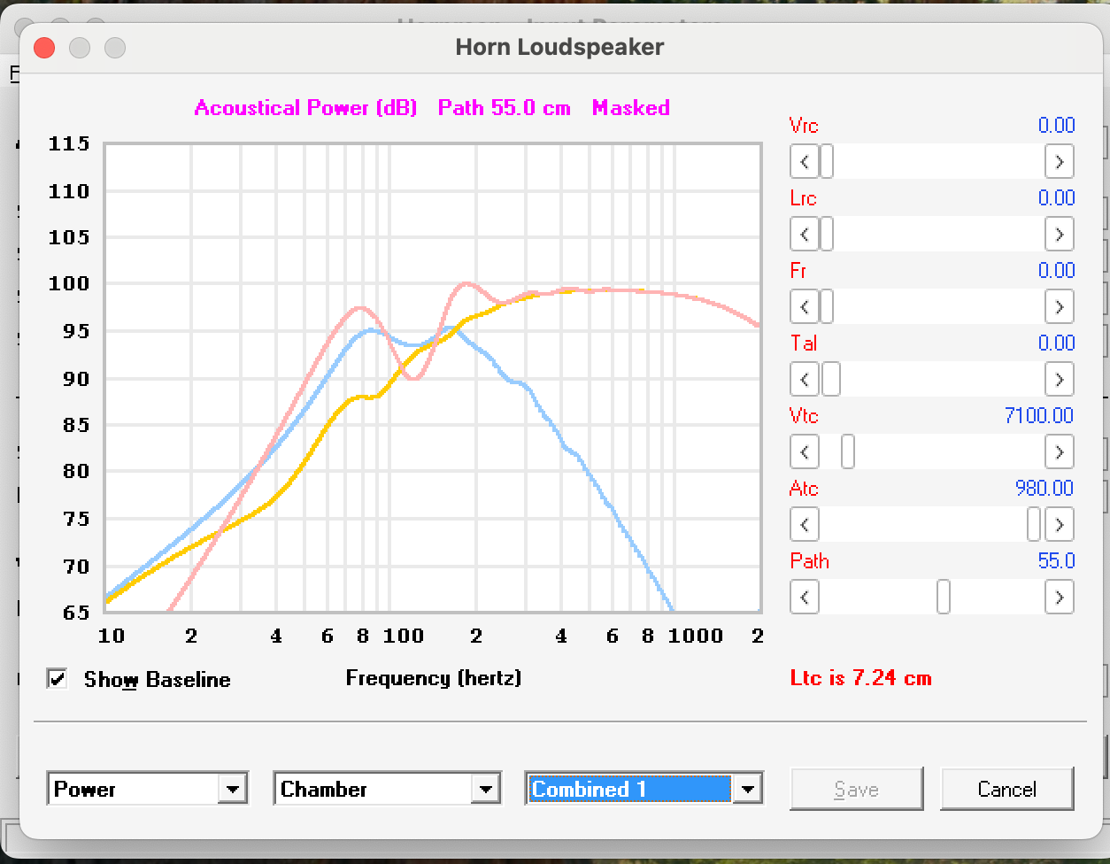

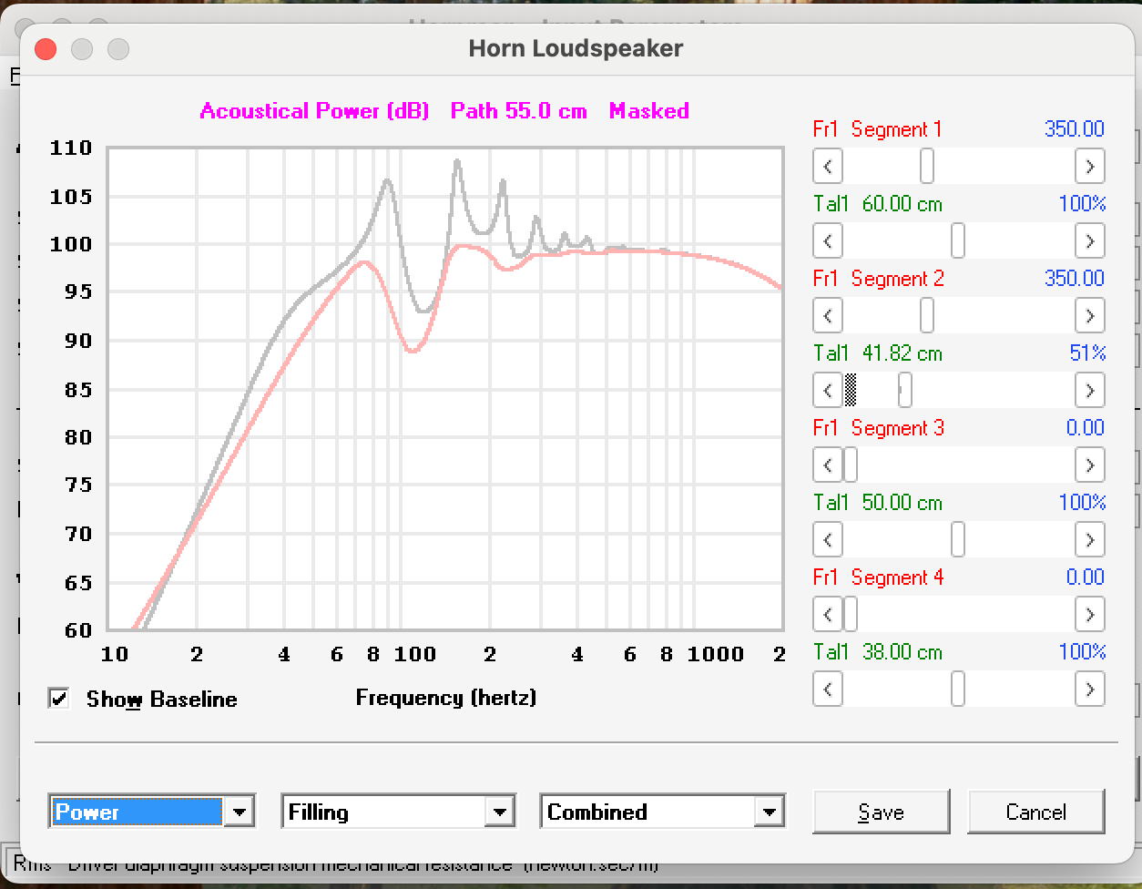

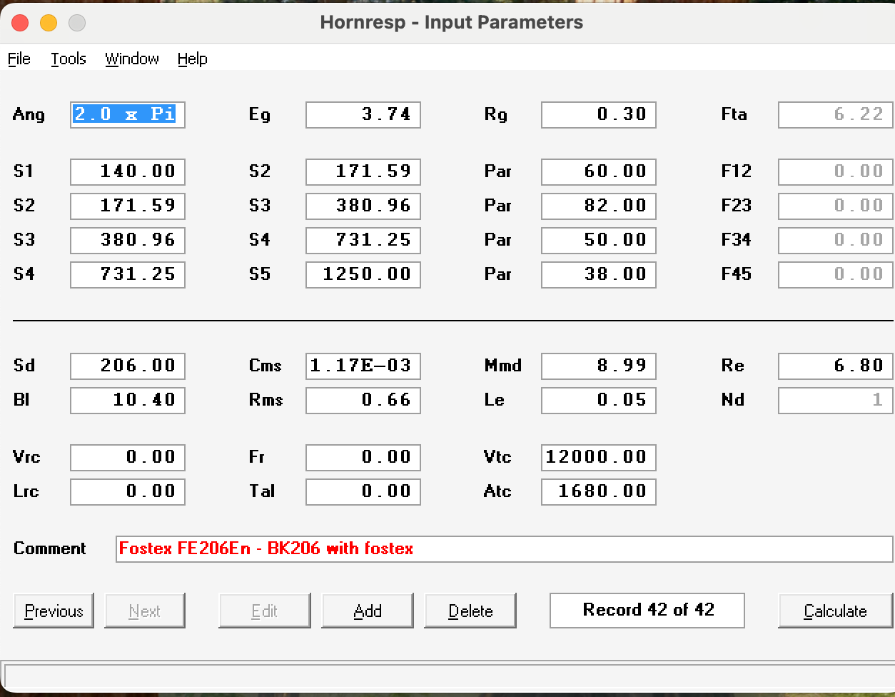

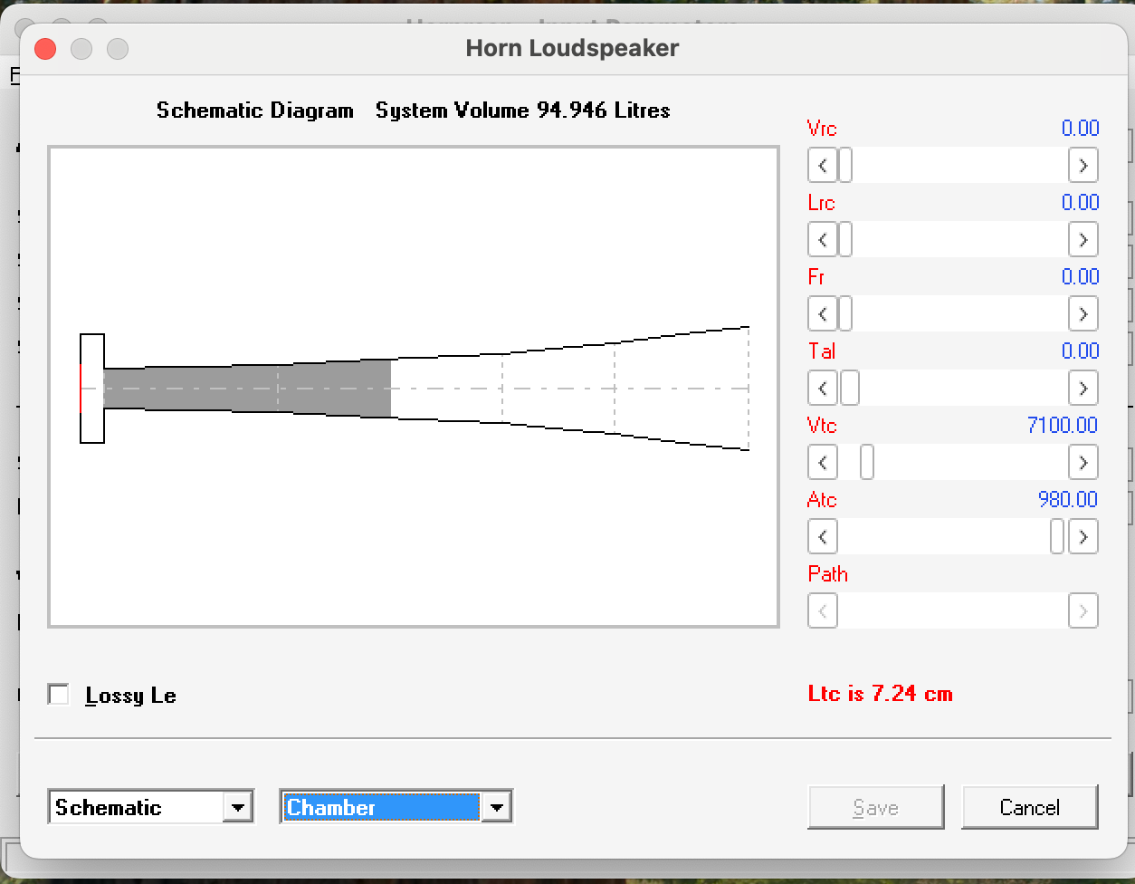

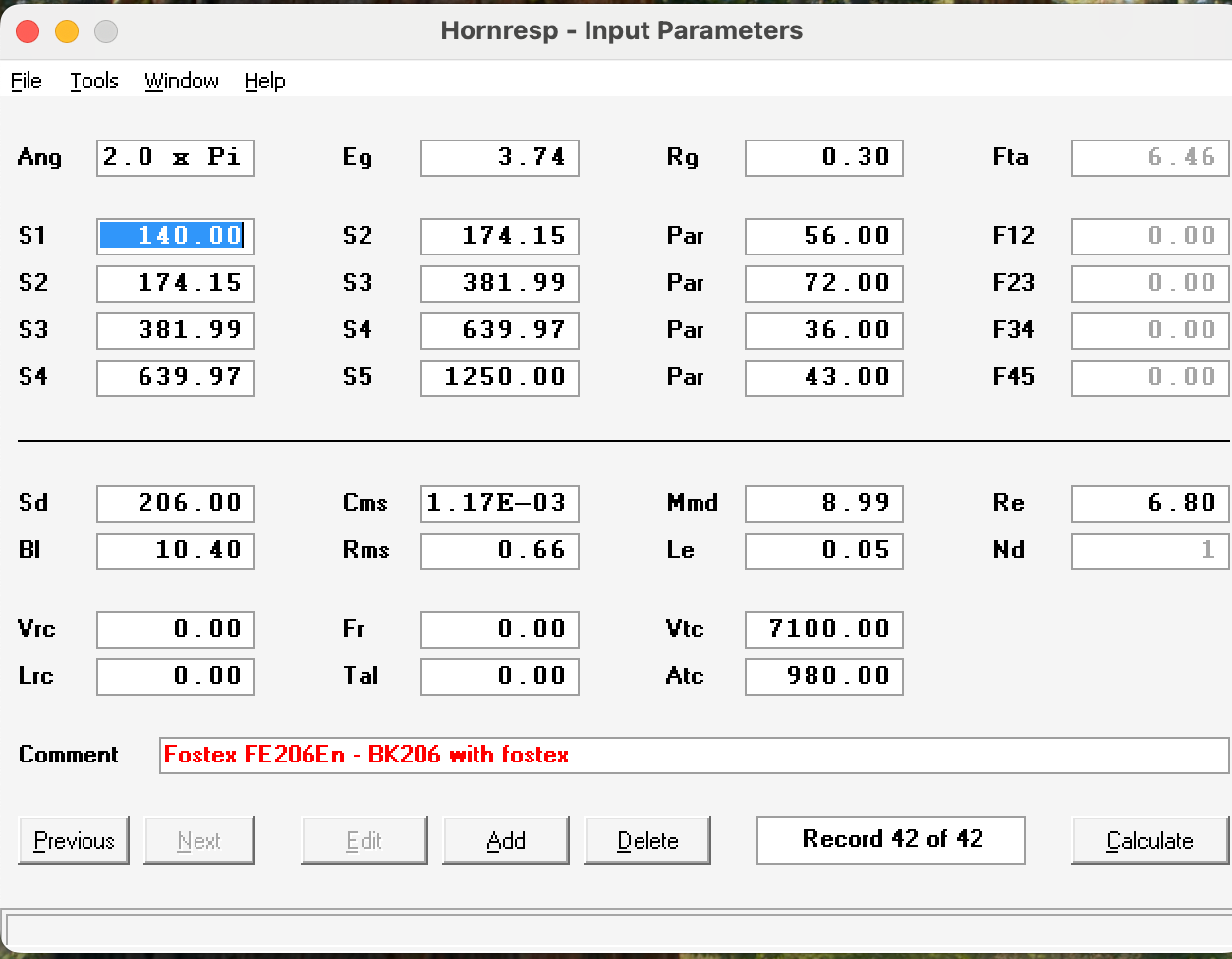

From the parts I could translate it looks like an interesting project. Instead of the discrete stepped expansion in the BK206 I played with the hypex approximation tool in Hornresp which allows 4 segments and tried to eyeball the box dimensions to fit. I think David demonstrated a way to have Hornresp allow an additional segment utilising the throat chamber as the first segment too which may get close to representing all the stepped elements better. The coupling chamber volume is obviously smaller if the drukkammervolumen of 12 litres is the actual volume used somehow. Screenshot 2025-02-08 at 2.25.29 pm.pngScreenshot 2025-02-08 at 2.26.41 pm.pngScreenshot 2025-02-08 at 3.00.05 pm.png
Your simulation is interesting - it shows the dip which was measured at 100hz but not the dip at 200hz.

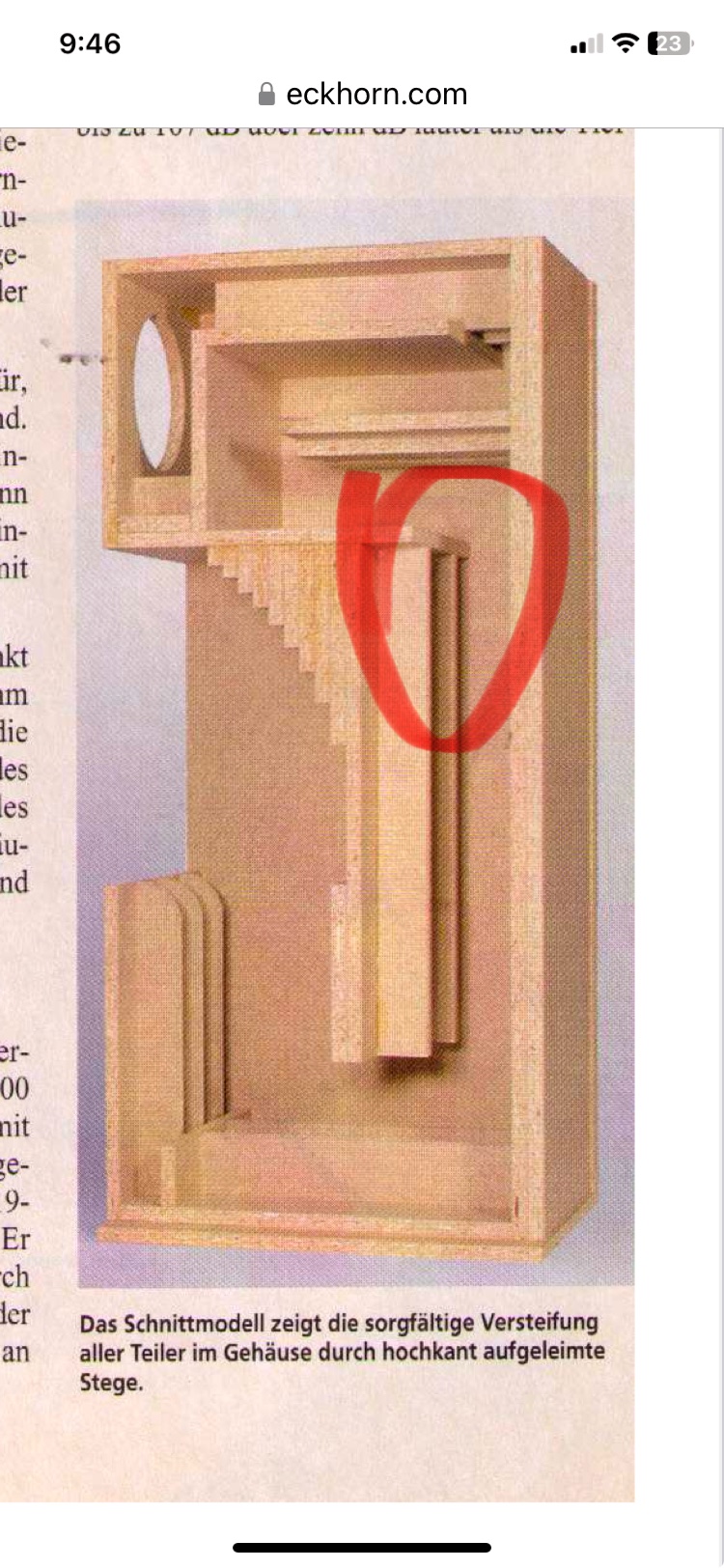

Because of these articles, I do think it is worth building BK208 instead for the FE206 driver family, it has a better, fuller bass rezponse. You can see the measurement on p8 of the BK206 PDF at the bottom left; and at the right you see its response overlaid on the BK206 enclosure. It doesn't have the dip at 100hz and reaches at bit lower as well. Together with a relatively doable construction, I find this now a highly interesting box for the FE206 variants family.

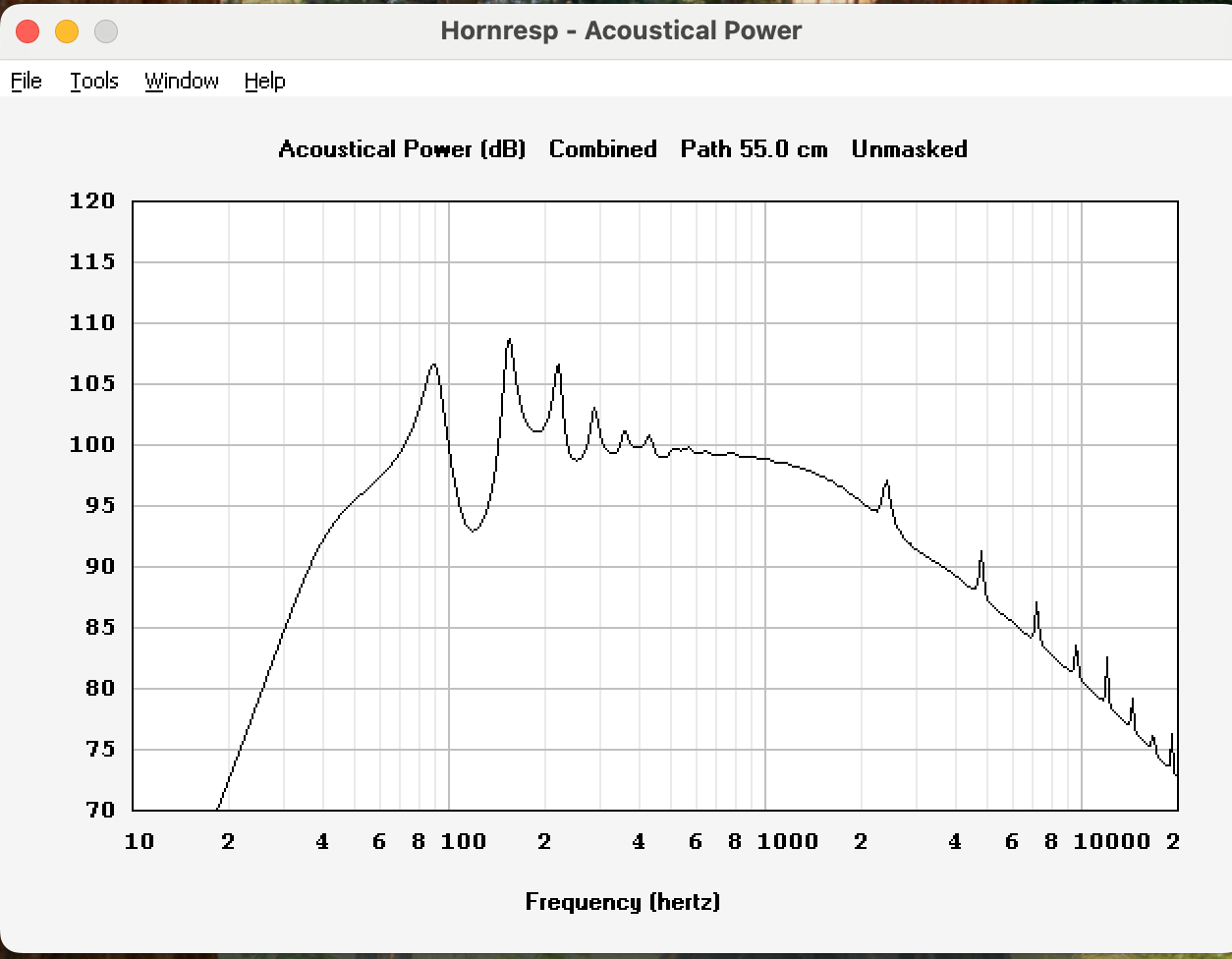

Someone who understands horn physics might know if that 100 hz dip is real when listening in the room. I think MJK discussed this in one of his papers. Still not a 200 hz evident. I had throat resonances masked and used the some filling which flattens some of the resonances. Compare to the unfilled box with resonances not masked. I see further in the document how they measure the coupling volume and horn length so I updated dimensions with this. The Path is set to 55cm too which may be a factor?
.Screenshot 2025-02-08 at 6.06.12 pm.pngScreenshot 2025-02-08 at 6.06.52 pm.pngScreenshot 2025-02-08 at 6.09.01 pm.png

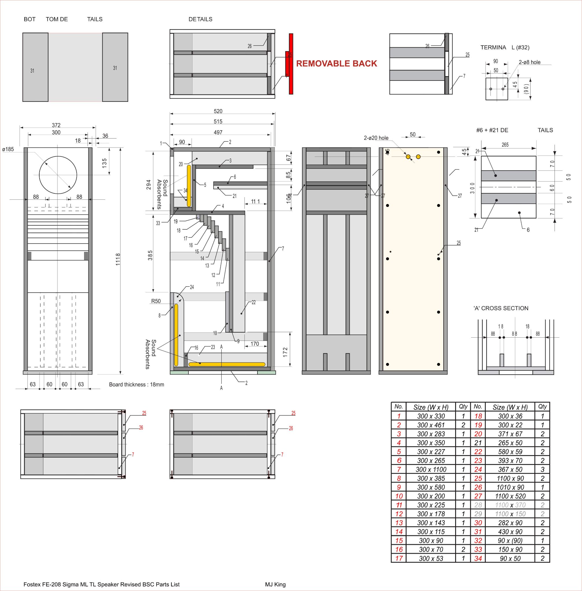

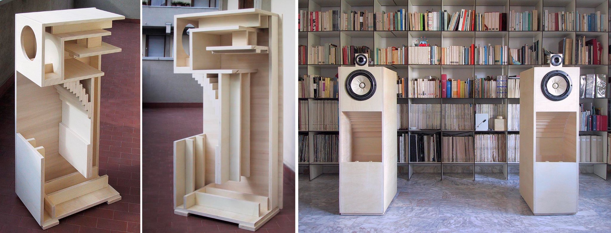

Several years ago I built the Fostex enclosures for the FE208 EZ, completely following its design except for the rear panel, now completely removable (see drawings)
In this way the damping of the various volumes can be set up and changed step by step to the desired tuning. The "Nagaoka" enclosure seems to behave more like a chain of Helmholtz resonators than an usual BLH.
Thanks to an expert friend the procedure was to first make a convincing equalization with my parametric Technics SA 9010, then simulating the results just due to the damping + diffraction prisms in the various volumes.
Note pls that the goal was to have convincing voices from the solo instruments and not an extension of the basses, so presently it sounds anything but a horn speaker.
It also incorporates the Fostex notch filter, but I don't use almost never it because it veils somehow the sound of a 300b SET (as did the equalizer, completely undetectable instead with SS amps)
This is a gorgeous realisation and indeed a good idea to keep the back removable.
Do you add damping behind the driver? It looks to me that a lot of the backwave would be reflected through the speaker cone.
I am also curious if those fostex deflectors made an audible difference?
Frankly I remember very little because the all the credit goes to my friend, I understand very little about speakers, and about much else.

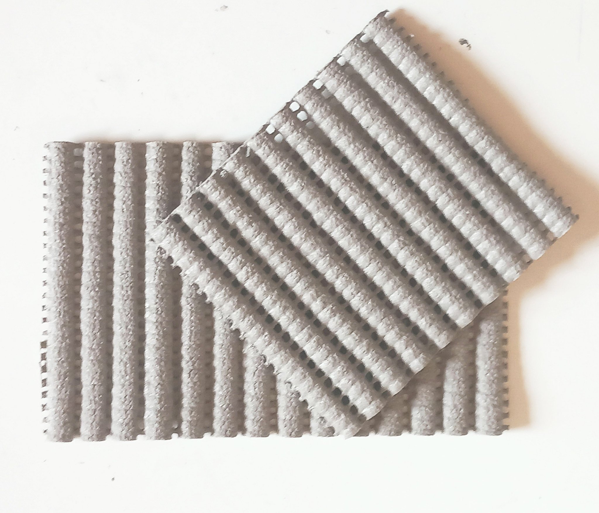

To begin with, the FE 208 is not a full range (fortunately it is without a whizzer cone but with a very light and rigid cone). So the T90 tweeter is usually recommended but I took the F17 mainly because it is cheap and has the same sensitivity; spending a lot of money on a hyper-efficient one and then strangling it with resistors did not seem too smart to me.
The damping treatment is implemented with different means, and differently from chamber to chamber; there is a sort of closed-cell foam tablecloth immediately behind the 208 and in the transition surfaces between the chambers (highs diffraction). Then there are layers of synthetic wool, open-cell polyurethane foam and closed-cell polythene wedges, especially in the final port. The three vertical ducts before the port are interrupted by very compact wool cylinders at different heights (agaist booming). The whole process took a lot of time and attempts, especially for the first and the final chamber.
Killing the mooing cow inside a BLH is not easy, as known. And it requires sacrifices; for me it was enough to hear a plausible flute, or human voice.
Not that easy.
carlo
Found just these notes. and a tablecloth photo

Sorry I didn't explain it clearly.
It's just a matter of taste, many would find absurd this kind of treatment because it sounds more like a closed box (but with an unheard dynamic and transparency, near to Sennheiser open headphones) than like usual horn speakers.
What I wanted to explain is that these boxes, with their 7 chambers, are much more flexible than normal BLHs, that should be taken as is, with their own character. Here, with patience, you can adapt the sound to your preferred kind of music and tastes without using active or passive electronic filters.
As I already said, the simple notch filter indicated by Fostex is enough to steal the magic of the Sigma speakers.
