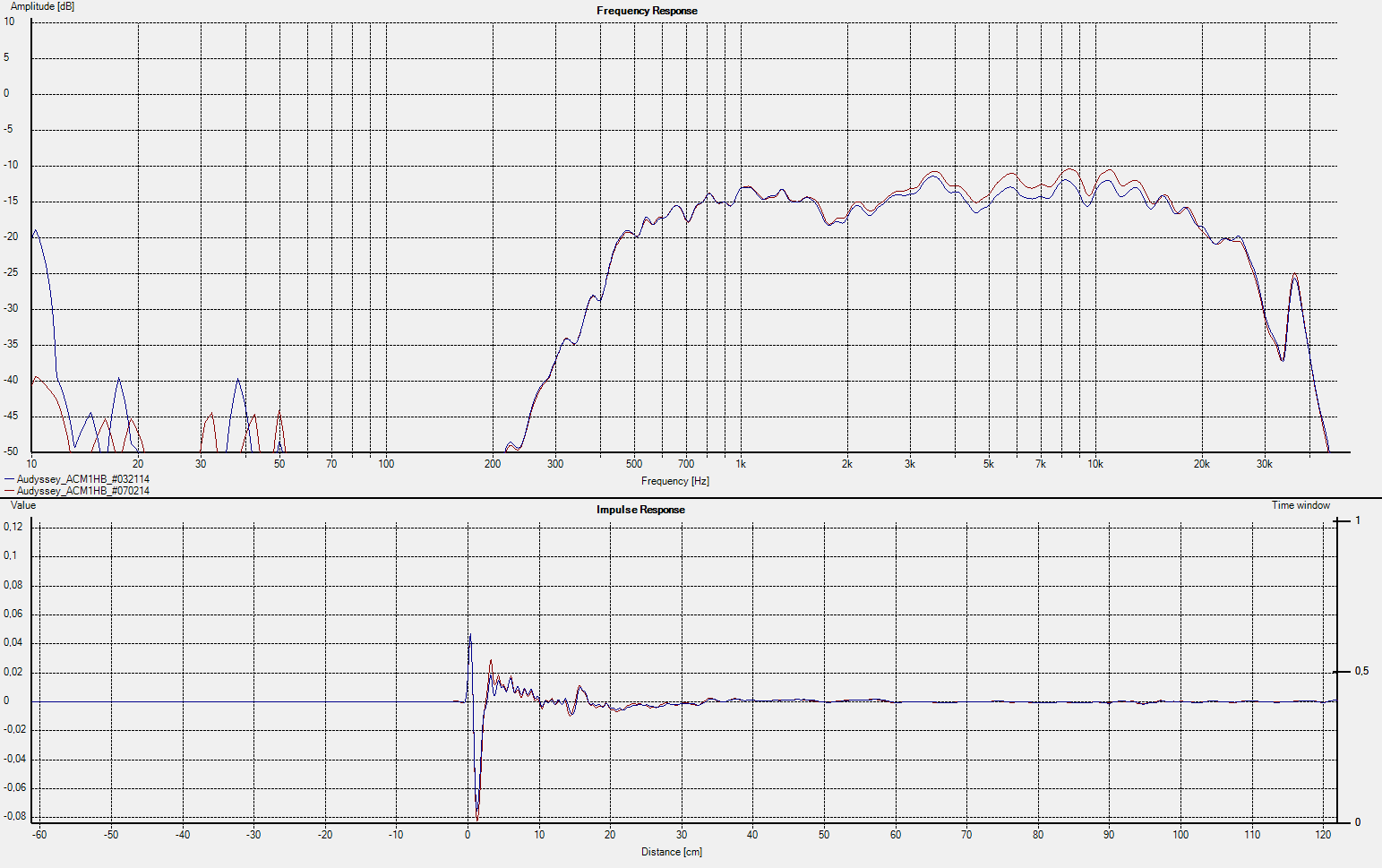

Difference between samples, mics in horizontal position:

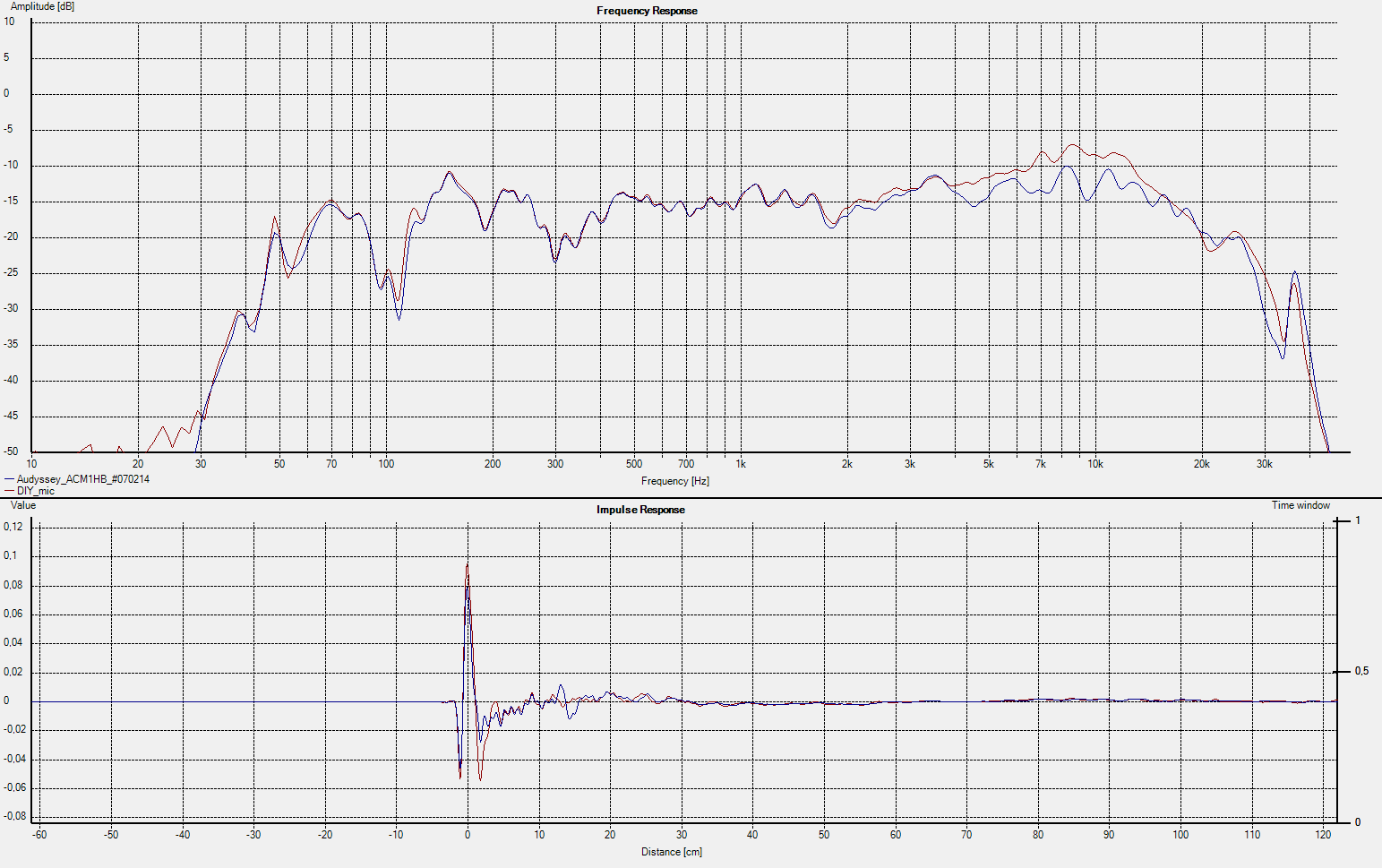

Difference between DIY mic and Audyssey mic, both in horizontal position:

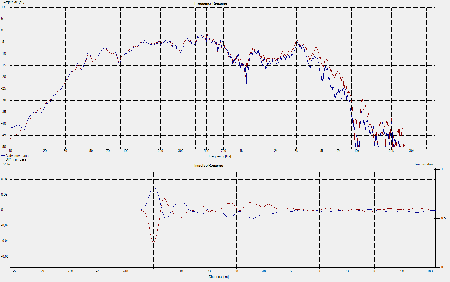

Difference in phase between Audyssey and DIY mic. Nearfield bass driver measurement. Note that bass drivers are connected with reversed polarity:

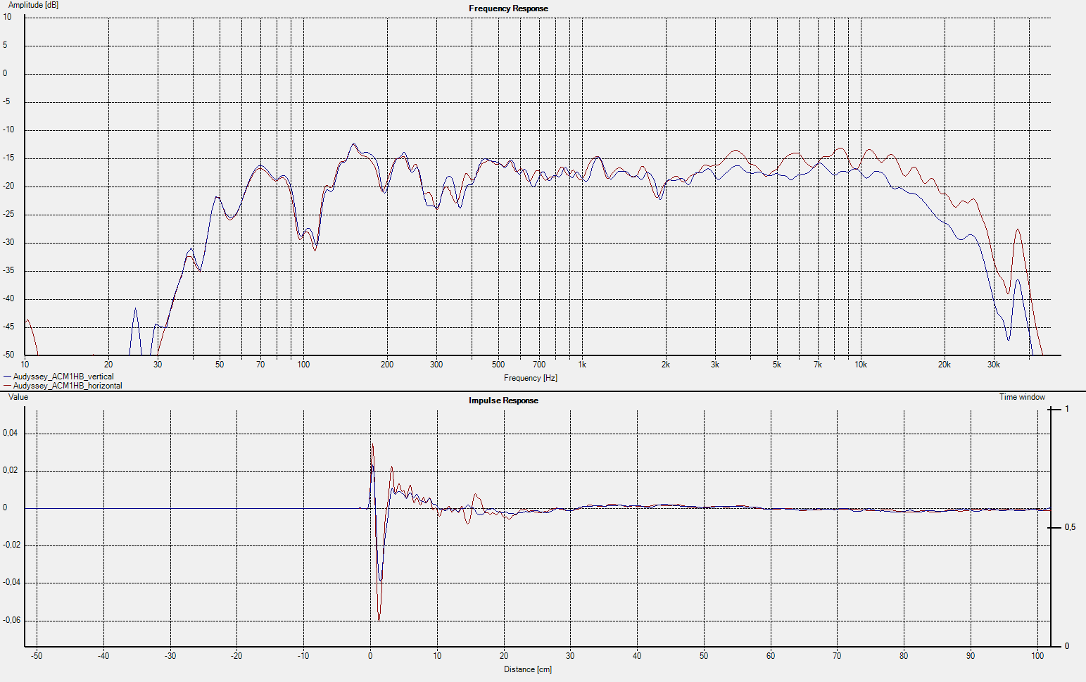

Difference of horizontal vs. vertical position:

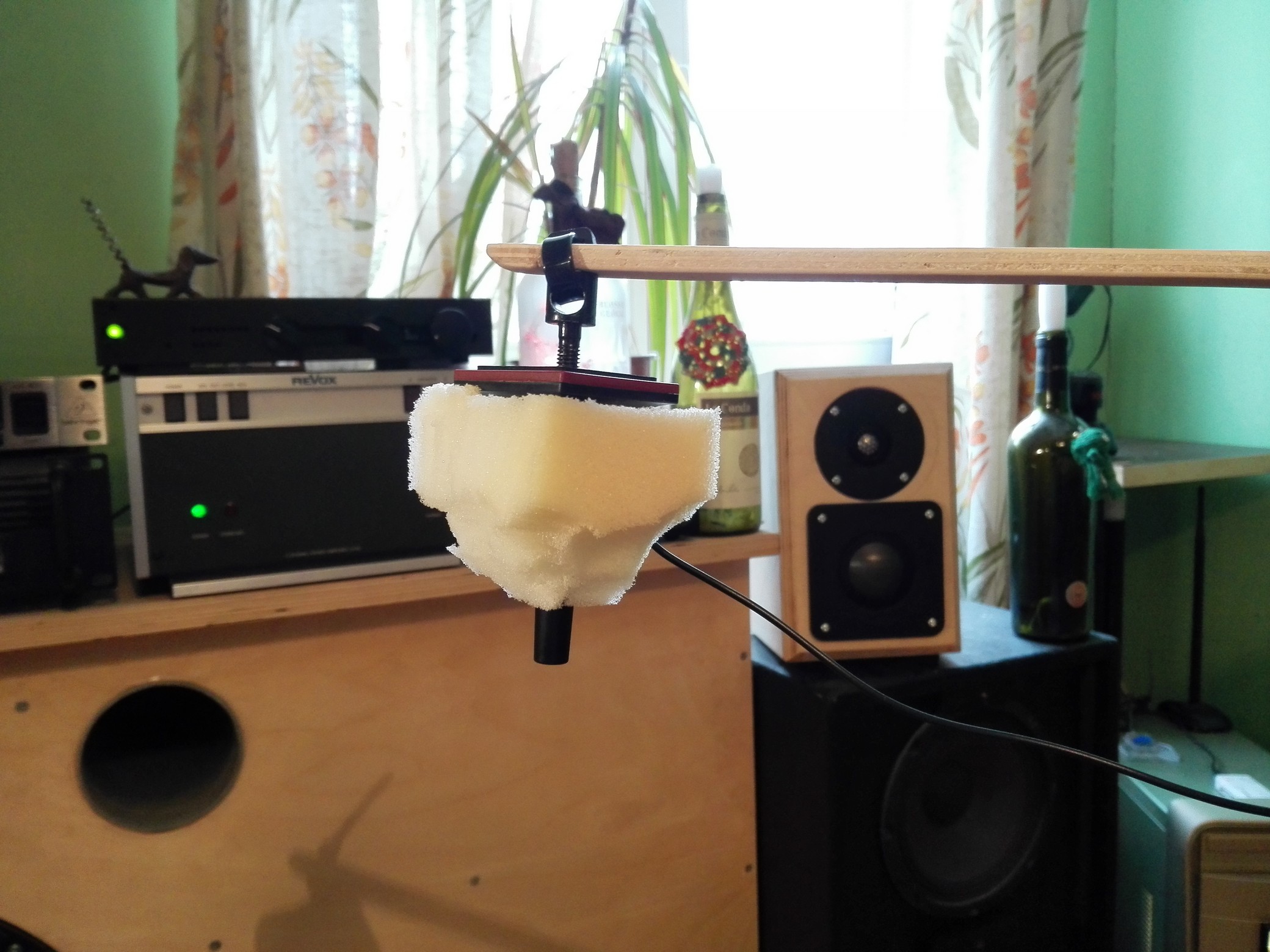

Difference between mic with foam block vs. without:

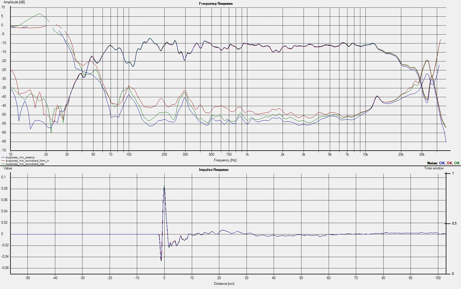

Differences between connection method: preamp; sound card front panel input; sound card rear panel input:

1. Audyssey mics seem to be within their specification of +/-2 dB of variation between samples. Response curve seems to be quite flat, except for roll-off above 10 kHz
2. They are designed to be used vertically and using them horizontally introduces frequency range aberrations due to reflection from the mic base, this can be seen in impulse response (path length difference approx. 140 mm, microphone length from capsule to base is approximately 70 mm). Using a foam block around the mic smooths response further.
3. They seem to invert polarity compared to my DIY mic.
4. They work well enough connected directly to a sound card, but performance is limited by sound card mic preamp.
