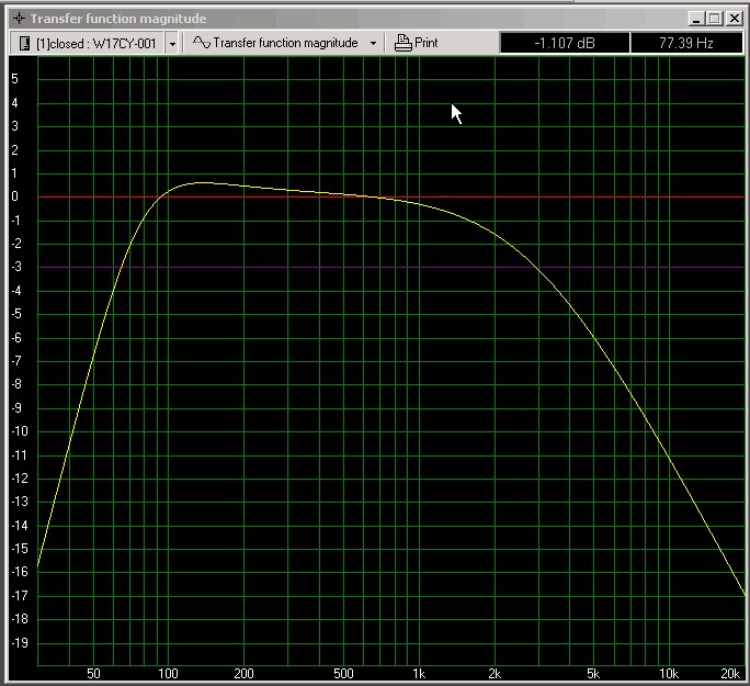

To this end, I will use the SEAS data-sheet frequency plots, and a box simulation made with WinISD.
The Box-volume is 12L, giving a calculated system Q of 0,85 and a Fsc of 75Hz.
The simulation does not take in to account any box-stuffing, so the actual result must be subject to verification through measurement.
The Q of 0,85 gives a slight LF rise, but barely above 0,5 dB, which should be acceptable. This might also be reduced by box stuffing, which could increase the "acoustic volume".

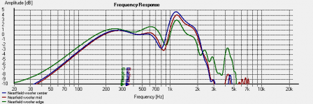

1:
The set up was easy, I just put the mic as close as I could to the woofer cone.
2:
I was curious if it would actually work, it seamed to good (easy) to be true.

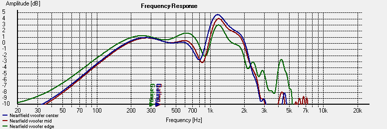

I placed the mic in 3 different positions:
1: As close as possible to centre (next to the phase-plug) (blue)
2: Midway between the phase-plug and the cone-edge (red)
3: Next to the cone edge (green)
The first plot shows the response from the three different positions with the gate function active.
Now, this doesn't quite resemble the original woofer data-sheet plot or the calculated box plot..
At this point I thought that nearfield measurement would not work after all, for no good reason I could identify..

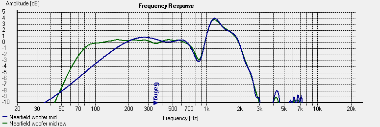

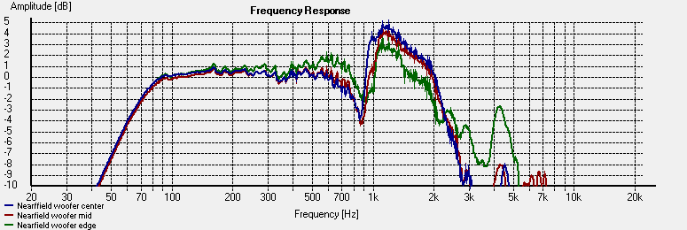

Then it struck me that switching the gating off could improve matters. After all, the purpose of near field measurements is to eliminate room and radiation effects through measuring the immediate pressure variations at the extreme proximity thus eliminating the need for gating in the first place.
The next plot represents the same near field measurements without gating.
Obviously, the response goes a bit haywire above 700 Hz, but that was expected, and according to theory that states that frequencies with wavelength equaling the cone radius (or above) can not be measured nearfield.
The variation in the different measurement positions doesn't seem to be that huge either..
Now the low frequency response seems to correlatew rather well with the calculated response plot!

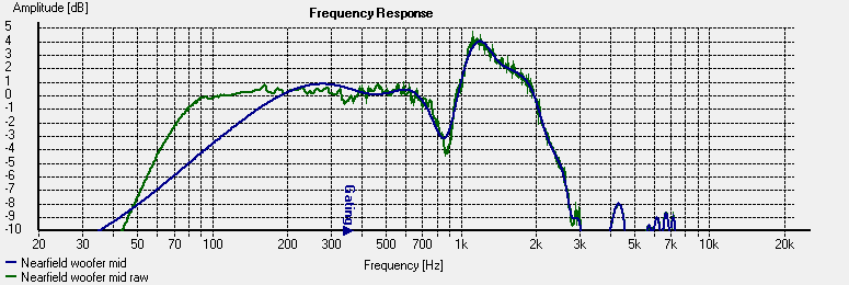

The next plot shows the gated and raw measurement superimposed.
The raw response curve is smooth enough to give a good impression, but I decided to apply a mild 1/5 octave smoothing, just enough to polish off the worst roughness, yet leave a curve detailed enough to reveal any issues.
To me, this response curve looks very nice, no nasty surprises here. If I have actually achieved a response inside +/- 0,5 dB from around 700 hz down to 80 Hz it is actually much better than I could dare hope for! 🙂
The only thing I notice is a small dip around 350 Hz, but considering width and magnitude, I would not think it significant.
Now, this is where I need to ask the following questions:
1:
At which frequency (upwards) does the measurement start to become unreliable? e.g. has the response started to rise or fall before the curve says so?
2: Are there any significant factors concealed by the nearfield measurement that I would have liked to reveal?
3: Did I miss something obvious??
If this measurement turns out to be valid, the next step will be to obtain a good far field measurement and splice it correctly with the near field measurement...
This is where I invite correctives and comments! 🙂

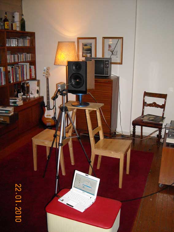

And finally, a picure of my measurement set-up, true DIY! 😀

Hi Elbert,
This looks reasonable for a rough LF curve although quite frankly the TS modeled curve will likely be more accurate than any LF curve you can measure. I've found that a decent outdoor nearfield comes very close to the predicted curve usually for a sealed box. Work on getting an accurate curve above 300 Hz because you can always model the LF curve with good result. Hopefully you have a little more room to measure-hard to tell from the pix exactly.
I agree with Dr. Geddes though, work on measuring the region above 300 and get some off axis curves. I think it will be difficult to optimally use the DXT with a Seas excel since the shallow waveguide doesn't go as low as you'd like from a directivity standpoint. I think you'll still end up with a dip and peak in the power response...
Hi Elbert,
Work on getting an accurate curve above 300 Hz because you can always model the LF curve with good result. .
Modeling the region of small importance (LFs) is easy, but getting the region of critical importance (HFs) is very tough. Don't get lost in all the LF mumbo jumbo. In the end its how the speaker, and the subs of course, work in the actual room that matters, not what the TS or nearfield looks like. Those things don't really matter at all.

With the set up and room I have available, I should have about 1m of free space in any direction.
In theory, that should allow me to measure down to 344 Hz.
Having said that, my improvised measurement stand will inevitably give some reflections, so it will be interresting to see what happens and what I can achieve through experimenting with mic-placement and software settings.
