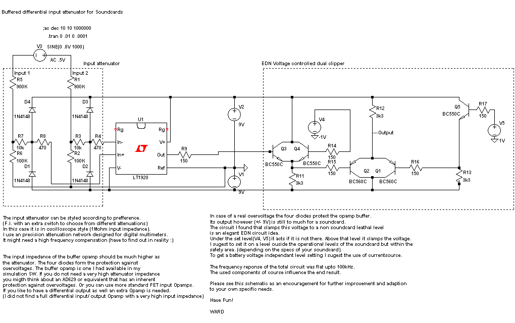

hi all,
i to am thinking about exactly the same thing, i found this on RMAA forum a while back, idea looks good. needs someone to put it into a practical form.
the part of the circuit 'voltage controled dual clipper' looks to be the basis of a great idea, needs refinment though particular the reference voltages.
this is on my to do list about No 347562
anyway hope this is of interest
Looks good. But would it work for very low THD measurements?
And could it be made simpler with respect to V4 and V5 references? My impression is that for something like this to gain interest, it would have to be virtually transparent (IE unmeasurable or extremely low THD), and it would also have to be simple (that LT1920 might scare someone away).

nice, except almost all the resistor values shown is going to require high frequency compensation caps. i used a similar device with a dummy load to go into an oscope, and without compensation, flat top peaks were distorted by the flat tops being angled (at a 45 degree angle).
but that's pretty much what i had in mind as far as the zeners. all you really need for amplifiers is a x100, x50, x20 and x10, and maybe x5 and x2. anything beyond that isn't really neccesary because for most amplifiers you won't see signals beyond +/-100V. just keep in mind that a divider using a 100 ohm resistor as the base of the string is only going to be for use with dummy loads (because with dummy loads you can get away with having a low impedance voltage divider). for other uses such as using the sound card as general purpose oscope or spectrum analyzer, you will want to use a much higher resistance string such as the one in the pic above. with something like that you will find you need compensation caps. i usually use 30, 50 or 100pf trimmers. adjust the compensation by inputting a square wave of the appropriate voltage into the attenuator and adjusting the trimmer for flat tops on the waveform. the compensation caps should only have to be set once unless you change cables between the attenuator and sound card.
