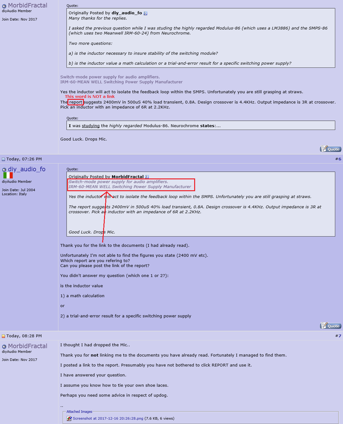

Yes the inductor will act to isolate the feedback loop within the SMPS. Unfortunately you are still grasping at straws.
The report suggests 2400mV in 500uS 40% load transient, 0.8A. Design crossover is 4.4KHz. Output impedance is 3R at crossover. Pick an inductor with an impedance of 6R at 2.2KHz.

Unfortunately I'm not able to find the figures you state (2400 mV etc).
Which report are you refering to?
Can you please post the link of the report?
You didn't answer my question (which one 1 or 2?):

Thank you for not linking me to the documents you have already read. Fortunately I managed to find them.
I posted a link to the report. Presumably you have not bothered to click REPORT and use it.
I have answered your question.
I assume you know how to tie your own shoe laces.

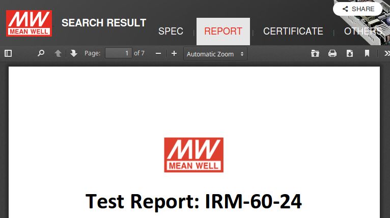

thank you for your kind reply and your patience.
1) I had already read the documents at the link YOU sent me and NOW I repeat below
Switch-mode power supply for audio amplifiers.
IRM-60-MEAN WELL Switching Power Supply Manufacturer
2) I have NOT "bothered to click REPORT and use it" because the word "report" (in your post # 5) is not a link (at the best of my knowledge)
3) Attached to this post you can find the PDF downloaded from the link (you posted)
IRM-60-MEAN WELL Switching Power Supply Manufacturer. I cannot find any "REPORT"
Please check the image below to verify my statements 1) 2) & 3).
Until I can read the report I cannot make sense about:
"The report suggests 2400mV in 500uS 40% load transient, 0.8A. Design crossover is 4.4KHz. Output impedance is 3R at crossover. Pick an inductor with an impedance of 6R at 2.2KHz."
What about report?
Best regards

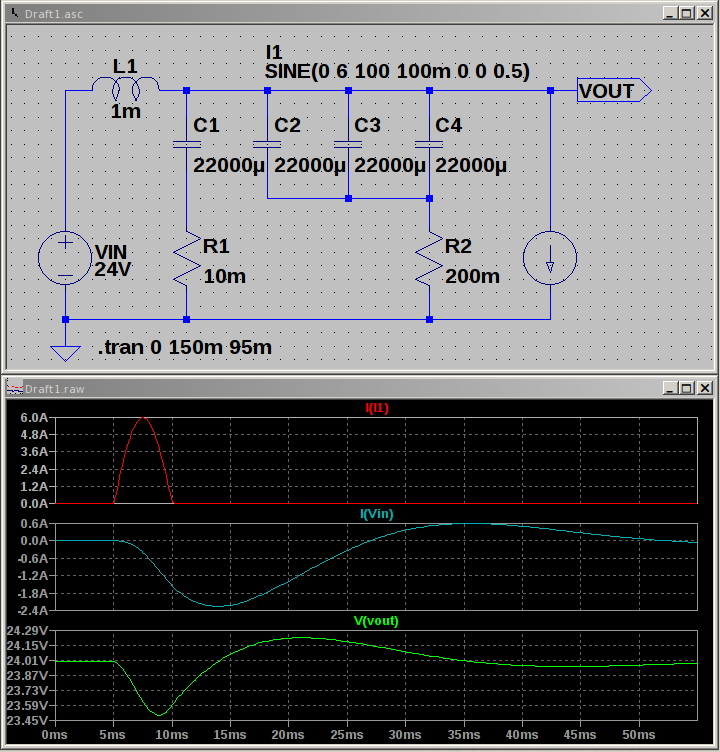

If I understand correctly the OP wants to filter the output of a supply capable of 2.5A continuous such that burst currents, above about 6A, will not trigger the supply's current limiting. They want to do this with additional filtering without rendering the supply unstable.
It strikes me that we are down in the realms of achieving PMPO^5 performance. I do not doubt that the additional filtering will reduce noise and might improve sound but why not just use a power supply that is rated to cope with the amplifier's requirements.
Anyway. I did roll some, valid, sums but ended up at the doorstep of despair. It's just chasing someone else's meaningless but 'highly regarded' dream.
Whilst the sums, I am not going to reproduce them here, are approximate the values that result when inserted in the model appear to be close. Unfortunately the values are... huge and that's all you get for a half cycle 100Hz 6A demand. Yes the power supply is below current limit but I really see no actual point to the exercise.

Code:
Version 4
SHEET 1 1016 680
WIRE 112 128 80 128
WIRE 224 128 192 128
WIRE 320 128 224 128
WIRE 416 128 320 128
WIRE 512 128 416 128
WIRE 656 128 512 128
WIRE 688 128 656 128
WIRE 224 160 224 128
WIRE 320 160 320 128
WIRE 416 160 416 128
WIRE 512 160 512 128
WIRE 320 256 320 224
WIRE 416 256 416 224
WIRE 416 256 320 256
WIRE 512 256 512 224
WIRE 512 256 416 256
WIRE 80 288 80 128
WIRE 224 288 224 224
WIRE 512 288 512 256
WIRE 656 288 656 128
WIRE 80 400 80 368
WIRE 224 400 224 368
WIRE 224 400 80 400
WIRE 512 400 512 368
WIRE 512 400 224 400
WIRE 656 400 656 368
WIRE 656 400 512 400
WIRE 80 432 80 400
FLAG 80 432 0
FLAG 688 128 VOUT
IOPIN 688 128 Out
SYMBOL ind 96 144 R270
WINDOW 0 32 56 VTop 2
WINDOW 3 5 56 VBottom 2
SYMATTR InstName L1
SYMATTR Value 1m
SYMBOL cap 208 160 R0
SYMATTR InstName C1
SYMATTR Value 22000µ
SYMBOL cap 304 160 R0
SYMATTR InstName C2
SYMBOL cap 400 160 R0
SYMATTR InstName C3
SYMBOL cap 496 160 R0
SYMATTR InstName C4
SYMBOL res 208 272 R0
SYMATTR InstName R1
SYMATTR Value 10m
SYMBOL res 496 272 R0
SYMATTR InstName R2
SYMATTR Value 200m
SYMBOL voltage 80 272 R0
WINDOW 0 36 47 Left 2
WINDOW 3 35 67 Left 2
SYMATTR InstName VIN
SYMATTR Value 24V
SYMBOL current 656 288 R0
WINDOW 0 -280 -206 Left 2
WINDOW 3 -283 -186 Left 2
WINDOW 123 0 0 Left 2
WINDOW 39 0 0 Left 2
SYMATTR InstName I1
SYMATTR Value SINE(0 6 100 100m 0 0 0.5)
TEXT 120 432 Left 2 !.tran 0 150m 95m

When I read the following page
I saw only the content of the page and NOT the frame (around the content) with the tab "REPORT"
Now back to the technical stuff
You write:
"The report suggests 2400mV in 500uS 40% load transient, 0.8A. Design crossover is 4.4KHz. Output impedance is 3R at crossover. Pick an inductor with an impedance of 6R at 2.2KHz"
In the report I find the following figures:
"TRANSIENT RECOVERY TIME
V1:2400 mVp <500us
I/P:230 VAC O/P:40% LOAD CHANGE
Now I can obtain:
Out Imp = 2400 mV / 0.8 A = 3 R
I (politely) ask:
Where 0.8 A come from? (40% of 2.5 A (max out current) is 1 A)
and Design crossover frequency 4.4 KHz?
I assume that for 6R and 2.2 KHz you considered a X2 "safety factor"
You nailed the point 🙂If I understand correctly the OP wants to filter the output of a supply capable of 2.5A continuous such that burst currents, above about 6A, will not trigger the supply's current limiting. They want to do this with additional filtering without rendering the supply unstable
My application is not an audio amp but your understanding is perfect!
I proposed the Modulus-86/Meanwell-SMPS just as an example.
Thanks a lot for your valuable simulation.
Thank for rising interesting points.
I think so if:
- peaks are "narrow" enogh
- added (output) capacitor are "large" enough
Although my application is not an audio amp I proposed the Modulus-86/Meanwell-SMPS just as an example.

Second, NeuroChrome indicates that the Modulus-86 should be used with the "recommended transformer." Have you checked the rating of NeuroChrome's "recommended transformer" to get a sense of the VA they expect for a power supply for the Modulus-86? It would appear to me that the reference to a "transformer" for their preferred power supply suggests that NeuroChrome expects the Modulus-86 to be powered by a linear power supply, notwithstanding that it is a switching amplifier.
"Who [cut] have low-efficiency 4 Ω speakers, should consider building the SMPS-86 + Modulus-86 as mono blocks"

Where 0.8 A come from? (40% of 2.5 A (max out current) is 1 A) and Design crossover frequency 4.4 KHz?

The loop will be first order at crossover. In effect an LR or RC section. Recovery is specified to a percentage of the excursion either based on 2.2RC or 5RC. Crossover becomes.
2.2/500u = 4400Hz
or
5.0/500u = 10000Hz
The Mean Well example you are using is a flyback converter. Elsewhere, and I am not going to try and find it again, its switching frequency is specified as being 67KHz. It will operate with continuous transformer current and therefore suffer from a Right Half Plane Zero, RHPZ, which will vary with load current.
It is possible to determine where that RHPZ will be but wet rule of thumb is that the loop is closed at 1/10th of the switching frequency in order to avoid it. 6.7KHz but you also have to allow for component tolerances. That's why I chose 2.2 as opposed to 5.
The loop will use Pole-Zero compensation. A DC pole with, ideally, the zero placed at half of the crossover frequency of 4400Hz or 2200Hz. That's where the 'safety factor' comes from.
Otherwise the choice is somewhat arbitrary. You can see that in my model I used 1mH in order to chase a solution without having to use Farad sized capacitors.
