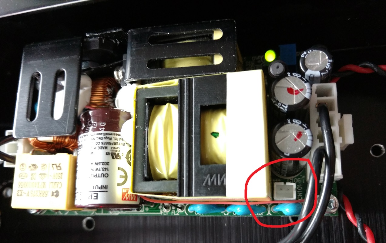

I'm using a Meanwell EPP-200-27 SMPS to power a TPA3251 based amplifier, see here for pics. As shown in the pictures, I was not using the auxiliary output, only the main 27V output for the amp. Today I connected a LED (with a current-limiting 2k resistor in series) to that aux power.
With the LED connected, there is a noticeable hiss/whine coming from the power supply. If I remove the LED, the hiss/whine diminishes considerably. It's still there, but quiet enough that it can only be heard with the cover off the case and standing right by the amp. But with that LED plugged in, the noise is hard to ignore, even with the case lid on and standing far away from the amp.
Is this a "feature" of the power supply, or have I made a mistake in implementation somewhere? Any way to reduce the noise? I can power the LED with the main 27V supply, but that auxiliary supply is lower voltage and just seemed more appropriate for a power-on indicator light.

Technically it's the "fan supply", see the datasheet. 12v/0.5a +/-15%. (See the "function" line in the middle of the table on the first page of the DS; also connector CN101 on the last page of the DS.)
Edit: See attached pic, I circled the fan supply in red (nothing plugged into it in this picture).

A Meanwell engineer got back to me on this, and confirmed what many of you are saying: it simply hisses at very low loads. Here is what the engineer wrote to me:
Thanks everyone for your help and feedback.
I have done some test about it. Once there is a 0.3A load, then I can only hear the noise when I’m really close to the power supply. When the loading is above 0.7A, I’m not able to hear the noise any more. Therefore, I would recommend to add a 40 ohm/ 20W power resistor or just use two smaller power supplies instead.
