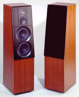

I'm trying to help a friend of mine with a pair of Meadowlark Blue Heron speakers that are sickly. The pair he has uses the Audx gas piezo tweeters. One of the midrange drivers isn't working. When I tried popping the midrange off of the front baffle after removing the bolts the driver wouldn't budge. What sort of adhesive did Meadowlark use to seal the driver to the box. I didn't want to pry given the superb finish on the baffle board for fear of scuffing things. How do you get the mid driver off without marring the finish? Anyone know what driver was used for the midrange? It has a clear cone material.
Another concern involves the voicing of the speakers. The speaker with all drivers functioning seems to be rather recessed sounding in the mids and highs. Has anyone experimented with different midrange drivers or crossover points? The transition between the woofers and midrange sounds as though there's something missing. The highs also seem very restrained. The owner commented that compared to some monitors he regularly uses they seem dull sounding He also noted that the Meadowlark speakers seemed dull sounding compared to my Dynaudio driver based monitors.
Any thoughts, suggestions, or sources for upgrades would be appreciated - thanks in advance!

Are they the HD3P gold domes? If so, the recessed sound is quite likely due to the extremely low distortion of these drivers, quite often the ear interprets HF distortion as a "forwardness" in the sound. However, if you want to swap them out for something new, I would be more than willing to take them off your hands for a reasonable price.
Hi - gold domed tweeters are in the box. At this point we're trying to get the pair back into shape, so parting out isn't in the cards at this point unless you want both boxes...

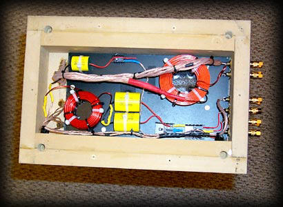

I'm also wondering about accessing the crossover - I'd taken out the woofers to get a look inside, but didn't find an accessible crossover. I assume it's under part of transmission line - has anyone gotten inside for a good look?

read the article i linked to, the c/o is in the base of the speaker.

I'd checked the link you provided - I was hoping someone had actually figured out how to access the crossover without ripping the cabinet apart. The designer must not have wanted folks to see what's under the hood.

tuberube said:I'd checked the link you provided - I was hoping someone had actually figured out how to access the crossover without ripping the cabinet apart. The designer must not have wanted folks to see what's under the hood.
Heron crossover sub chamber
(note the binding post options to select from one
of three hard-wired mid/tweeter filter networks)
Hi, sorry you have click in a link in the article to find the above, 🙂/sreten.
