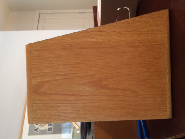

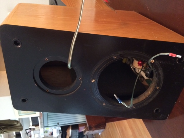

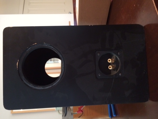

The basic exterior dimensions of the cabinet are 9" wide and 12" deep at the base, and 9" wide and 8.5" deep at the top. Panel thickness is 3/4" throughout. The Variovent sits behind the tweeter, centered on the back panel about 4.25" from the top.

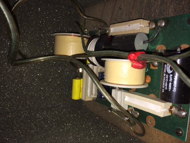

I've attached the crossover diagram for the MDY-4. I purchased the speakers as a kit from Madisound about 20 years ago! I sent them an email recently for a copy of the MDY-4 crossover for my own use and they were happy to send it to me. If you should have an questions that I can't answer, you can contact Madisound and they are very accommodating.
I've also attached some photos of my MDY-4 cabinets. I removed the tweeter and the 17W75XL woofer from the cabinet to build a floor-standing MTM of Dynaudio design (I believe it's called the TWYNN). It utilizes two different-sized cavities for the upper and lower woofer, so the XL went into the lower, larger cavity.
The reason I tell you this long story is that you'd asked about how I liked Dynaudio. The only thing I'm not crazy about is the Variovent. I've never been been able to achieve the bass response I want (tight, but not too tight that the speaker cannot reproduce lower bass or kick drum notes). Were I to do it again with my own enclosure design I would chose either ported or sealed as both are easier to tune!
In regards to the drivers, I can't say enough. I've driven the 17W75XL right to its xmax and I thought the driver would break from the enclosure, but it never broke a sweat. The tweeter is lovely. Detailed, smooth, a joy to listen to over long periods. I've own metal dome tweeters before but I'd never go back.
My wife's family was originally from The Hague and everyone I've spoken to from The Netherlands spoke better English than I did, so I've written the text above with that assumption. If something is not clear, it's probably by English, so please write back so I can correct.
I hope this is all helpful to you.

After examing the MDY-4 filter I notice that they use an 3 order 18dB filter for the tweeter and a 1 order 6dB filter for the basmid speaker. Dynaudio uses most of the time 1 order 6dB filtering in their filters. I think it makes the work for the tweeter much more easier and maybe better sounding with an18dB filer . So I will give this a try. Madisound has also used impedancecorrection what could be very helpfull for mine tubeamplifiers to perform well.

My apologies for not including the cabinet height. It is 16". The construction is of 3/4" MDF and there are no internal braces. All measurements are external.
For some reason I had in my head that the woofers were 17W75XL (keep in mind I purchased them circa 1994). The correct woofer, as I confirmed from several sources, is the 17W75 ER (as you pointed out).
The MDY-4 is a bespoke Madisound design, and for whatever reason they prefer a steeper slope in the crossover. When I gutted the MDY-4 to populate a set of Dynaudio Twynn, Madisound offered two crossovers: the 6 dB slope Dynaudio design and their own steeper crossover.
Good luck and keep me posted.
