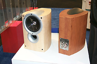

I am interested in building a pair of cabinets like this:
http://mywebpages.comcast.net/kidder/Audio/TransLam/translam_alpha.htm
Does anyone know of a job shop in the Northwest that would
do this kind of work?
Any ideas what it would cost to get done?
Anyone tried it?
-herm

I really like the way that those came out. Anyone know anywhere to get some CNC cutting done in the Southwast? 😀
Brian
I have seen and listened to those speakers and they are made from ply not MDF. I think one of the reasons Keith made them out of ply was so that they would look so cool after finish was applied.
I imagine he had the pieces cut ( if he didn't do it himself ) at a shop in Alberquerque since he lives close to there.

You can easily pull that off. I have done it a couple of times using MDF. I made templates then stacked rough cut boards on top. I used a flush cut router bit to make it silky smooth. Just go one layer at a time and it will turn out nice.

You don´t need CNC for this - unless u want to build 100 enclousures upwards.
For the inside cut you need this:
http://www.hegner-gmbh.com/images/Polycut.gif
for the outside cut better and faster this:
http://www.hema-saegen.de/standard/standardsaege1.htm
I build a lot of much more complex parts with this tools.

It all depends what's cheaper: CNC services or getting both of this machines, plus your time to route ea. piece to shape, using a template. 100 pieces is my wild guess?
waaaa! i did it the hard way. no lathe forget about cnc lathe.
assuming you are using 25mmMDF and your cabinets are 24" tall you need about 50 pcs for a pair. it also wastes a lot of wood.
my cabinets are twice as tall and i would have needed 100pcs give or take a few. hence i did it the easy way. i bent the wood.
confused between the strenght of ply and the fact that everyone else was using MDF i used alternate sheets of ply and mdf. bending the wood also pre stresses the wood and actually made it stiffer. now i am in the proess of applyinf a resin bonded fiberglass coat to the inside for strength. dave has a few pics i setn him. i hate ot clog the net with un nessacary pics. besides from india my bandwidth is kinda limited.
just and alternate method to do things esp if you dont have a lot of power tools. I have none.
