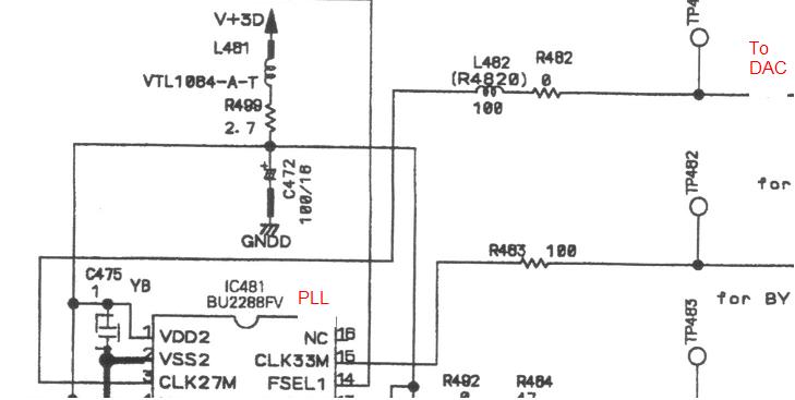

In Pioneer DV-444 (DVD player) clock supplied from PLL (see picture).
PLL MCLK signal to DAC (PCM1742EK BB) is connected with 16 cm length wire (PCB trace).
Signal in scope (MCLK near PCM1742) looks bad.
Also I want to connect CS4392 (DAC) in parallel. Distance from PLL to CS4392 DAC is about 25cm.
How to transfer MCLK (22MHz) signal to second DAC with minimal additional jitter and minimal distortion?

Hi, 50 Ohm or 75 Ohm coax properly terminated at the receiving end. Horowitz second edition page 611 & 879.😎
Agree with Elso, try MMCX or Hirose u.FL micro connectors and the proper size of coax, and make certain to match termination.

If you mean double terminated and you are satisfied with halved signal levels.......

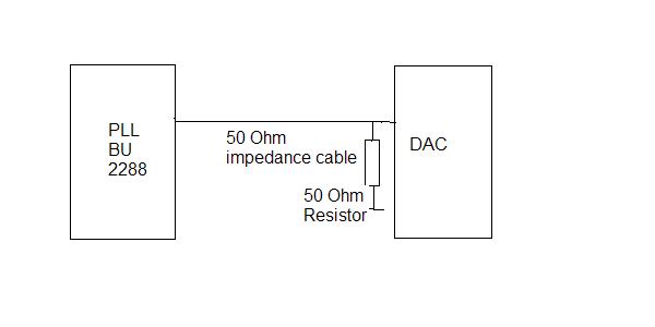

Connection schematic
Thanks for replayes.
When 50 or 75 Ohm terminator is connected to ground at receiver side, it take current.
PLL supply is 3,3V. If logical 1 is 2,5 volt, then current in 50 Ohm terminator will be 50mA.
This amount of current is acceptable for CMOS PLL ?

But that's what I learnt at school. Transmission lines have to be double terminated in order to work properly (no reflection on both sides)

If you only intend for the signal to go in one direction, it's perfectly OK to drive from a low impedance and terminate in the characteristic impedance of the cable. This will prevent any reflection.
On dc biased signals, you might find a C-R termination better, or a termination biased to Vcc/2.
