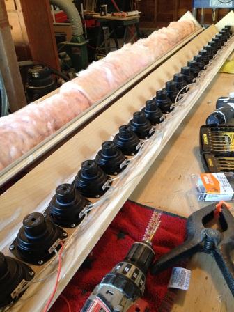

The beta version of the speakers are done and in. I'm designating them as beta versions because I think some tweaking is required.

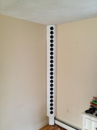

MCLA config-
7 feet long
22 Aura 3" 8 ohm drivers per side
Flat eq settings based on mcla spec

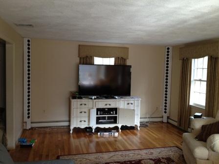

Room-
13x25x7.5
Speakers on short wall
Single double pane window 4 feet from each speaker
Hardwood floors
Not much absorptive material in room

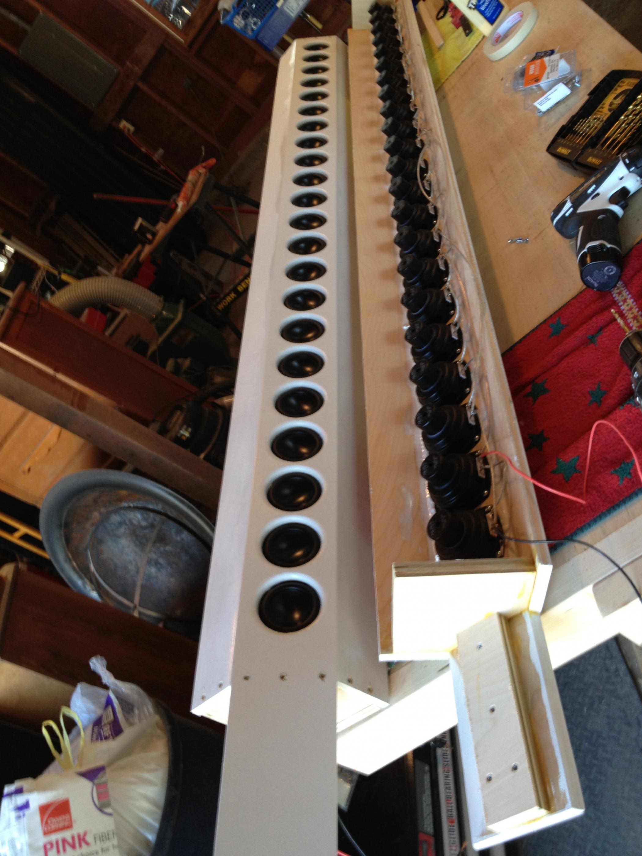

Part 2
1. Pictures for the project will be uploader later today

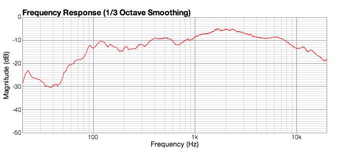

2. I've gotten better at using the DEQ2496 (RTA, GEQ, PEQ). I have 3 memory settings at this time (a. MCLA specified settings-flat response, b. RTA AutoEQ, c. my ear/interpretation)
3. I still am very dissappointed with the sound. Very colored, minimal impact.
4. I have not done measurements, but it appears as if the off access reponse drops off very quckly.
5. Positives- bass response appears to be pretty good. Nowhere near as good as my infinite baffle sub in my family room.

How did you wire the speakers? I ask because I once read an interesting article that proposed a wiring so that more sound came out of the middle speakers than the ones at the ends of the array. This decreased the effects of interference.

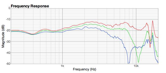

I have been founding these plots about your drivers :
If you say that the array bass level is Ok, it's already something positive, but the over 1000 Hz part is not very nice. You can correct most of the axis response with the DEQ but the off axis will stay as it is ( BTW, these measurements are done on a 10 cm wide 2.5 liter sealed baffle).
The question is to know what this becomes with 22 stacked drivers and in what it contributes to the final result. The answer is that you have to measure this with something else that the embedded RTA of the DEQ. I guess you already have a mike. With a good sound card and one of the many free programs around, it's done.
What are you planning for the tapering ? I think that some people have been using serie resistors with an increment value of 0.2 or 0.3 ohms. After 10 steps you are at 2 ohms, this can be tried if you don't find a more elegant solution with the serie/parallel wiring.
