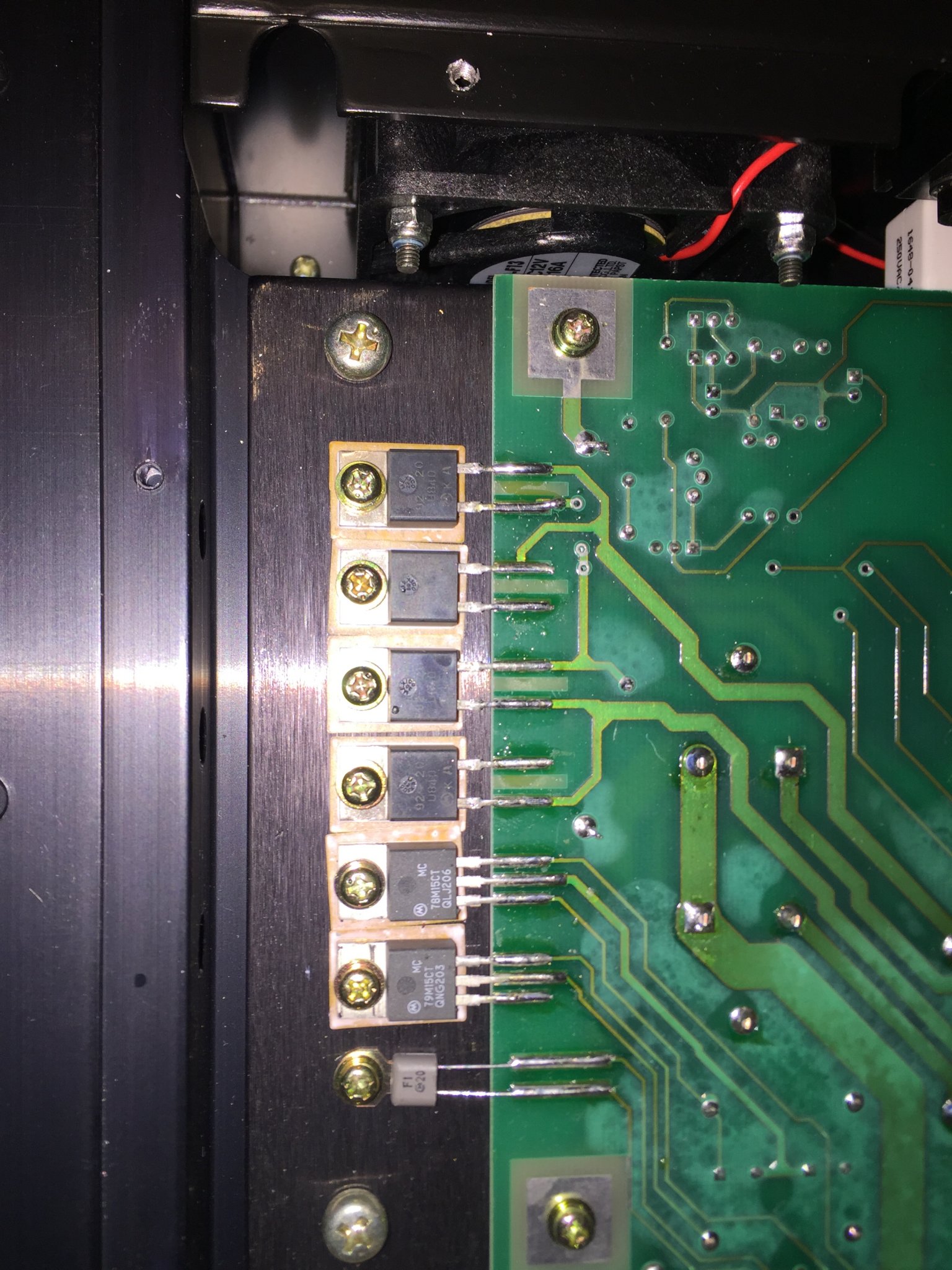

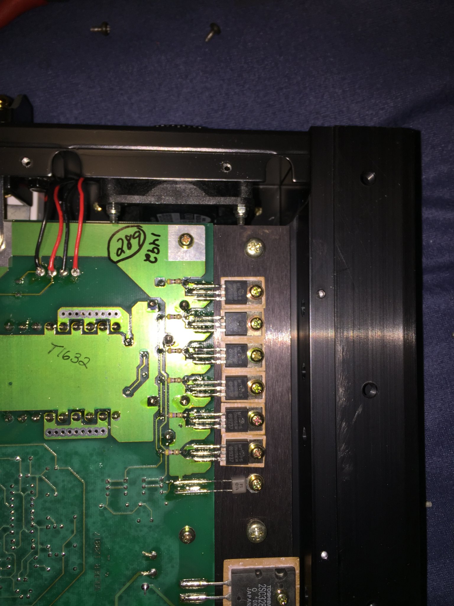

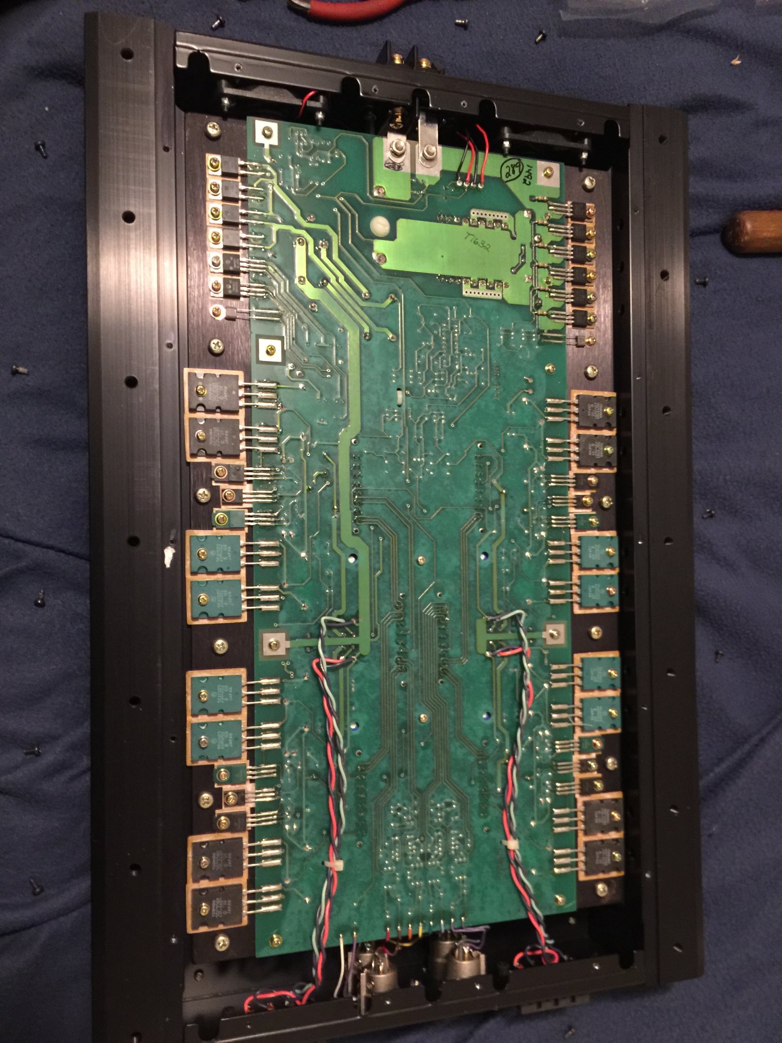

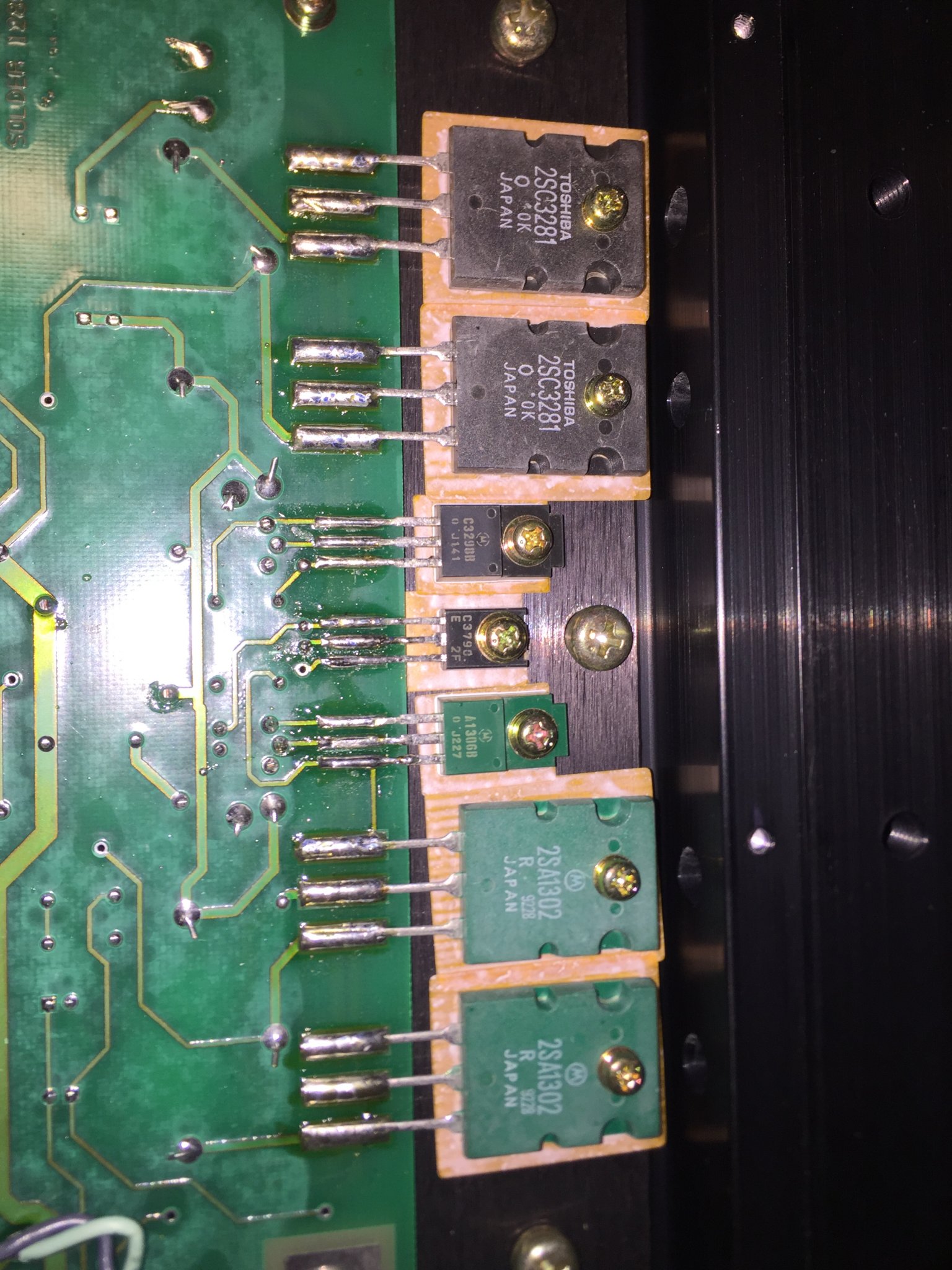

Nudes for the masses, inside is very different than the later models. Power supply is using MTP50N05EW FETs, output stage is 2SC3281/2SA1302 based with Motorola 2SC3298/2SA1306 drivers. Input is fully balanced, and there are only 2 wires soldered to the ‘control’ jack. I believe this confirms my suspicion that there may be a power guard output, as there are only 2 wires present. So remote and PG make sense, as that’s what the later units had.

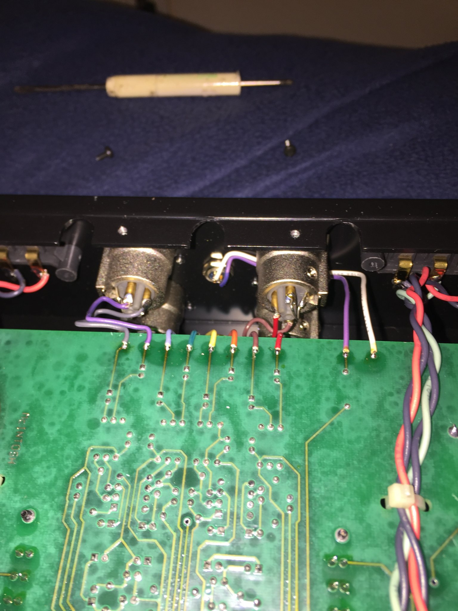

Control jack, showing the 2 wires. From the outside of the amp remote is the first pin clockwise from the large alignment key at the top, the other pin (assumed to be PG related) is across from that on the bottom left. The other two are unpopulated.
