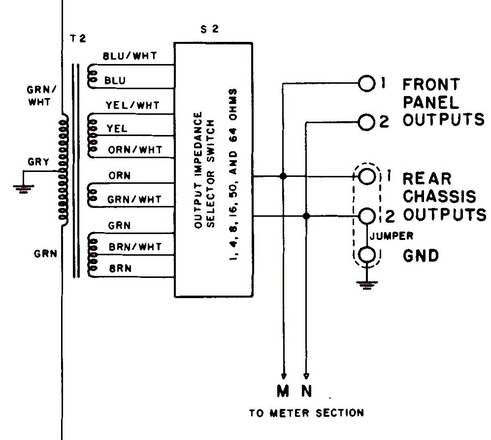

i have a question for the knowledgeable. was/is the linear technology employed in the mc3500 amp a stable and fiable approach for replicating. the amp schematic is readily available but i find the transformer winding, turns, iron mass information is scarce. these units are selling for way over 10000 dollars u.s. and i thought cloning one might be a worthwhile project. any and all thoughts on this subject needed. thanks

Cloning one is rather straight forward, if you have the original output transformers. And that is a big "if"! The outputs are a unique penta-filar design (5 side by side windings for the primaries) that would be cost prohibative to make now, but there are people that will do it if you are willing to meet their price. Dennis Hoyer of "Audio Transformers" comes to mind. Do a search on him.
Anyway, once you get the outputs, basically you will just have to start collecting the other parts. Plitron makes a 175-0-175 transformer rated at 750VA or 1000VA that would make a good B+ transformer. The other voltages are easy to come by with other transformers commonly available.
As for the front end on the MC3500, several "upgrades" can be done without changing the basic circuit. Like, using a CCS on the cathodes of the phase splitter and using a regulated negative supply rail. The original front end circuit does the job, but isn't that great. Do a search for "Zed Audio" and e-mail him. He has a pair of these amps that he has restored.
As for the output transformers, each of the primary windings is rated at 150 ohms CT. There are 4 output windings; 2 each of 4 ohms with 1 ohm taps, and 2 more windings at 1 ohm each. with this combination, out can achieve output impedences between 1 ohm and 64 ohms. Each output weighs around 50-60 pounds; they are heavy!
As for the ratings, they can do 500 watts RMS easy.
I have been collecting parts to make a pair for the last 4 to 5 years; I guess just to say that I have a pair. No pun intended.
Bottom line is, these Macs are a money pit to build, even if you already have the output transformers. Each of the output tubes will cost you $50 each, and if the amp isn't properly set up, the amp will eat them up. There are much better sounding amps that can be made (think triodes with no NFB).

I have a manual on the MC3500 and besides describing the output transformer as "pentafilar wound", it also states that the primary is wound in 10 sections. This is a double "C" core transformer and the windings are on 2 bobbins, kind of like the original Williamson configuration. This means 5 sections of primary interleaved with 4 sections of secondary on each bobbin. You can calculate primary inductance by knowing that the primaries are each 150 ohms center tapped and that typically the Quality Factor of Mac outputs is around 75000. This will get you acceptable leakage inductance for the transformer. It's going to be a lot of math but doable. Look at RDH4 for the formulas.

Hi danFrank
It would be helpful to state the technical specifications with reference to the colour coding of the transformer. To be specific:
-- what is the step down for the primary relative to each of the secondaries
-- what is the phase shift
-- what is the induction of the primary
-- what is the DC resistance of the primary and each of the secondaries
It would also be useful to know the iron mass, but that would require a disassembly which in all likelyhood would be destructive.
