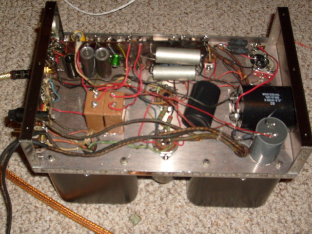

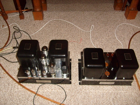

Here is the thing..Both amp need updates and a 35uf polypro filter cap is paramount off the rectifier tube.The Mc30 only has one filter can and it isn't nearly enough to properly supply energy to the circuit when you have 4 tubes driving a pair of 6L6gcs.The phase inverter should be changed to a 6cg7 in the mc30 as well as the AZ80.Here is how I did this pair of mc30s and I put new chassis on each of them as well as an all film cap power supply.
I also did everything without damaging or cutting the chassis's so they can be reversed if you ever want to put it back to original..Anyway,you pretty much have to recap AZ80s with the poly and a pair of dual 100uf FT or JJ caps.Just keep that 35uf poly for the charging cap in each case.
