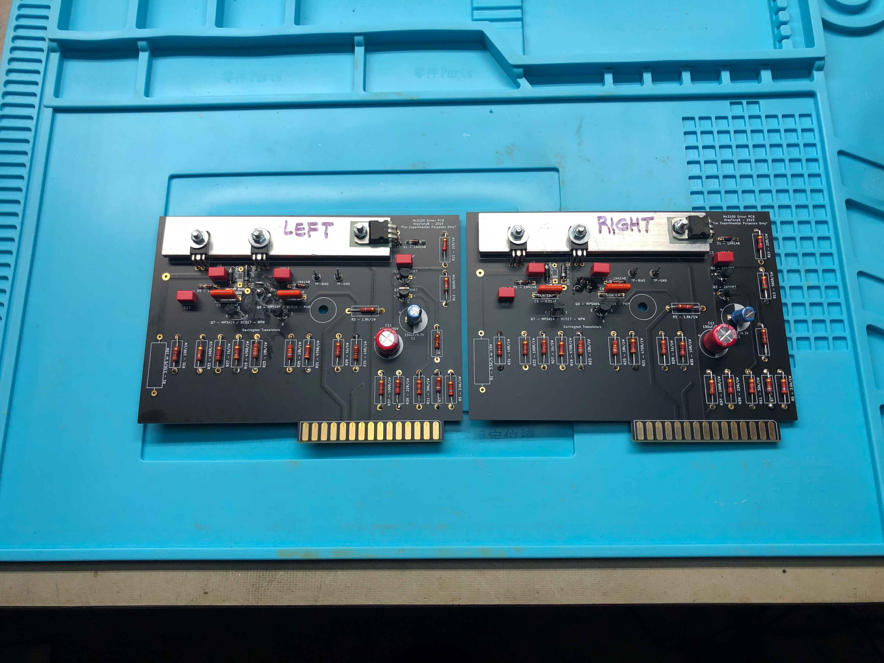

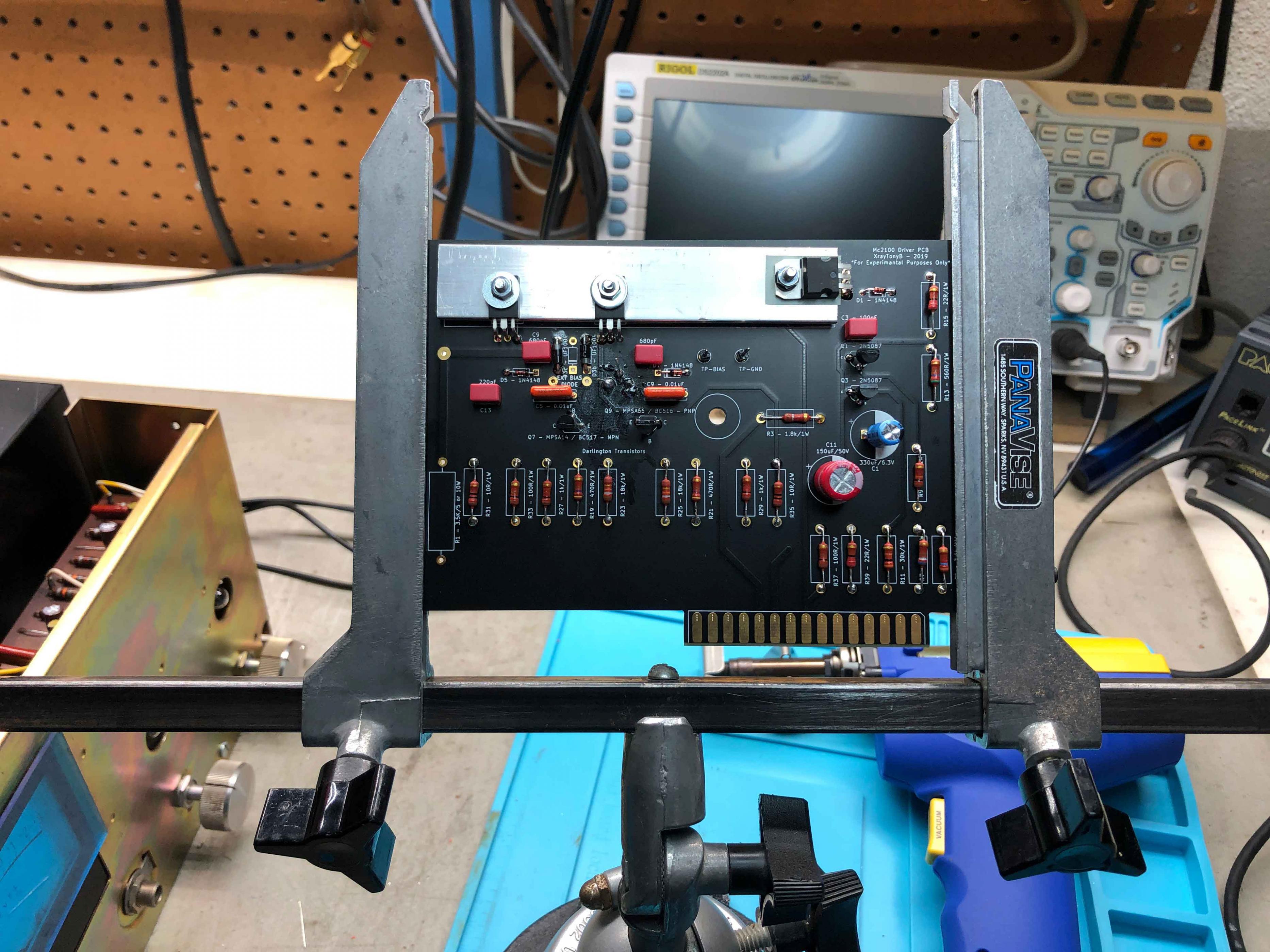

MC2100/2105 Tony B. Boards finished!
Hey there to anyone who is watching this thread! I finished both the right and left output boards for my McIntosh MC2105. These are the experimental boards that Tony produced earlier this year. See the attached photo for the finished products.
I simply followed Tony's very clear and informative videos and did everything exactly as prescribed with one exception. I did not opt to add the external biasing diodes but instead utilized all three of the suggested diodes on the board.
I also rebuilt the entire power section along with all of the filter caps and all the output transistors. I used the MJ21194 transistors and replaced all the 0.33 and 0.56 5W power output resistors as well.
This all worked the first time I tried it on the Dim Bulb tester much to my delight!
I tested the unit at several frequencies including down to 20 Hz and as high as 50KHz. THD was solid around 0.09 or less.
Something to note is that even though the McIntosh MC2300 (yes that's 300W/channel) has the exact same original output boards, Tony's experimental boards will not fit.
This is due to a difference in the McIntosh amplifier chassis design. The output boards for the 2100/2105 chassis are mounted parallel on either side of the large filter caps. On the 2300 chassis which is necessarily much larger and has 4 of the large filter caps, the boards are mounted in series.
Tony designed the experimental boards slightly larger than the originals which is no problem with either the 2100 or the 2105. However, they are too long to fit into both mounting slots in the 2300 design.
Unfortunately for me that leaves me with an extra set of Tony's experimental boards. But that's OK, maybe I will get another 2105 some day!
Anyway, I had a great time doing this project and look forward to more of Tony's excellent videos. Maybe one of the other fine McIntosh products like the C32 pre-amp will come his way.
