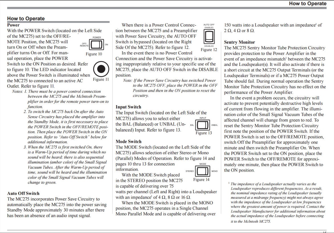

Amplifier goes on protection on the left side only
It is supposed that if any of tubes has a problem then protection flashes tuber red
here this is lot the case
if you swap tubes form the other ch you have the same failure
If you remove tubes totally from the ch still you have this protection issue

If the issue exist if you remove the tube from the channel maybe the problem is on the logic of control
Walter
amplifier blinks red before everything else one ch only so it cannot dissangage from protection ...Obviously this has nothing to do with the speakers sice we havnet get there yet
Other ch presumably working cannot perform the warm up procedure from amber to green since amp stays on portection
