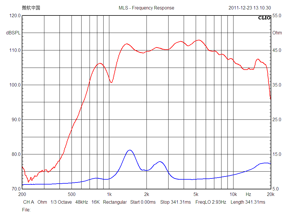

I found a chart on another manufacturer of the driver.

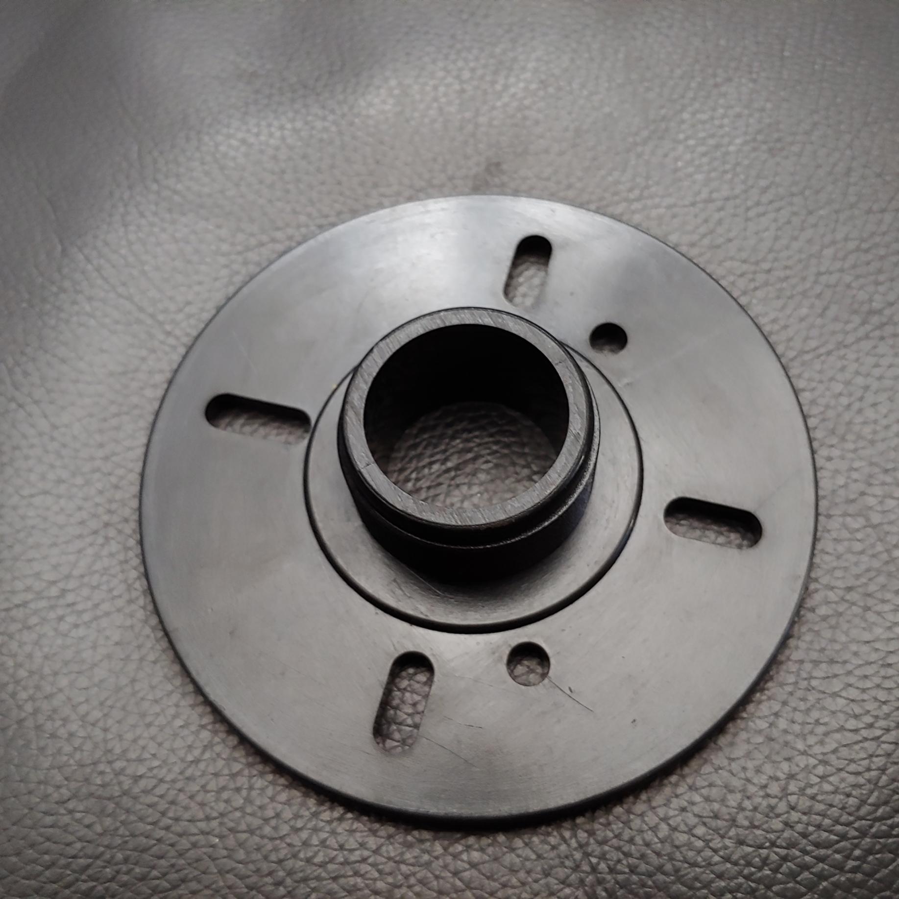

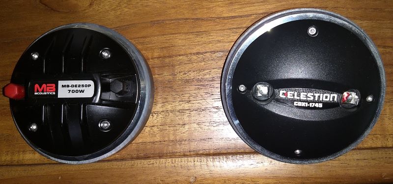

Driver looks good and cames with a screw adapter. Driver is ligther, amd has reduced heigth and diameter, so it is not made with the same toiling as the original. This by itself does nkt mean anything as other good clones like the prv and the celestion have different measuraments.

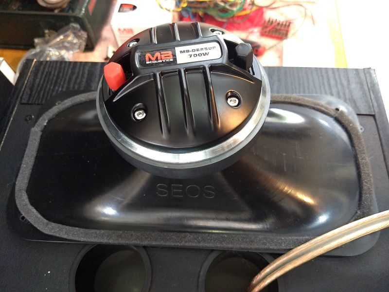

Measurement results on a SEOS-12

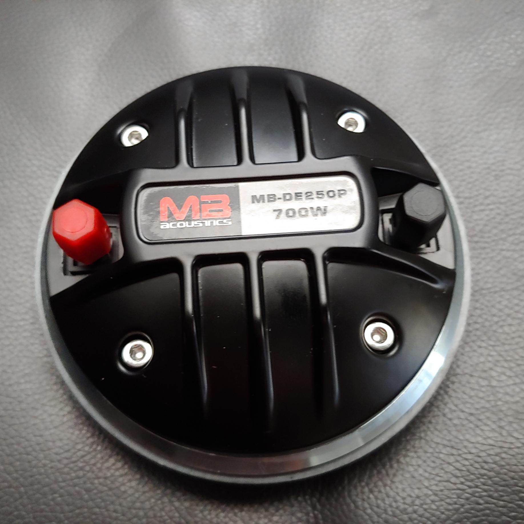

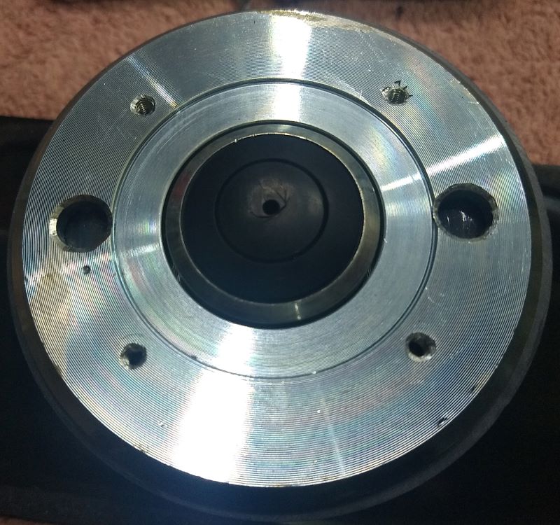

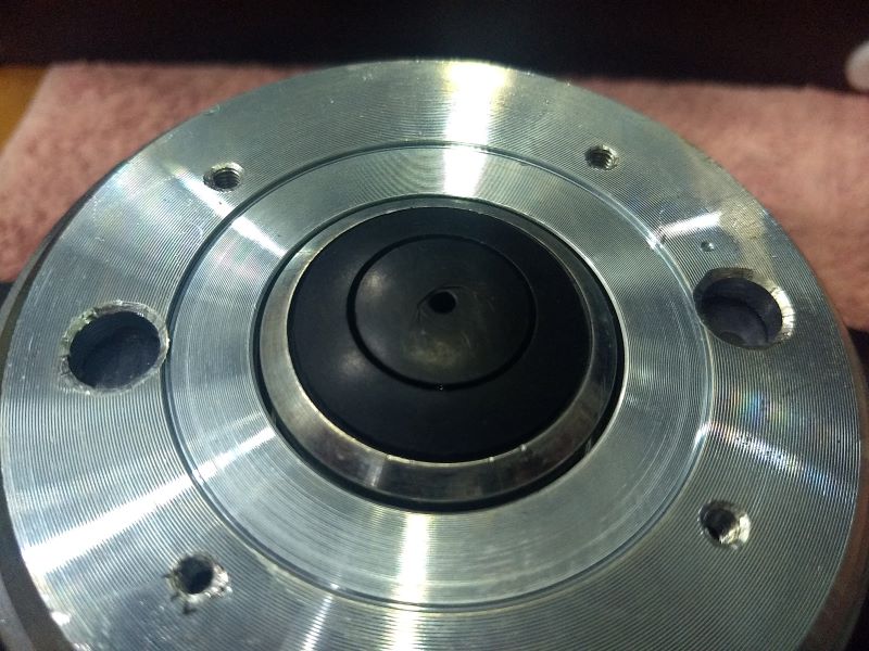

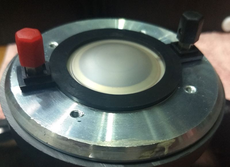

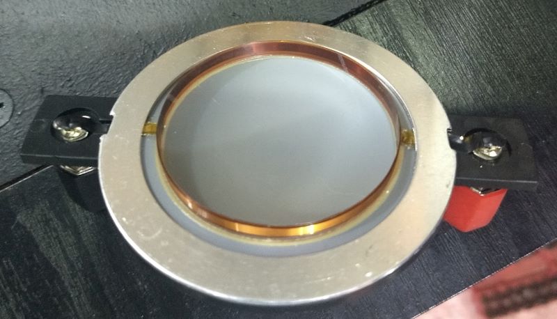

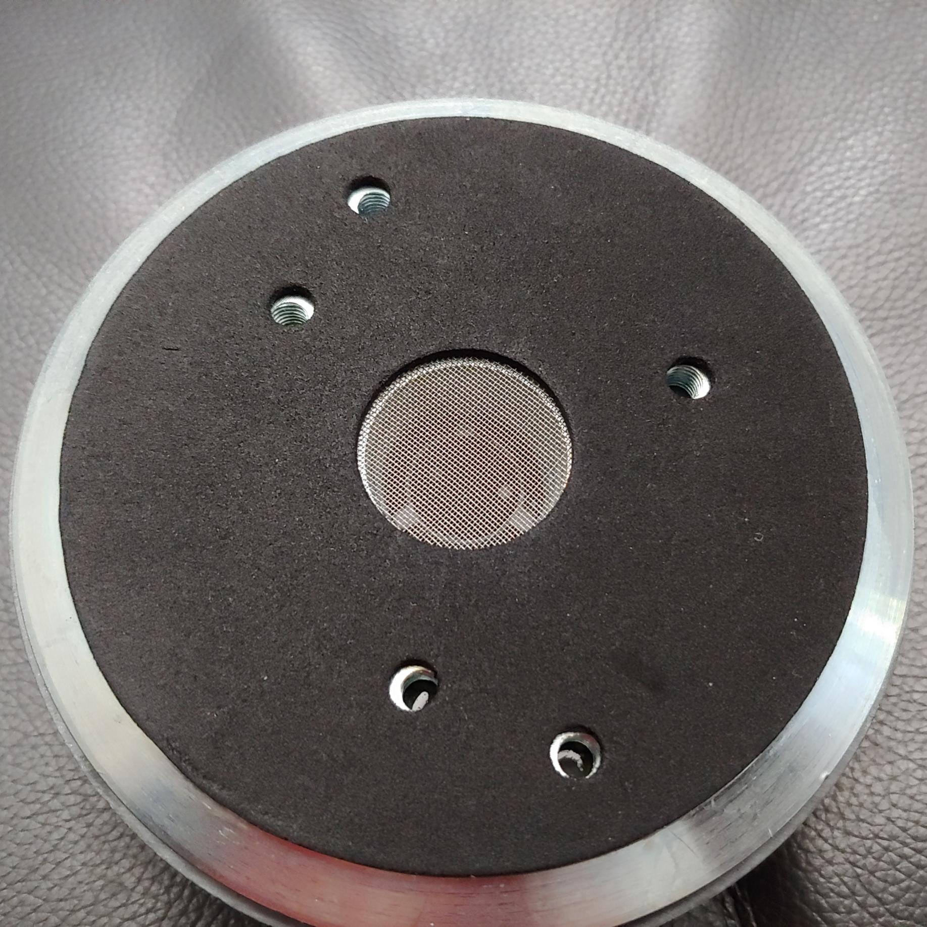

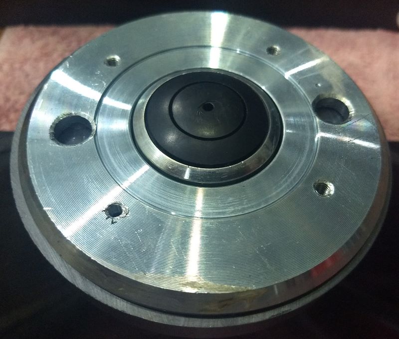

So I jumped in and purchased two of these CD's.

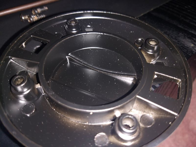

I'm sorry to say the two units I received were, to me, unserviceable.

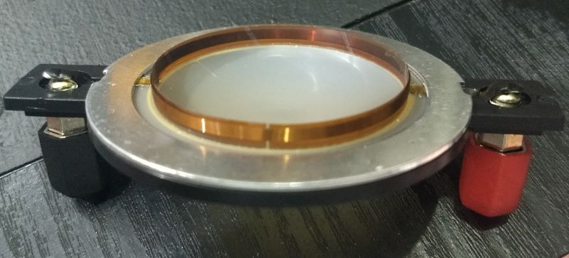

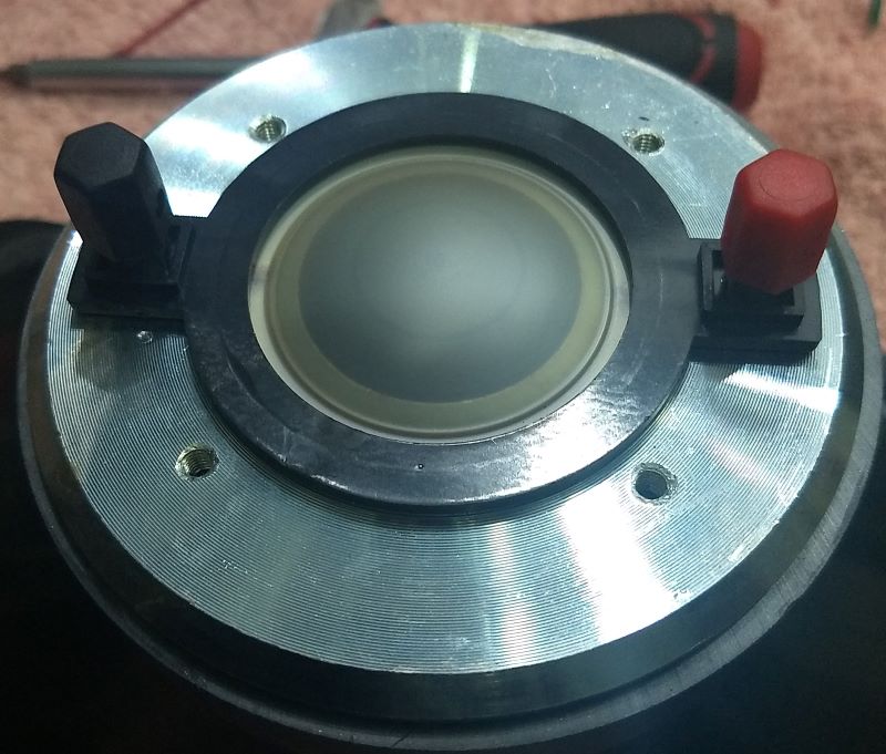

First some pics of the first unit taken when the seller suggested I reseat the diaphragm.
The machining quality is not great. Looks like the holes in the top plate have been done by hand on a drill press.
The rear cover seat edge isn't well finished, and the defects were not treated prior to painting.

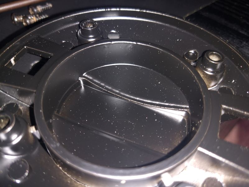

And check out the defect in the phase plug.
Measurements to come in the next post....

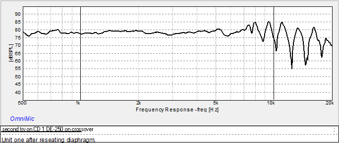

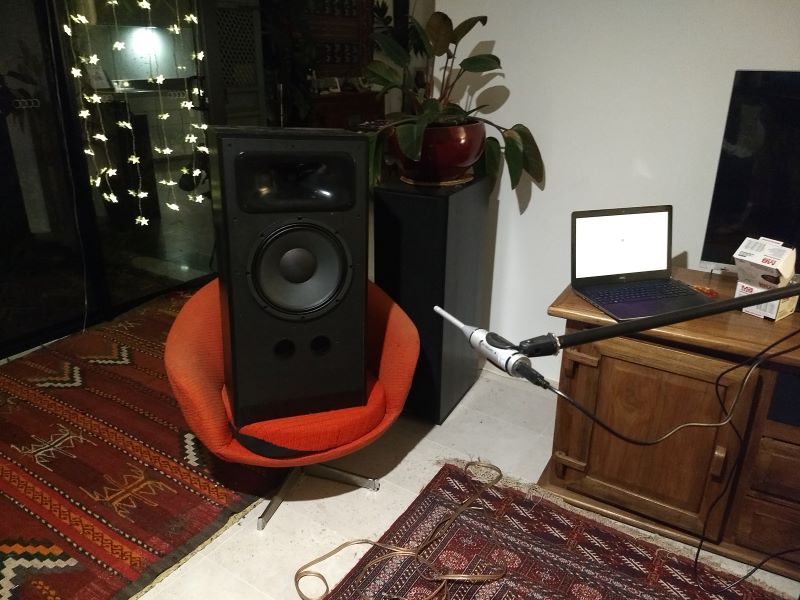

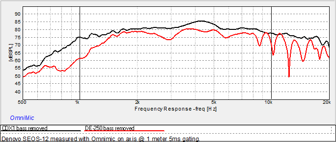

MB DE250-P on SEOS-12

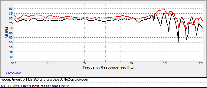

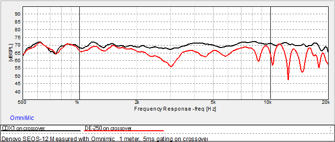

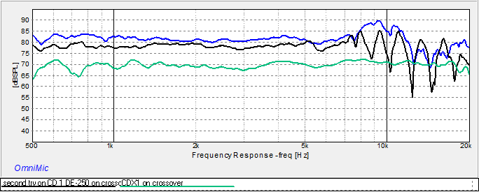

Here are my measurements, using Omnimic @ 1m with between 3 and 5 ms gating.
For comparison I include the MB measurements both raw, without any crossover, and on my home made crossover for the CDX1 with the Faital Pro 12PR300 for an Econowave inspired build.
The CDX1-1745 is a thing of beauty to me. It is a precision made instrument and sounds like cream.
Don't think I'm being too harsh on the measured performance of the MB here. The picture of the frequency response on the box looks nothing like how these two measured! See image in post #8 for a picture of this plot.
I have to say however that that service from Ramiro at TMC was first rate. He gave me a full refund, including shipping cost, and was polite and prompt with all his communications. 🙂
Hoping mine were just a bad batch?

The manufacturer plot has nothing to do with the real performance as seen in your imange #8. There are great products coming from china and great clones like the denovos. This does not seem to be one. The specs are too off to be a bad batch. Shame.

The lousy ( HF comb-filtered ) measurements are explained by the absence of a properly designed phase plug.
It should look like this ( from a B&C de250 );
Instead of this;
That singular ( central ) hole is the problem ( IMHO ).

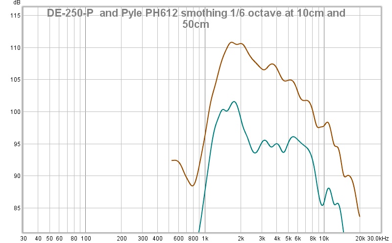

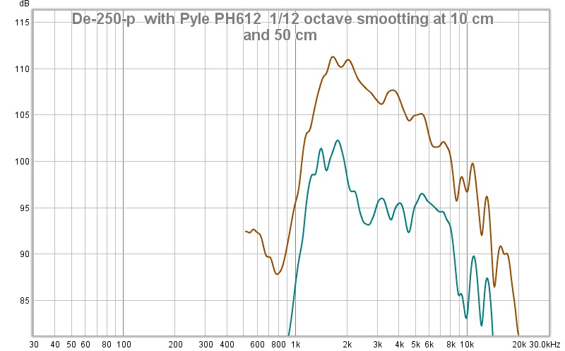

Same measurements at 10 and 50 cm. Using different smoothing ( 1/6 and 1/12 of octave). The horn is a Pyle PH612 used with the included adapter and no crossover no eq (just started the sweep about 700 Hz).
