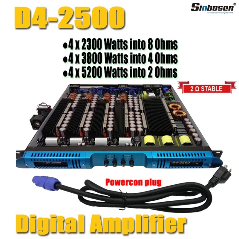

The current benchmark for how many watts can be crammed into the smallest space looks something like this. I'm not suggesting you should try to do the same just illustrating what is possible.

See the pic in the above post.
Class D is extremely efficient, you can buy 2 x 5kW amps in a 1u or 2U rack case with maybe a small fan in case the amp gets too hot because it is in a hot room during the summer in Arizona.
You guys should get real.
