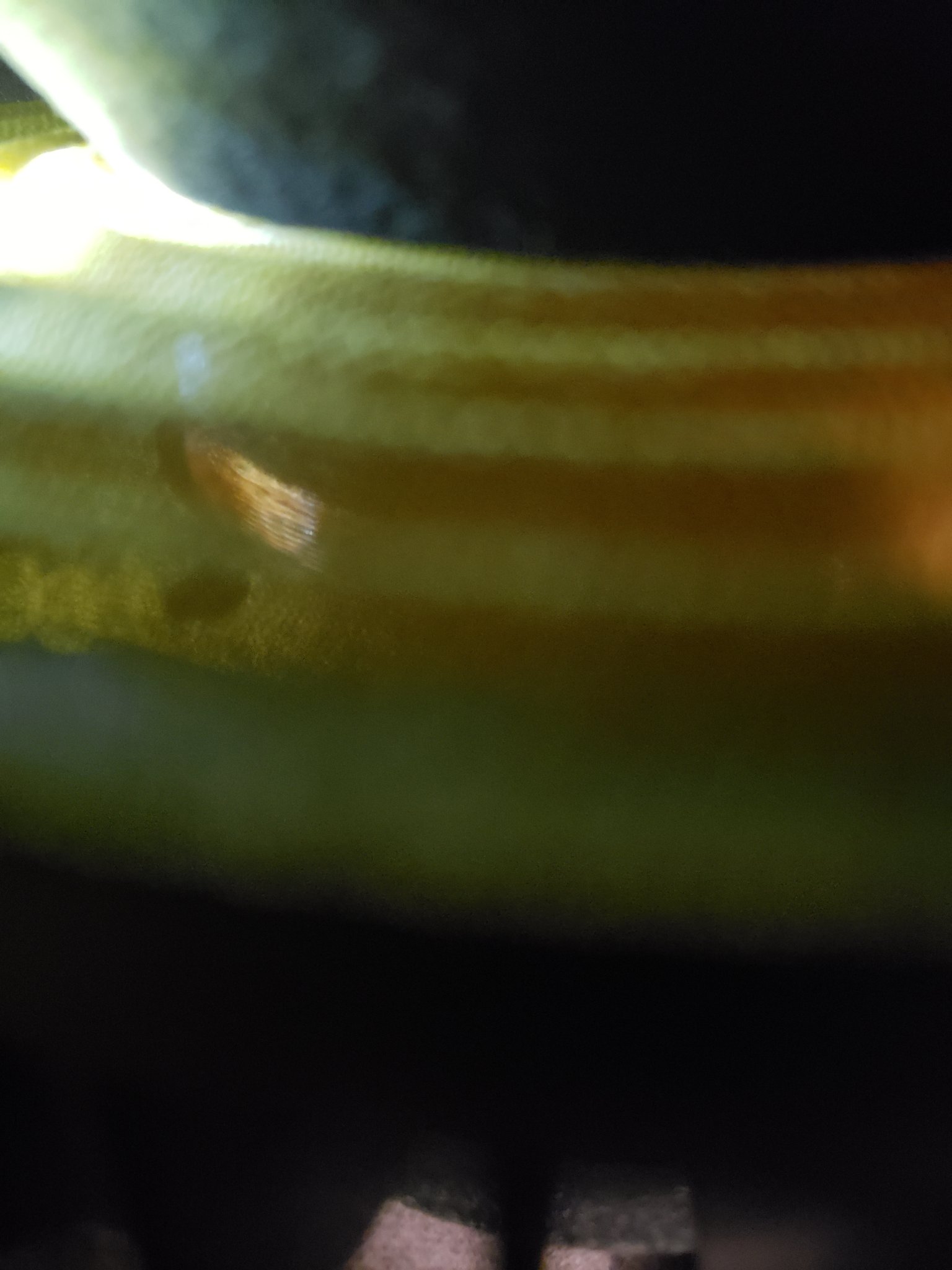

Take a bright flashlight and shine it into the side of the spider off at an angle. You'll have to get the angle just right, but I do this often and it works very well. The amount of VC winding visible above the pole plate is the actual real life xmax, not some embellished measurement via complex calculation.
Goodness knows. As noted, there isn't even an industry standard for what 'Xmax' means, let alone a standard method of generating a number for it. It was never meant to be more than a 'quick & dirty' approximate guideline, dating from a time when measurement gear was not readily available / affordable to many builders.
As for Xmech -since it's simply the physical / mechanical limit of travel (irrespective of what the actual physical limiting factor is), then 'simply' deflect the cone until you reach said limit & measure that deflection from the resting position with ye trusty ruler or similar implement. It may be a little out depending on how accurate you are with it and eyeballing the quantity, but it should be ~'near enough' for purpose.
You just have to have a feel for eyeballing it. At least you have some visual confirmation the driver has some amount of VC overhang. The best way to validate it indirectly is with IMD measurement.Yes, this is true for overhug coils.
