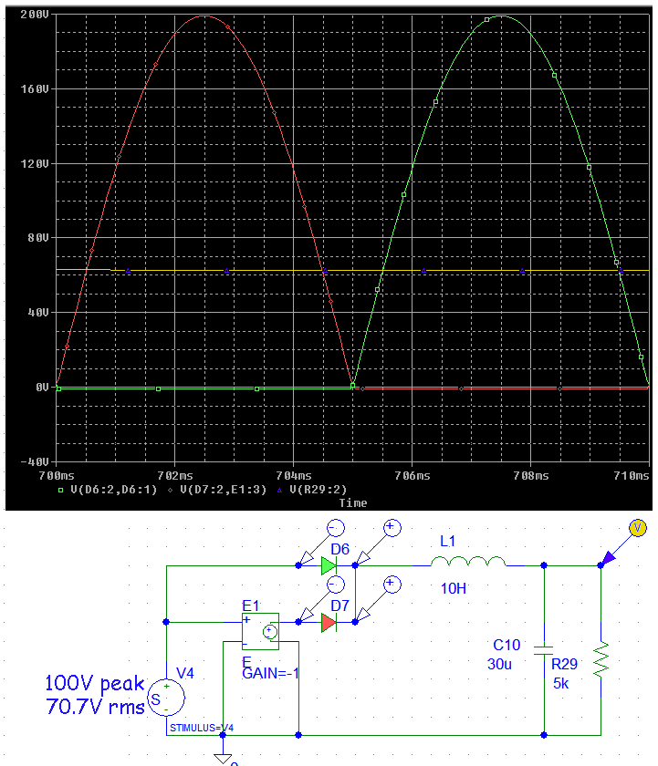

In the sim below, input both sides is 100V Peak 70.7V RMS. The rectifier reverse voltage is 199.2V (forward voltage with 1N400x rects is ~~0.7V). This is 2*Vrms*1.4 minus forward drop. Expected output is 70.7V*0.9 or 63.63V, simmed output is 62.9V (again ~~0.7V forward drop).

Nah, I'm not keen on that explanation for choke input.
Each diode PIV is twice the peak level of one side of the secondary winding, so for 660-0-660Vrms secondary each diode sustains a PIV of 660x1.4x2=1850V. At the peak of the mains sine waveform, the cathode is at the same level as the conducting anode, which is 1850V away from the other anode that is not conducting - the choke and output dc level are not dictating PIV.
The datasheet refers to 1500V as a design centre maximum PIV, and I'd suggest is lower than 1850V as it would relate to a continuous applied voltage condition.

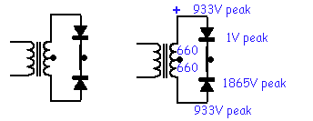

There is a very straightforward way to see it must be the RMS end-to-end voltage times 1.414 (then minus drop).
But we don't normally draw this affair to emphasize the back-to-back diode series connection across the end-to-end AC wave from the transformer.
Drawn like this, we see that it hardly matters "what" is connected to winding CT or diode CT. The two diodes together MUST block the entire winding peak voltage. Since one diode is conducting with low drop, the other diode must take essentially full peak voltage.

Tony, ss diodes used in series do indeed need some derating.
A 660-0-660V secondary does indicate 1850V peak nominal, which would I suggest be covered by three 1N4007 in series for each valve anode.
