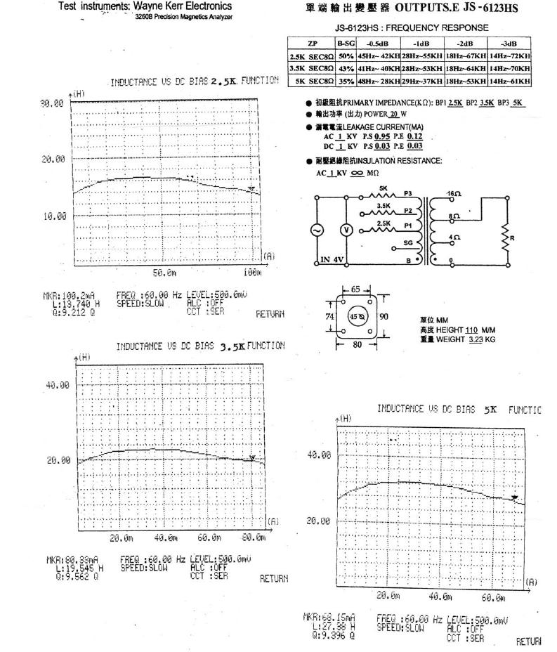

Hi, I see that this transformer is rated at 90ma primary current on some web-sites and 120ma pri current on others. Does anybody know what the saturation current is on these transformers? I have an amp planned that will run about 105ma on the primary and was wondering if this is too much? Anybody have experience with these transformers running at more than 90ma pri current? Thanks in advance... Daniel

I'm running them at 330V/92ma, SV811 A2, and there is plenty of bass, though that's with Visatron B200 open baffle. Not much of a data point I know. The spec' on the James website is 90ma at 20Ws, so my hunch is that 120ma around 300V would be too much.

Depending on the load
I think 120mA is too much.
The factory measurement: For 2.5k load the recommended allowable primary current is 100.2mA (primary inductance 18.74H); 3.5K load is 80.33mA (primary inductance 19.545H), 5K load is 68.15mA (primary inductance 27.38H). Please note that all is measured at 500mV level and at freq 60Hz.
So, if you are using 2.5K load, 105mA i think is worth to try since the maximum before saturation is 120mA.
I did the typo in regard to 6123HS. For 2.5K load, the correct primary inductance is 13.74H (not 18.74H) when measured at 100.2mA at 500mV level and freq 60Hz.
