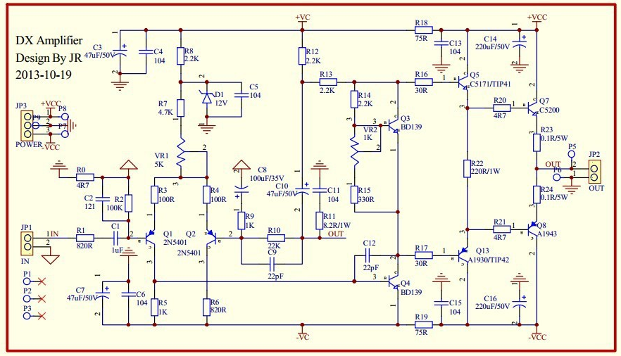

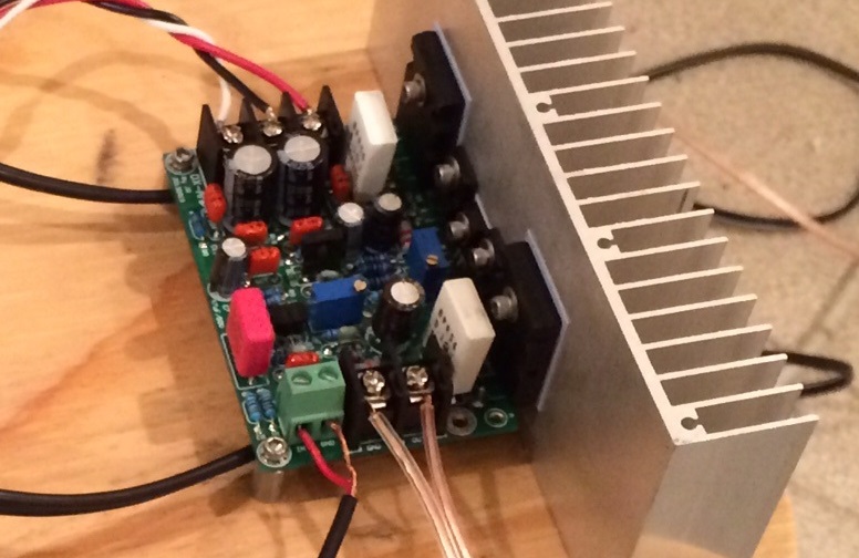

Possibly related to what is happening here but I have just built a Dx-clone amp (Similar to the Dx, but with some changes to the transitors and a few resistor values vs the official schematic), and am adjusting the bias now. There are two pots VR1 and VR2, and adjusting the VR2 to achieve 5mV across R24 (the emitter resistor) seems to have little effect whereas the VR1 has a large effect (sensitive). I managed to get 5mV across R24 (equal to 50mA quiescent current) and the offset at speaker out to be 5mV. The amp plays music and the heatsinks are cool (as opposed to really hot when I was turning one of the pots through the range to find where the 5mV spot was). However, I am noticing a sibillance or ringing in the treble range. It sounds like a slight time-delayed "tizzz" sound on high notes. The bass and mids sound fine. It is the same on both left and right amps - is this a symptom of poorly adjusted bias current, or could it be bad transistors, caps, etc.? The same symptom is on both amps so I don't think it is a single part failure.
Here is a photo of the assembled amp:

Vr1 is off set (Balances the input pair) VR2 is bias - you may have it set too low and hence the harshness. You have to measure across the emitter resistors, not to ground when setting the bias. VR1 could affect bias a little, but not very much IMO.
