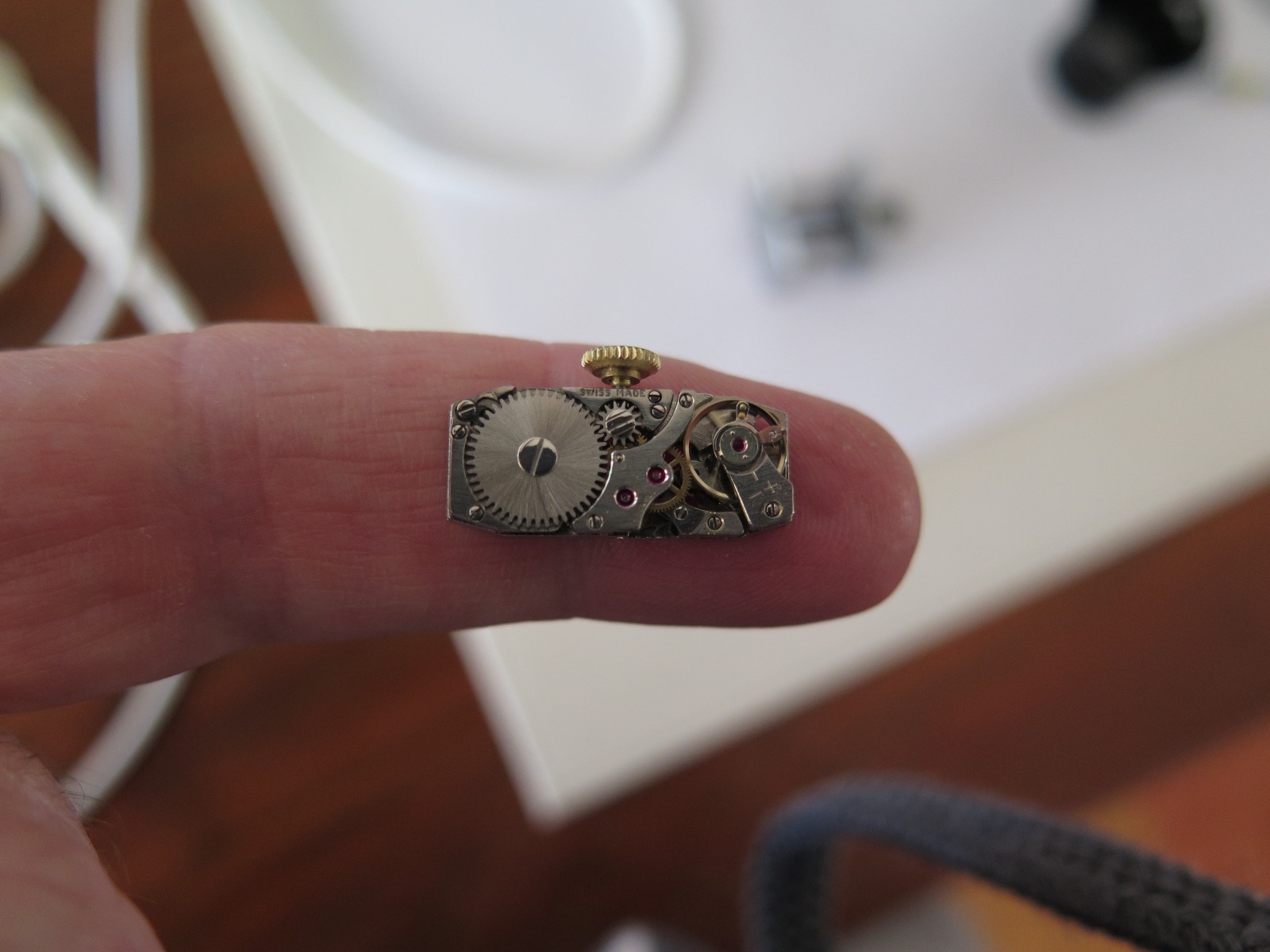

Here's the last watch I serviced (needing a new jewel and balance) which I found out afterwards is the equal smallest calibre made. It's my mother in law's 21st birthday present that she'd dropped and broken the balance in, many years ago. It's actually running in the photo. I know I shouldn't have my finger touching it... I got it to run circa two seconds a day, which I was happy with as I am a real amateur at this.
It was a HELL of a job pinning the hairspring with its tiny little wedge shaped stud pin and then massaging the spring so it is concentric and flat. An hour or more of intense fiddling!

Very nice tiny watch!
It's a very rewarding job, but one needs patience and precision.
If you can repair tiny watches like these, you're doing well.
Take a look at some good YouTube watchmakers.
Here's a very skilled (and funny) guy that has the tools to tackle almost anything.
https://www.youtube.com/@RedDeadRestoration
Start practicing on simple watches and clocks and learn along the way, just as you seem to do now.
Good tools like Bergeon are not cheap but well worth the investement.
