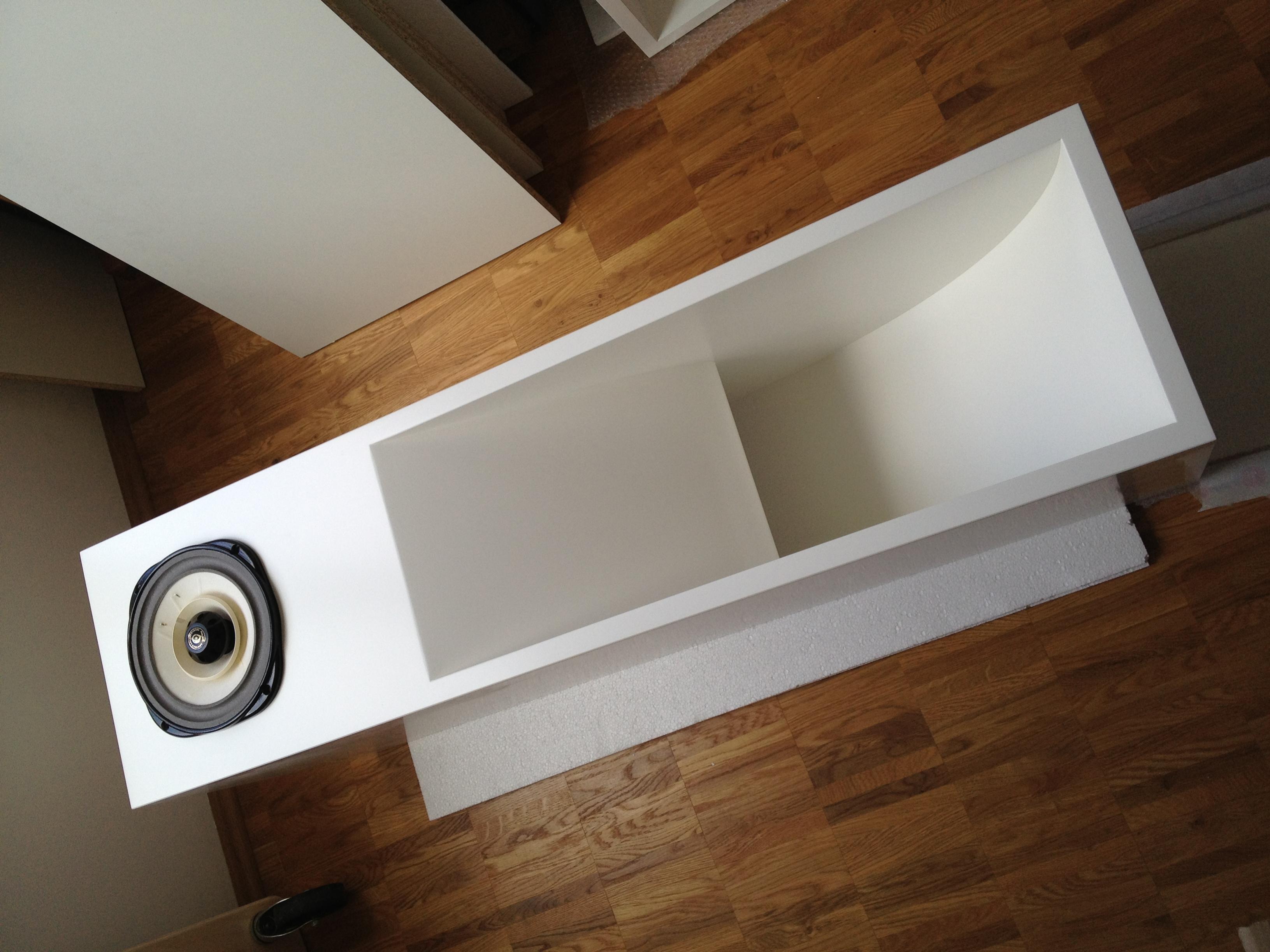

All,
I have built a pair of Mauhorn XII and mounted them with Lowther EX2. I am driving them with a 300B monoblock (inspired from WE91, Joe Robert's version from Sound Practice) (JLB). Well, in short, they sound terrible, all shouty and tiny. Although the Lowthers are new, I cant imagine that any break-in will correct the sound so much. The amp works wonderfully with other speakers, and the Mauhorn XII are supposed to be designed for Lowther EX series so I thought that I was playing it safe. This is my first pair of DIY speakers and I am quite new in the that game so any recommendation would be welcome. I ordered a Fostex FE206n just to see how it sounds in the enclosure but I am still waiting for it.
Thank you
Thank you

Many back-horns shouldn't need compensation for step-loss; that's one of the reasons to use them since you can use the gain to cancel out the losses, although there are other reasons (for & against) of course. 😉 With that said, as I mentioned above, many of the Lowther units could do with a shelving filter due to their inherent response, although I'd probably want a bypass cap on it too so the response > 10KHz doesn't drop like a brick.
Attached are some quick & dirty response plots for the Mauhorn XII. Most under 1/2 space conditions; the lowest is a nominal in-room; 1m distance; front baffle edges 1m from front & sidewalls, carpeted floor, angled 45 degrees into the room. Latter could be worse TBH; this is one of the ones that probably needs a shelving filter as it happens, but I've seen worse. Practical in-room conditions will make things rather more 'interesting' as per usual though.

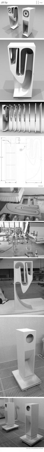

Thank you all,
- Lyndonlim, I used very dense MDF. Here is a quick montage, from renderings to speakers. The profile is exactly of a Mauhorn XII, with a curved path.
- Jim Shearer, I dont know about BSC and I will investigate right now. Do you recommend a calculator, and any reference I can wrap my head around?
- chris661 ,thanks. I will try to break them in a bit more aggressively. My main issue is that my wife and little kids are at home most of the day so I dont get much time to play boomy loud stuff.
Overall, I dont need huge bass (I woudl have gone for another design otherwise), but balanced sound. It seems that breaking them in + BSC might be a way to go. I am also experimenting with my amp to re-enforce the bass response a bit.
Julien,
You are a pro cabinet maker man! Superb equipment and skills.
As for me, the lowthers I had made my ears bleed even a few rooms away I could hear the shout. It's not a subtle effect either but different strokes for different folks...some people can tolerate the behaviour at high frequencies.
