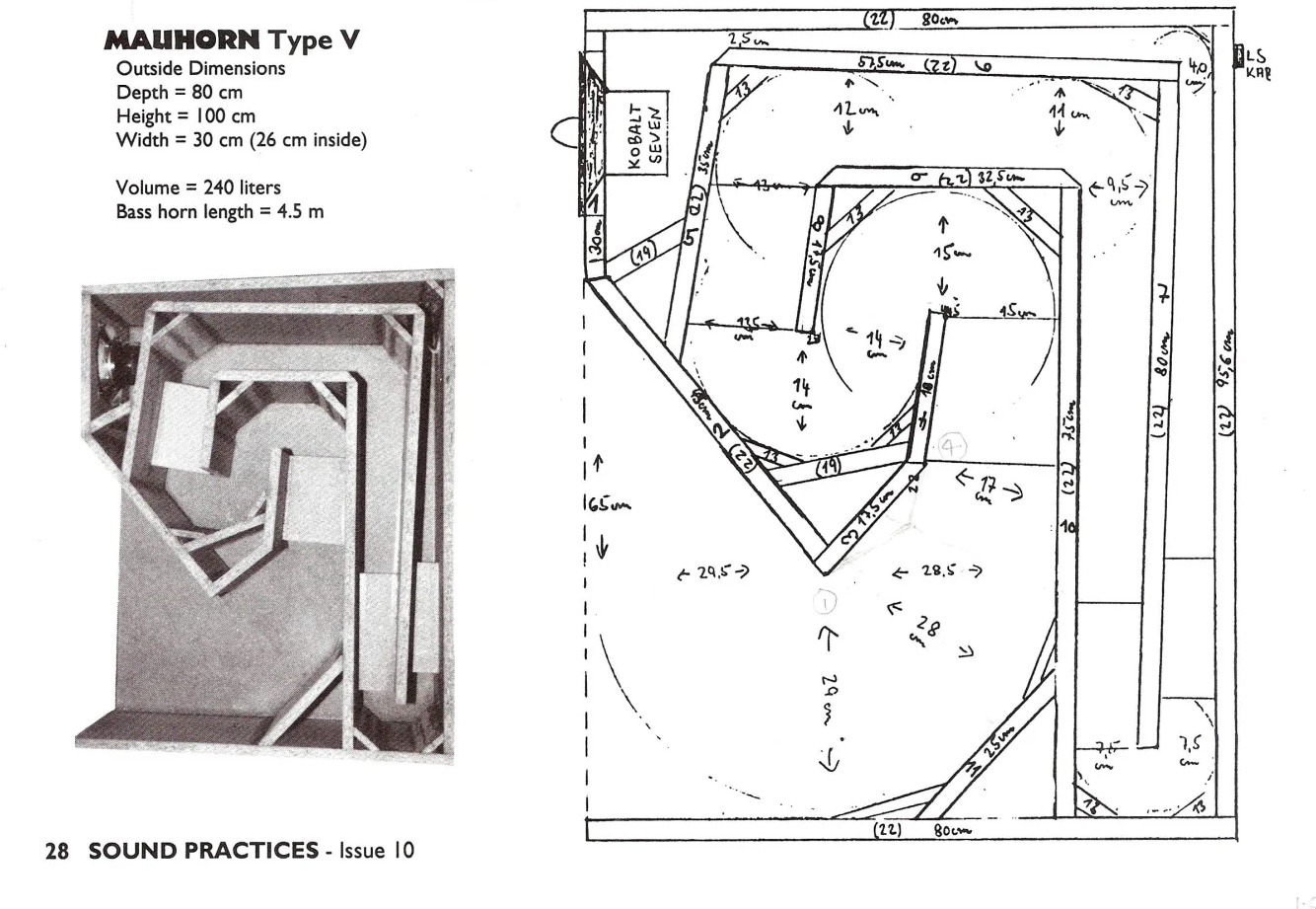

Anyone have plans for Mauhorn V. I only have a picture of the speaker from the side without all the measurements.

I just tried Google and straight away got this: https://darklanternforowen.wordpress.com/2015/01/03/mauhorn-iv/
It’s not the same version in the title of the link but there is some useful information for you on the version ‘V’ too
Strange how it works! I usually go right to something, but it was 'all over the map' trying to find anything beyond a number of folks asking, with only the one positive response! 🙁
