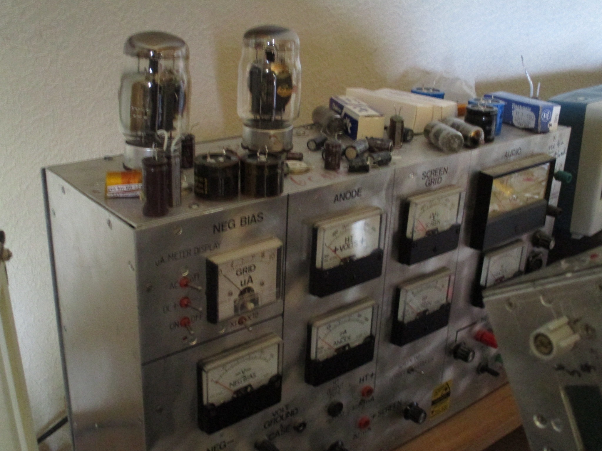

Single Bias pot ? The manufacturing adage in my early days selecting tubes for parallel P-P; select out of three tubes the nearest pair by measuring near sim anode currents (for given bias setting and screen ignoring UL), and do same for other P-P half with bias setting unaltered. That selection follows standard manufacturing deviations. Going to parallel pairs or triple sets, one has far more tolerance leverage and distortion is further reduced.
Many decades ago I made a homemade rig to create easy selection without the need to interfere with amp circuit. With such a tester every parameter is alterable, one soon discovers that many vendors who specify matched tubes, are not so good with their matching services.
Important in the tester fitment is a IO socket or another just with heater connections, as one tube can be soak tested while the other preheated. With heat resistant gloves, this saves considerable time. For those without such, one has to rely on good reputation sources. I found EH, JJ, Chelmer & Billington particularly consistent and there are others but with the car boot market or ebay, it´s caveat emptor.
I get good results selecting power tubes by measuring the anode current at two selected neg bias points, i.e for KT series for a given set anode voltage, measure anode current with grid bias at, -40 and other-60V giving near 2:1 anode current change. This will weed out the wildest.
