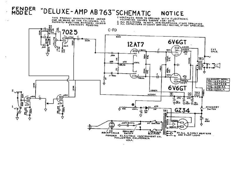

I have done some digging around, and have decided that perhaps a good building block would be the Fender Deluxe Reverb amp.
here is a link to the schematic:
http://www.schematicheaven.com/fenderamps/deluxe_reverb_ab763_schem.pdf
It has the PP 6v6 outputs, which my building block amp has, also.
Assuming I'll only be using one channel, which I will.. This amp simplifies greatly. I'd just use the normal channel.
I was slightly wrong in my original post, I said there was one 6av6, one 12ax7.. i forgot the second 12at7 for the phase inverter stage.
So I am left with one 9 pin socket, and one 7 pin socket in my chassis.
This schematic shows using 1 12ax7 for the preamp, with the tone stack between the two halves. I would like something with a little more gain, perhaps sort of a drive channel. Would I be able to use the 6av6, which I understand is 1/2 of a 12ax7 for added gain? If so, how would I do that successfully, and how would I implement control over it.. I'm assuming some sort of master volume, but where would I put it.
Any ideas?

My quick guess would be to put the extra stage at the plate of the first tube (shown there as a 7025).
Add a .022 DC blocking cap there (after the 100k resistor) and run it into your new stage's grid. After this cap you can also put in a 100Meg audio pot for an earlier stage volume control.
It already has a "master", which is just after the tone stack.
Just to clarify... I'm assuming you meant 1 Meg instead of 100Meg... or perhaps you meant 100K.. but 1 Meg makes sense to me.

Honestly, I'm a big fan of 12au7s and 12at7s for first stages in fender amps. I was kind of thinking that anyway, add gain with extra stages, and use the tubes with less gain to begin with. I'd rather have an extra tube to get the boost, and overdrive i want, and the sweeter clean sound of the lower powered tubes.
I could be dead wrong about that, but at least to my ear, dropping the 12ax7s out and putting in 12au7s, gives a much sweeter less harsh sound. Theres almost a more "fendery" sound that way.
Oddly enough, and I dont know if it has anything to do with just the tubes I have handy, or the fact that the amps were designed for 12ax7s, but I've never been able to gig with a 12au7. Every one I own is horribly microphonic, and howls like crazy.. all of them are tuned to just about a perfect A.. haha.
So, I think my plan is to build basically the amp in the schematic, with an extra stage.
The marshall schematics confuse me. I can't figure out what's going on in their preamps. All I know is that they get that massive gain sound at low volumes some how, with their master volume setup.
So there must be some way to mix and match the two.

If this works... here is the schematic!
Let me know if it looks like it will work, and more importantly sound good.

Looks pretty linear to me, and I don't see anything missing that would cause a major problem. As long as you are in the ballpark of plate voltages, and have researched the cathode values, etc., I would say give it a shot and see how it sounds.
My one second thought on this is that the tone stacks are designed to work better with a low impedance output, not sure how this will pan out with two straight stages in series. It's better to design the two gain stages with a feedback line (say a 220k resistor from the plate of the second to the cathode of the first), not changing anything else. That would lower the impedance. But then you could not have a volume control between the two.
Also a lot of guitar amps use a voltage amp/cathode follower which is also quite simple.

Using the 6av6 as a sub for the popular 12ax7 is a very practicle way to to go alternate....just wire them in same as each half of a 12ax7 and connect the diodes to the cathode (or not at all).....if the 6av6 (U100) is too strong it can be subbed with a 6at6 (U70).....there are others....6c4 ,similar to half 12au7(different pin out?)...these tubes sub really well,so well that I am making amps with these instead of 12xx7's as they are abundant and cheap and of high quality...I recently bought 6 NEC NOS for $16 ,try buying 3 NOS 12ax7 for that !
the only con with them is in combo's they may be microphonic ...and they use twice the heater current....oddly enough a little microphonics is not always a bad thing....cheers😀
Another note.....the tubes in this amp schem are 6v6.....in place of these you can use 6aq5,6005 and I think there is a Bendix one as well...again cheap NOS gold.....just gotta drop you plate volts to 270v max as they are small 7 pin tubes , same as 6av6, otherwise same as 6v6 in spec.....or the 9 pin 6bw6 can use 315v....I have made these amps and they sound better than Russian tubed commercial amps in my opinion........build on !!!
Notice in the schem above that half of one 12ax7 is not used .....good place for a single triode !
