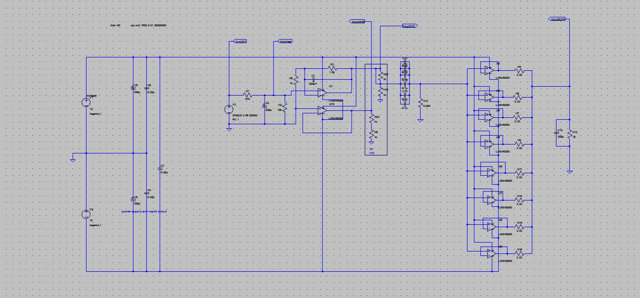

Here is something you don't see everyday. 😀 It occured to me that the desktop amp I've got going on in another thread could be chopped down and massively parallel LME49990's used for the output buffers. The LME49990s are relatively cheap these days at $2.50 each and have great performance, at least on the data sheet.
Going with using 1% of the 24ma maximum output current into 600R for balancing current would be 3.32R or so balancing resistors.

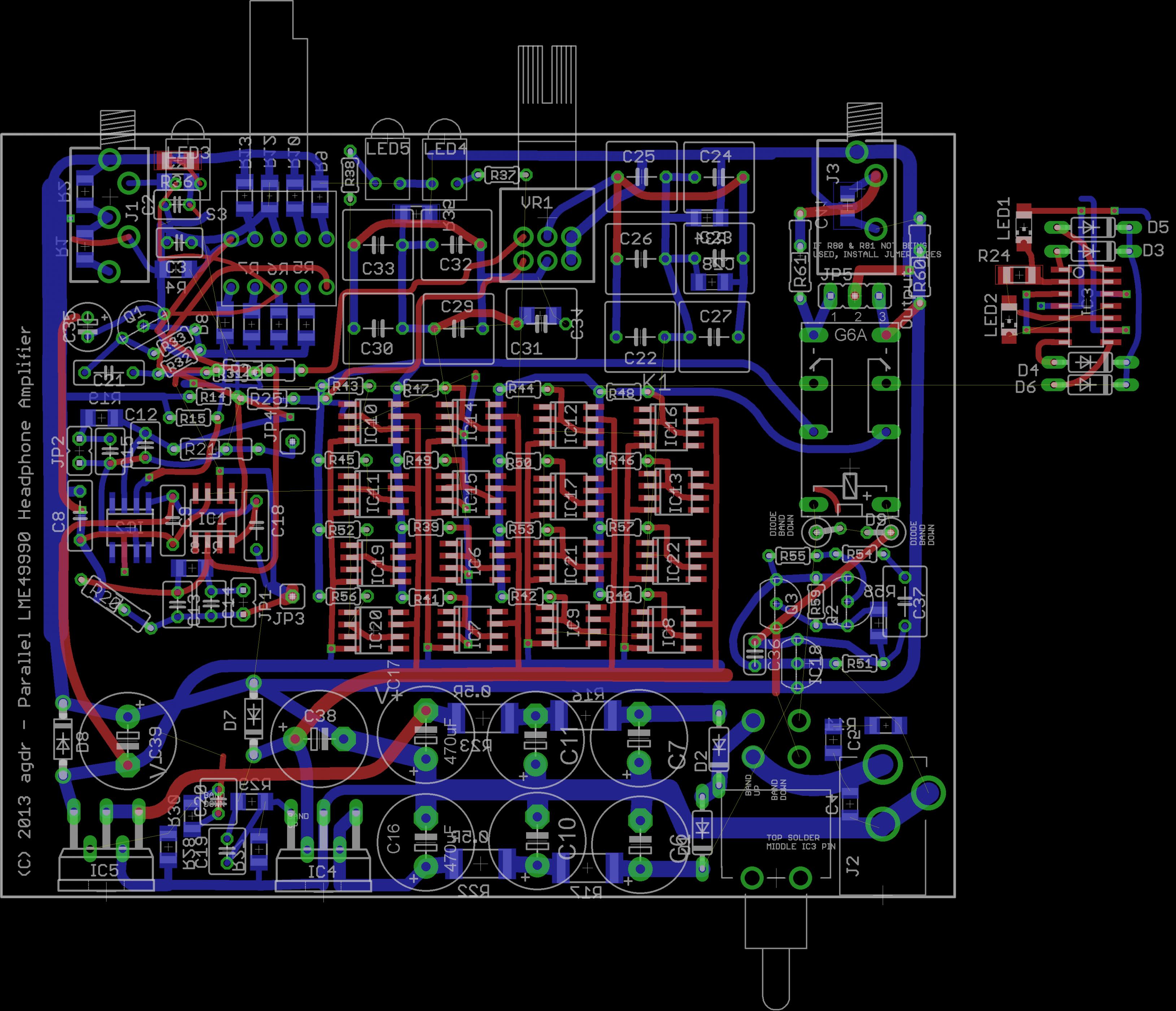

The layout below is just something I threw together quickly to see if it would even fit on a 80x100mm PC board (B2-080 case) and sure enough, looks like it does. 80x100mm gets the cost down enough to go 4 layer, with a groundplane under the LME49990 buffers and a boatload of decoupling caps at the power pins. 12Vac power transformer (wall wart) input so as not to exceed the 20V max on the LT1963A, so +/-12Vdc rails. The circuitry out to the side is the clipping detect circuit which could probably fit under the board.
Still uses two LME49990 chips for the gain stage / bass boost. If someone wanted to go direct DC coupled with no coupling caps in the path the DC offset of the LME49990s is probably low enough. Just leave out the 12 4.7uF film coupling caps in the middle and jumper one set of PCB cap holes on each channel to pass the signal along. Still has a 1K pot in the middle for low Johnson noise, something that wouldn't work if the pot was in front due to source loading.
I don't know if I'll try fabbing it or not, but if one of you layout wizards out there beat me to it I would probably buy a board. 🙂 I'm curious how it would sound. The data sheet seems to show 0.000005% THD with an 8Vrms swing into 600R with +/-15V rails, for a single chip, if I'm reading that graph correctly. That would be 13mA rms for a single chip. This guy has 8 chips per channel to feed lower impedances.

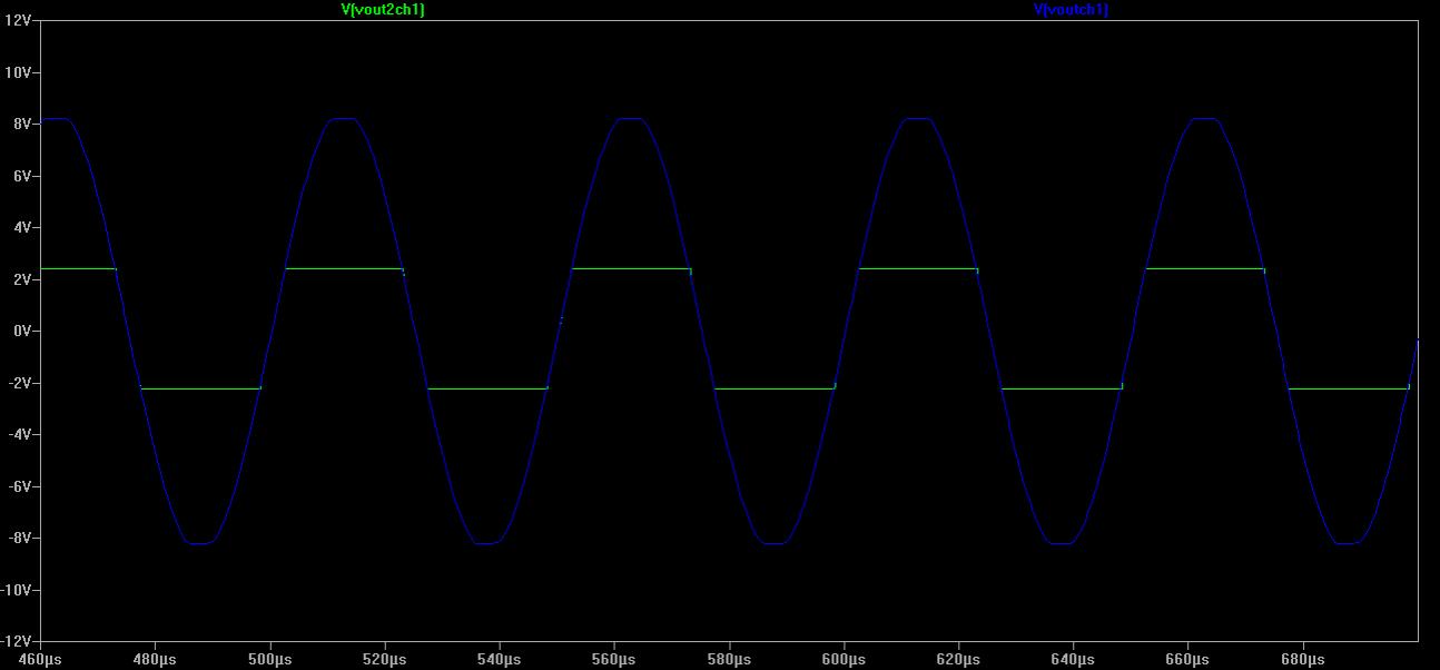

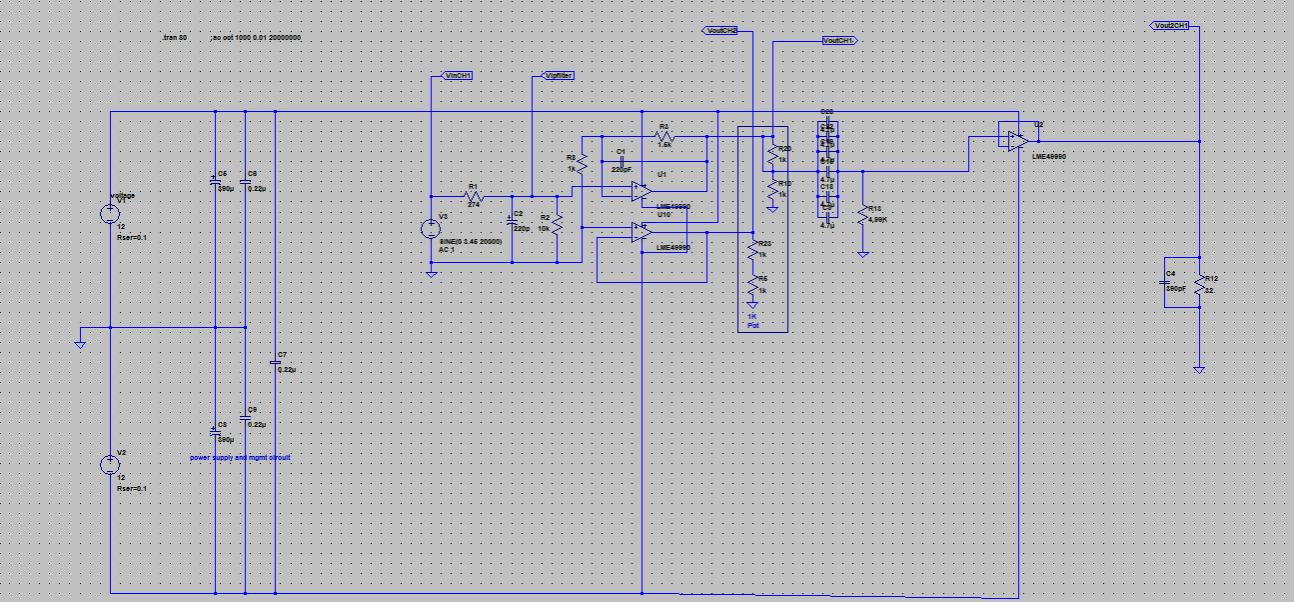

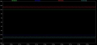

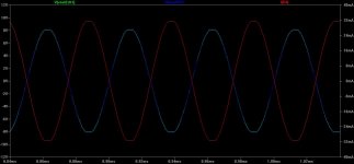

Here is what LT Spice comes up with for the massively parallel LME49990 headamp using TI's LME49990 sim model.
The first plot is with a single LME49990 output buffer feeding a 32R load (green plot, left scale). The blue is the output of the gain stage feeding the 1k pot, also a LME49990, feeding the 1K pot (the 1k attenuation resistor is jumpered). I've run the peak input voltage soure up to the onset of output clipping to find out what the model predicts for the +/-12Vdc supply rails. The red on the righthand scale is the current through one chip's balancing resistor, the per-chip current.
The results match up very well with the datasheet, which lists a worst case output voltage swing of 12Vdc with +/-15Vdc rails 3Vdc down from the rails), powering a 600R load. Here with 12V rails we can extrapolate to a max swing of around 12 - 3Vdc -9Vdc. The sim shows clipping out of the gain stage, with the 1k load at about 8.2Vdc. The single chip output into the 32R clips at 2.4V, a gallant try! The sim parameters are in the plot names, 20kHz 3.45Vpeak input in this case.

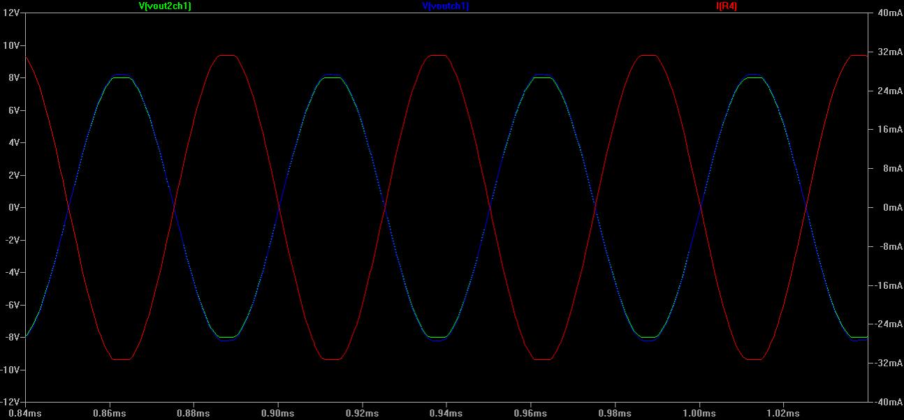

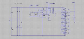

Now with the 8 output chips in parallel the sim plot looks amazingly good. The output of the 8 chips is clipping just slightly behind the gain stage at 8.0 and 8.2 respectively. But - is there smoke coming out? 🙂 8V peak would be 5.6Vrms, leaving about 6.4Vrms across each chip. The per-chip current is 32mA peak or 22.6mA rms. The dissipation in the chip is then 5.6Vrms x 22.6mA rms = 126mW, if I've done that right, which should be within the dissipation profile for the package including quiescent. So no smoke.
But the total dissipation over the 8 chips is 8 x 126mW = 1watt! 2 watts total over both channels (16 chips).

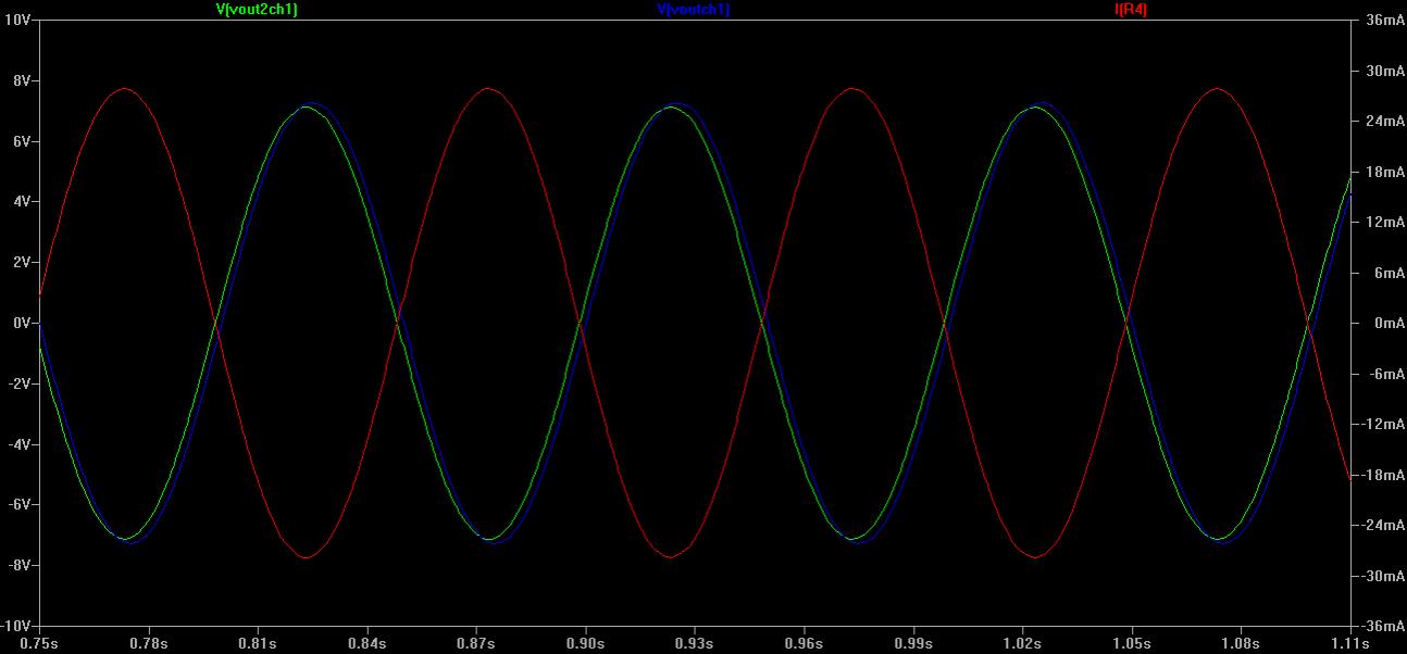

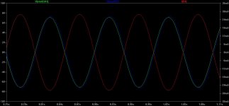

The next plot is the 8 buffer 32R load (plus 390pF in parallel on all these for cable capacitance) but at 10Hz to check that the 6 caps coupling caps on each channel are doing their thing. The simulation doesn't like to converge at low frequencies with clipping so I've had to back the input voltage down to 3.0V from 3.45 for convergence, but note that at 3.0V there is no clipping yet. Things at 10Hz are working as they should be.

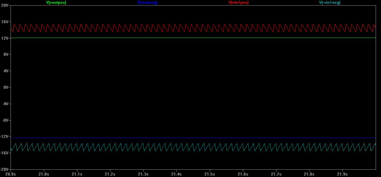

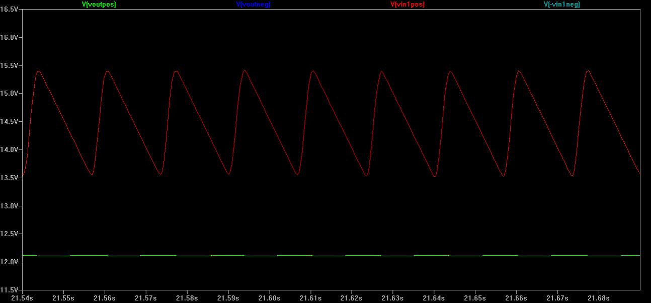

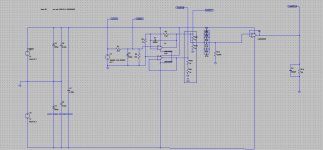

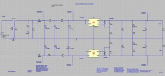

The final plot is the power supply using the LT1963A and LT3015 sim models. Predicts about 4mV of ripple with a 200mA per channel load, well within the PSRR of the LME49990 chips to deal with. The bottom of the ripple sawtooth is about 1.5Vdc above the output voltage, and the LDOs only needs about 0.5Vdc drop, so that leaves about a volt of wiggle room for power mains fluctuations (about +/-10Vac back on the primary side).

  • 3.45Vpeak input at 20kHz -  2.5x gain - 8 LME49990 into 32R + 390pF circuit.jpg
  • 3.45Vpeak input at 20kHz -  2.5x gain - 8 LME49990 into 32R + 390pF plot.jpg

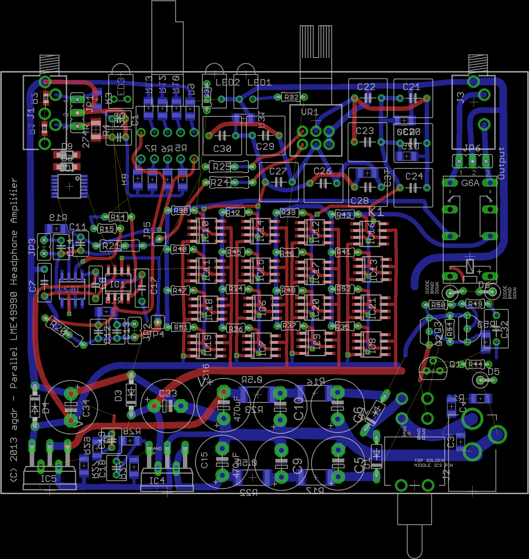

I cleaned up the layout a little bit, still just pondering if things would fit. It looks like the clipping indicator circuit will still fit if I go with the super-small PW package for the TLO64. The clipping indicator could just be left off (not populated) to avoid any super small SMD soldering. All of the rest is no smaller than SOIC-8 and 1206.
I'll eventually post a 4-layer version which will make the remaining routing pretty easy. One more routing layer and one full groundplane. I may make an exception to not having any signal currents in the ground plane on this one and instead have the required boatload of the LME49990 decoupling caps (not on there yet) connect to the ground plane.

My biggest hiccup so far on this amp is that the build really isn't looking very DIY. If soldering 18 SOIC-8 packages doesn't drive someone nuts, add 32 0603-sized decoupling caps and the super small TLO64 package for the clipping indicator. I think the board would need to be sent out for assembly, making it no longer DIY. Maybe there is something in the middle like getting the SMD parts done by an assembler but leave the through-hole parts as DIY.
By request, here are the Eagle schematic and PC board files for the 2 layer version of this amp if anyone would like to try messing around with it in the freeware version of Eagle. You will need to create and add some library parts that will come up missing, like the LME49990, the jacks, the rotary switch, etc.
Unzip the files and put them in a directory somewhere. In the Eagle (V6.4.0) Control Panel (first window that comes up when you start it) go to file -> open -> schematic then browse to the .sch file. Same for the board, file -> open -> board and browse to the .brd file.
