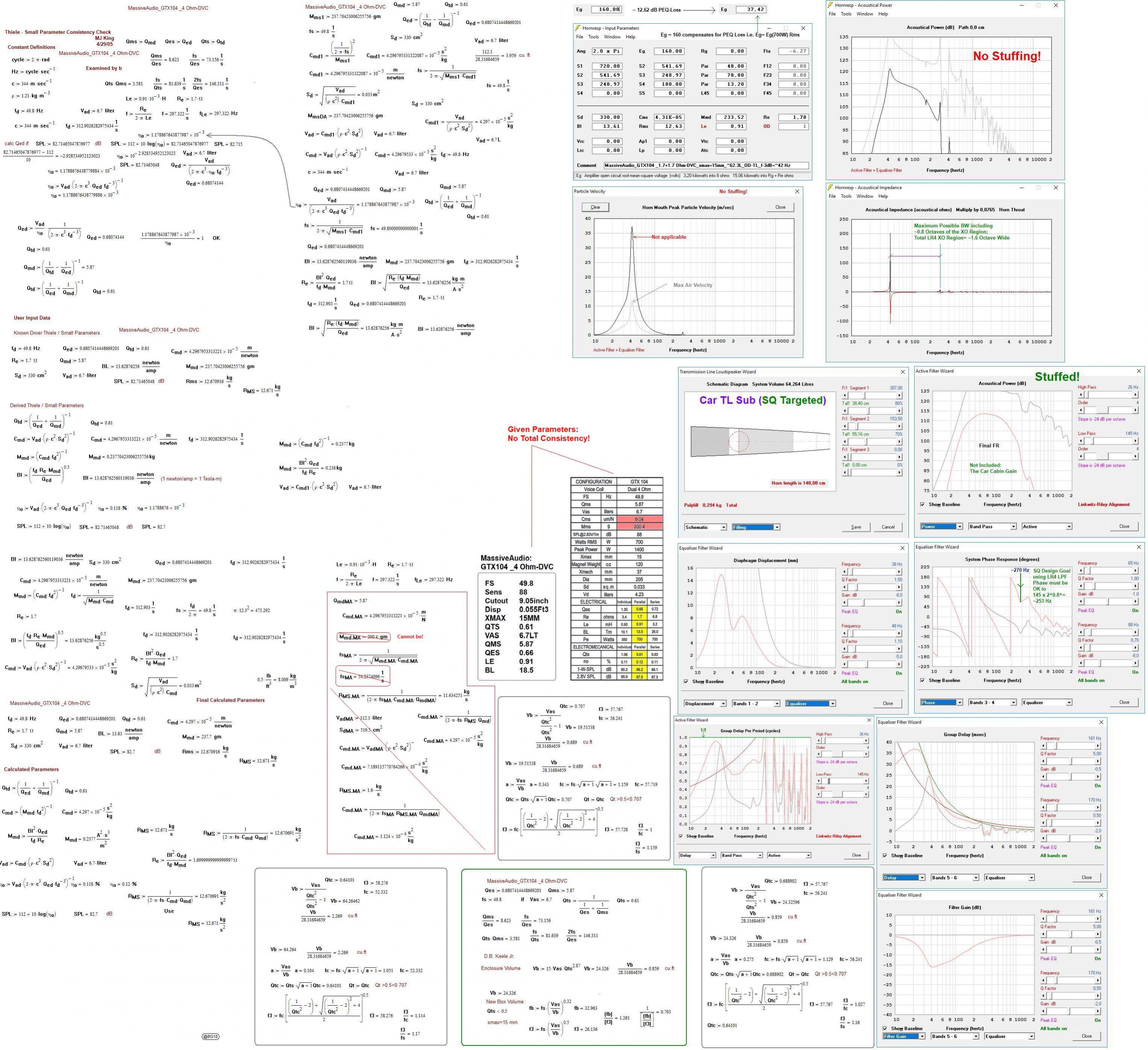

Hmm, Qts is OK for 4th order BP, BLH, but a bit high for a compression horn or 6th order......... Bottom line though is that the vent needs to be stupid large/long, so sealed is the only practical alignment.

Again, will need a stupid large/long vent that will be larger than the box, so better overall to convert to a TQWT.

Did you only measure one voice coil? I can't get the parameters to jive with what you have posted unless the Re is 3.2 ohms, which means one voice coil instead of both was tested.
For my model, I halved your Qes, used my derived Re, and halved Le for a parallel arrangement. This does not bode well for a sealed box at all. I have a 1ft^3 box, but the vent is 4" x 28" long to tune about right, and that will be a shallow and long booger with the port running out the side. I can't get a sealed box or 4th bandpass to model well at all, and I modeled with 400W input. You could go bigger volume to shorten the length, but this is already too large, IMO, for a car sub.

Okay, your previous post said Bl was 18.5, and the spec sheet shows 13.5, so this is where things went awry. I could not meet that Bl spec without it being a 4 ohm impedance.
Yeah, noticed this when I saw that Qts was in parallel, theoretically making BL = 18.5*0.707 = 13.08, so now with a revised 13.5 BL this makes it and/or the 0.61 Qts suspect per bjorno's calcs, not that it matters in this case.

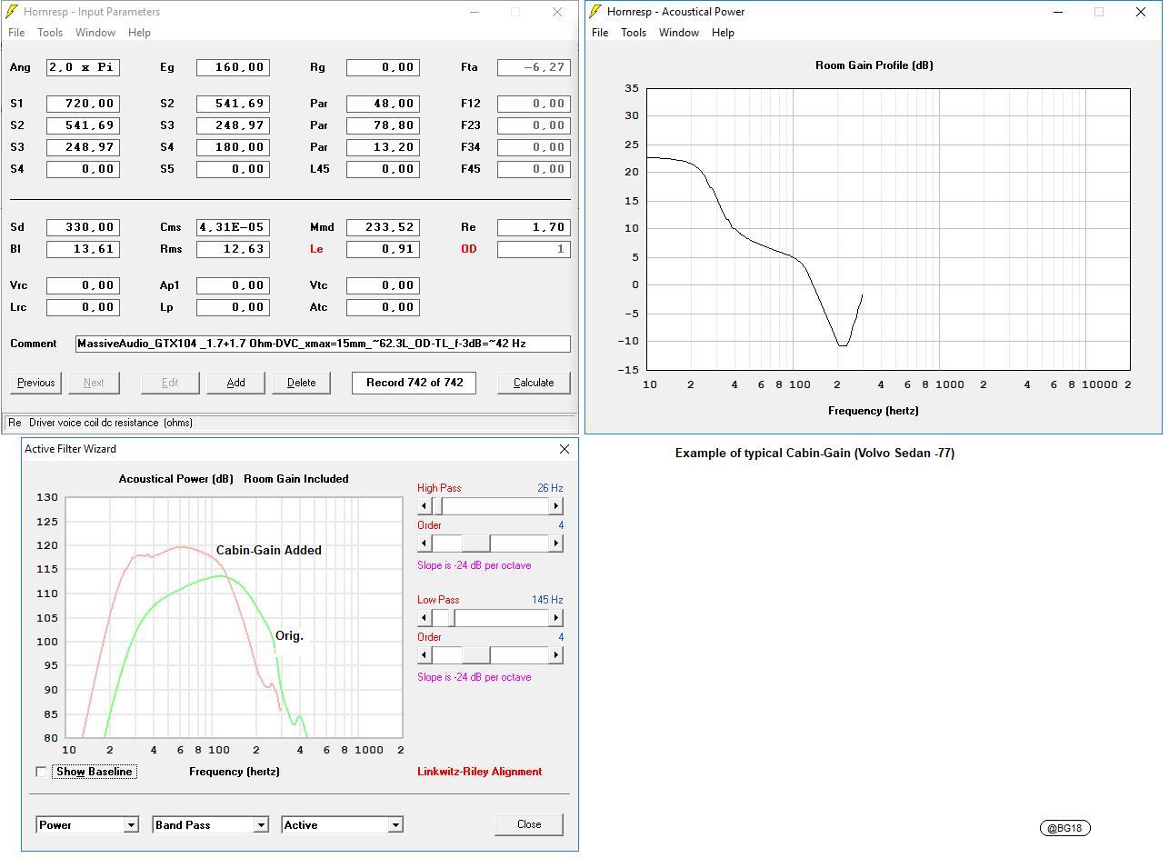

A single folded TL Box will be very easy to build..Any member here can help...Let see what we can do.
Adding some Cabin-Gain to the TL; Picture:

Holy cow. Strong to 20 hz. I have never heard a folded horn in a mobile environment. I bet they are impressive! I cant wait ti see what we come up with here.
