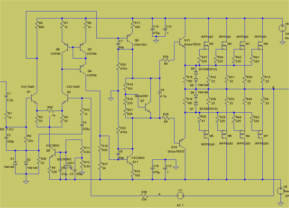

Here is the big one (7 pairs mosfet for safe 500w)
OS

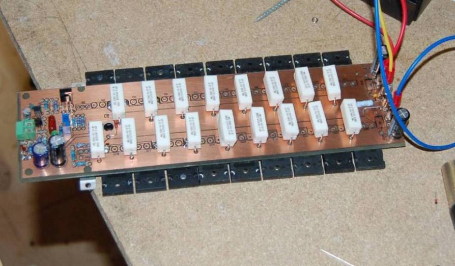

Some of us already have...or close enough to it. (see below - 2 of these bridged will easily do 1000 watts into 8 ohms)
