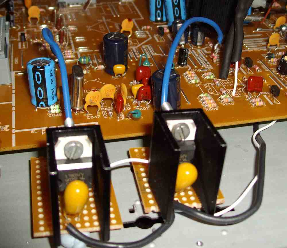

Another one
Third new dedicated +5v power supply (and the last one). This feeds digital signal processor (MN6625).
The quality of sound really impress me, lot of details, clarity, the bass is very full and rich. I'm starting to adore this player

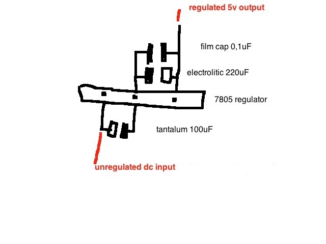

This is the simple 5v regulated ps that I've used in the player: 2 for dac and 1 for digital signal processor. I've cut existing traces feeding the chips. Please place the regulators as near as possible to chip pins. Add a little heatsink to regulators.

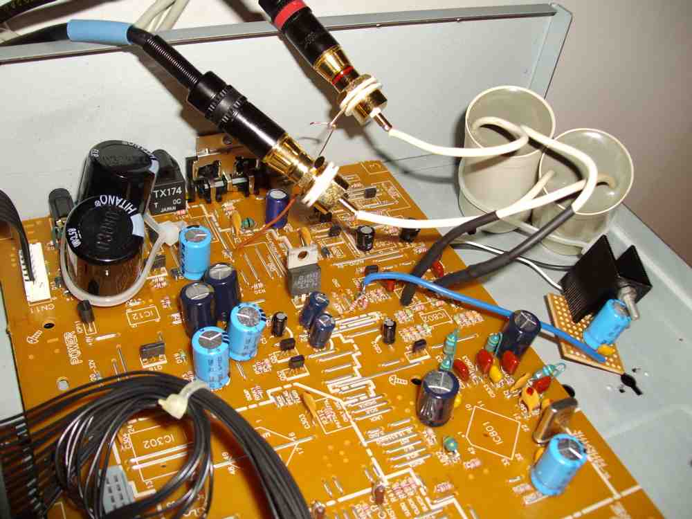

Signal goes from opamp outputs (pin 1 and pin 7) directly to new installed rca via 5uf polypropylene capacitors.
Bypass opamp pin 4 to 8 with 0,1uF cap (very short leads). I've added also a 1uF tantalum: be careful! pin 8 is positive and pin 4 is negative.
