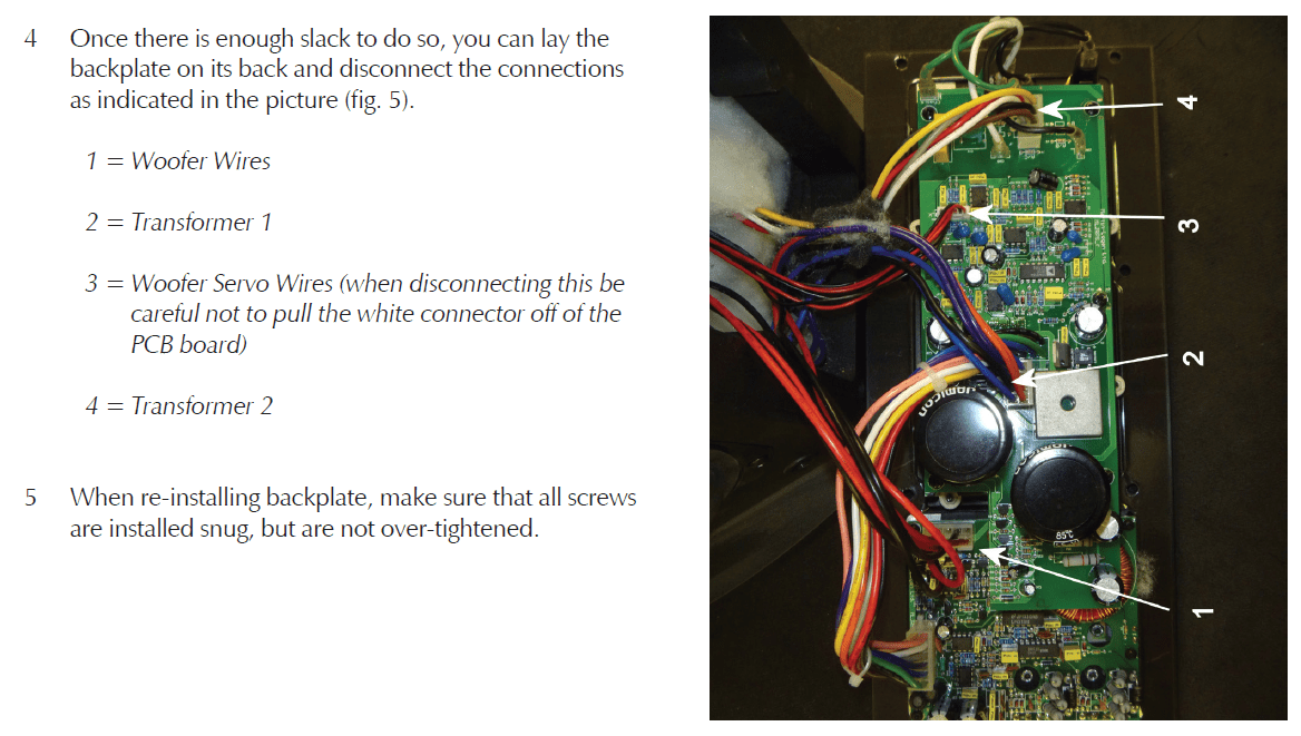

I don't have a picture of the "Depth i" board, but here is one for the Depth showing the servo sensor wires are plug 3. You should be able to identify a similar plug on yours, having 2 thin wires coming from each woofer. Feel free to post a picture of your board if you are unsure.
One thing that can reduce phase margin at low frequency is if one of the woofer sensors is not connected. You mentioned seeing signs of corrosion. You might try using contact cleaner on the sensor plug connector pins to make sure all 3 woofer sensors are getting their signals connected to the pre-amp circuitry on the board.

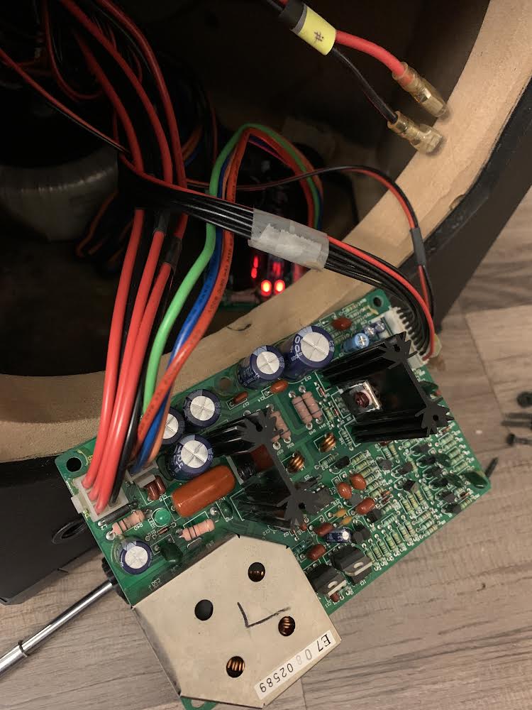

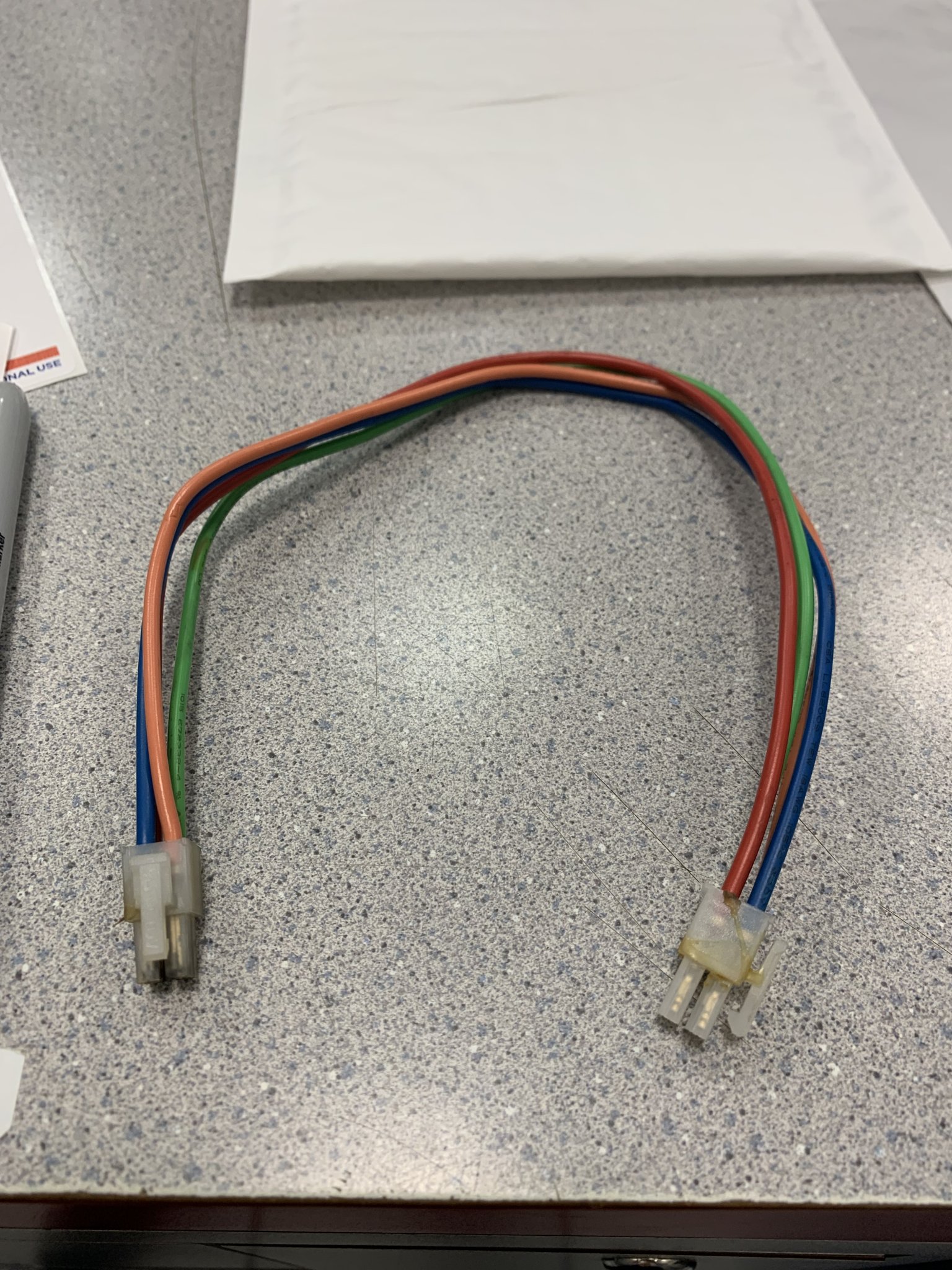

Latest update…. The sub is not working!! I opened up the sub and noticed the amplifier board green led is not lid. Meaning no power to the board? I am now suspecting the harness could be the issue? This one goes from power supply board to the amplifier board. The original amplifier board power connector got burned to the ground🙁 and causing the blackened connector as shown in the picture. Can the harness be rebuild… where do I even find the exact same connector and pins?
