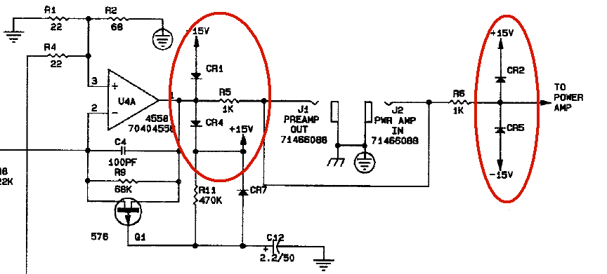

I'm attaching examples of Peavey liberal use of clamping diodes; in this case in a trusty old Bandit 75.

Skip the socket and add clamping diodes.
3/ I was going to take the loaner back, tell him to plug his pedals into the FX loop instead of the front end, and see how it stands up after that. Is it fair to say that the FX loop would be more robust as this is its intent, or will IC8 be the next candidate to start blowing (both IC1 & IC8 are TL072 or similar), or I barking up the wrong tree here?
Add protective diodes.
Or next he'll kill IC8.
Worst case, they don't hurt, and can be useful if somebody connects some speaker output into a loop in or something.

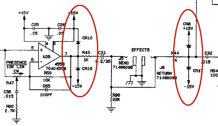

Awesome, I had a look at some Peavy Schematics and some higher end Valvestates, and they all had some form of Input protection. Not all had the same on the FX return/s which was going to be one of my next questions after seeing this.

I have soldered up the diodes on the Input, with a 10K resistor prior to the coupling cap.
On the FX return I have also added the diodes and a 1k resistor as I was copying the diagram above. I'll change that to a 10K.
In regards to the FX-out, how necessary is protection here? In a number of schematics I have looked at that had FX-return protection, I've found some that have it and others without.
As far as what *an effect* can do to it, it's unnecessary.
But the main idea is to protect that *output* from a much larger one: the *speaker* output.

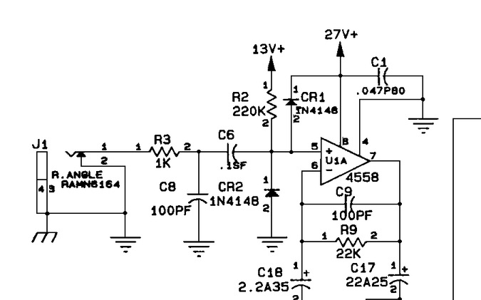

The Peavey amp in question is apparently a Rage158. It has a pair of 1N4148's tied to rails, and a 1K resistor in series. So this would certainly explain why it has stood up to more than poor old unprotected IC1 in the 8080.
The Free Information Society - Peavey Rage 158 Electronic Circuit Schematic
