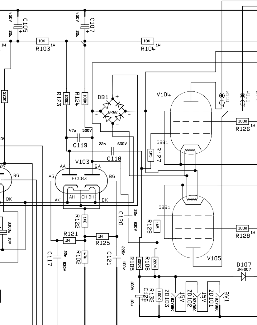

JTM-30
Great amp with proper tubes and speaker.
I have found,
Once warmed up....
Volume loss occurs in some of these amps caused by (microscopic) cold joints at the thick legs of the filament Bridge Rectifier.
Drove me crazy at gigs for a month, intermittent as it was.
I had to remove, clean and re-solder BR62 with a hot Iron.
Worth a try.
Tom
JTM-30
I have found,
Once warmed up....
Worth a try.
Tom

So, resoldered every suspicious joint on the tubes board, every wire and every component. Still low volume. I decided to look at the OT. Discovered this:
OT Primary: 390VDC on every pin, B+ and plate connections from 6L6.
This can't be right i guess...
Disconnected every wire from OT, measure DC resistance from B+ pin to plate pins, i get 7.8ohms on one side and 83ohm on the other. I assume that is wrong.
Thanks a lot for that tip!
OT center tap is connected to +V
Do you have +390V +V? ... then that´s what you´ll find there.
Tube plates are connected to those windings, which have low DC resistance, so you will *also* have +390V DC there, or *a little* less.
lease confirm, did you write 7.8 and 83 or 78 and 83?
Please remeasure just in case.
10% to 20% difference is normal, but IF you have such a large 10:1 difference, your OT is dead.
