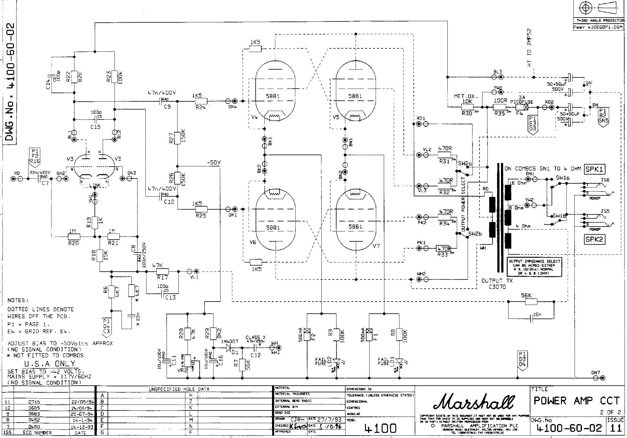

Hi
I have this JCM900 Model 4100 which is originally fitted with 5881 tubes. A friend bought 4 new 6l6s and asked me to replace them. After fitting them, when I turn on the amp, there is some low hum from the amp. The bias was at -50V, when I set the bias to minimum (-63V), the hum has reduced very much but it is still there. How do I set the bias. I heard that some resistors value need to be change. If so, which are the resistors and what are the values. Please assist.
Is this the right one?

In your case, you might want to increase the bias by perhaps decreasing R29 (8K2 to 4K7, or even lower). Be sure to properly measure the cathode current, either by inserting a 10 ohms resistor in serie with the cathode, or using a bias probe; 25-35 mA is about right, fine tune according to the desired tone.

You need to be able to *measure* the bias current in the output tubes. Can you?
Turning down to near zero current is shutting-off the tubes. Yes, hum goes down but so do small signals. Bias for appropriate current. Treating hum flaws is a different step.

Repeat with me: BIAS IS NOT A HUM CONTROL DEVICE
Bias is set to a given idle current so you avoid crossover distortion.
Setting tubes to cutoff (-63V 😱 ) is a TERRIBLE idea.
Set bias as specified by Marshall or by feeding a sinewave and adjusting for minimum visible crossover or by having tubes dissipate at idle soe 60% of full plate dissipation or simply set it back to original -50V, at least better than MESSING bias without clue.
Hum self cancels in the OT if it appears with same intensity on both halves of a push pull power stage so your hearing it means both halves are NOT matched.
measure individual tube cathode current, I think each has an individual 1 or 10 ohm resistor from cathode to ground, and if not, add it.
Then mix the tubes you have until both halves match.
