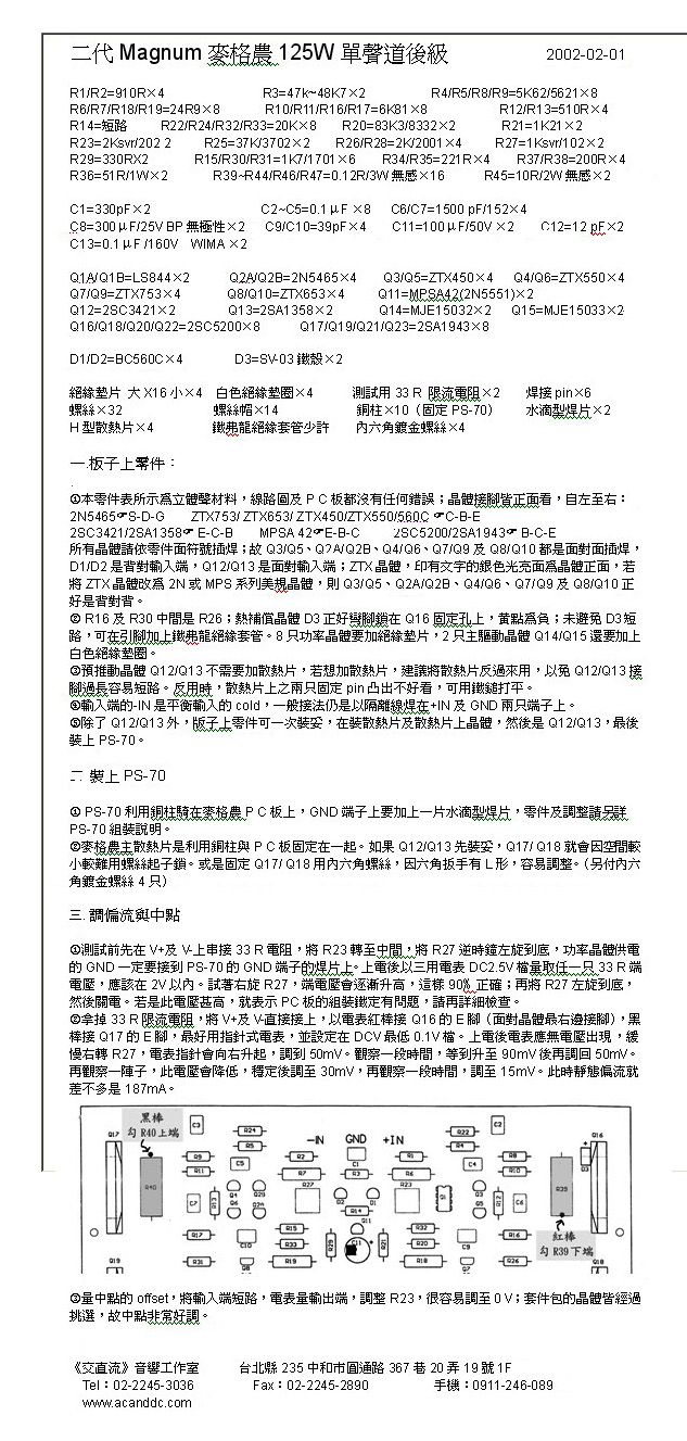

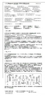

Thanks for the suggestion, it is not my design, basically it is a push pull design,with symmetrical design on the positive and negative rail. So matching is very much required to avoid DC out put. I will try to give a image of the circuit here.
I do like to express the schematic diagram, and upload it to the photobucket as a picture-jpg file but fail to show it here properly . Anyone like to show the steps to download the picture here from photobucket web??🙁
Yes, I just get help to show the diagram, and it works now.

I am searching and looking forward it to replace 50W MJE 15032/ 15033 as the driver in my power amp. It seems like an overkill. But I have HFE matched pairs (A1386/C3519) to replace not so matched 15032/15033. Any suggestion? The Q14/Q15 is the oreginal (MJE15032/033). The pre-driver pair Q12/Q13 (2SC3421/2SA1358) is also thought to be replaced by 2SC5171/2SA1930 fpr better sonic performance.
