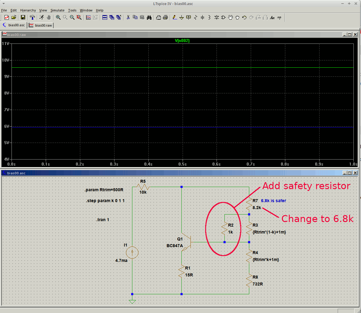

Got fixes for you - see attached image. Simulated and tested in LTSpice.
1) Add 1k safety resistor across pot - between pot wiper and top connection (junction with R17). Easier than soldering a resistor to an SMD part!
2) Reduce R17 to 6.8k for additional safety. This reduces the maximum (too much) bias that can be set with RTRIM.
These changes will protect the output MOSFETS if the trimpot fails, and also reduce the range of control from the trimpot, making it less touchy to adjust.
LTSpice simulation shows that after modification, you can still set the bias to your present value of 7.38 volts, with plenty of range on both sides.
The reason I mentioned the poor bias circuit design was because I suspected that this had caused the amp to fail in the first place. I think you confirmed that hypothesis with your measurements. The trimpot had become old and dirty, or oxidised.
The added 1k safety resistor won't protect the amp if somebody dials TRIM1 to maximum bias - that will still melt your MOSFETs. But if the trimpot wiper becomes scratchy and loses contact with the pot track, the safety resistor will drop MOSFET bias to a safe value.
-Gnobuddy

Great!
I'm not comfortable with replacing the R17 SMD resistor... Plus I don't have SMD resistors at hand. Better stay safe than sorry. I'm sure noone will ever dial the trimpot to maximum bias.
I should certainly replace the "Suntan"-branded trimpot (knock-off?) with a real Bourns part in the near future before the former fails.
I'll add the 1K resistor between the trimpot legs and report.
Thanks buddy! 🙂
I don't think you will really notice any significant change - that resistor only plays a role when the trimpot fails and the wiper loses contact with its track. If the pot is working, the resistor pretty much does nothing.
(Well, if we're picky, the added 1k resistor does very slightly affect the range of bias voltages available with the trimpot. But most of the available range is unusable in this particular circuit, so you won't notice any difference.)
