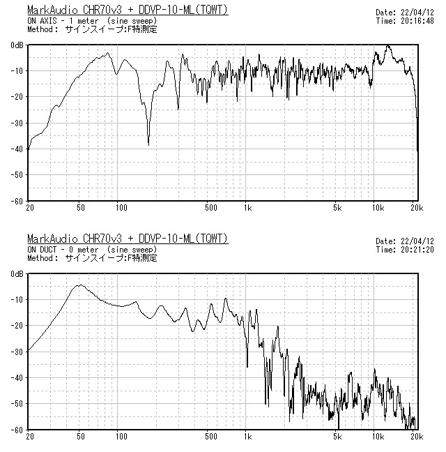

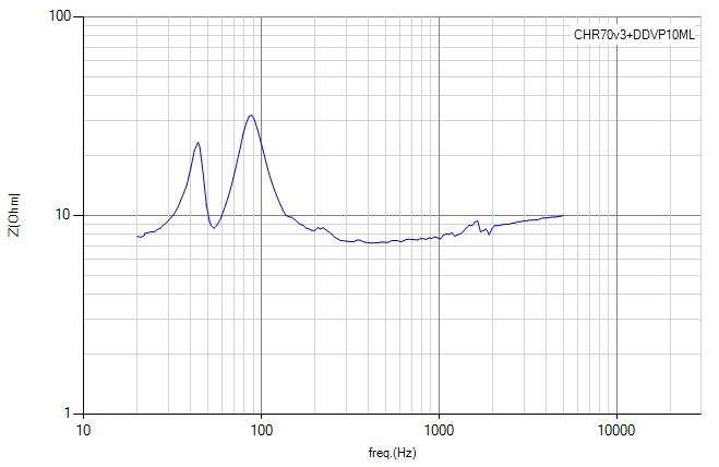

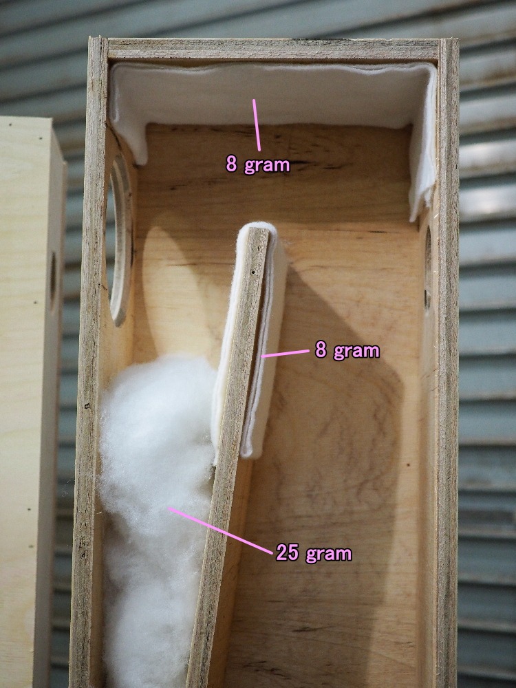

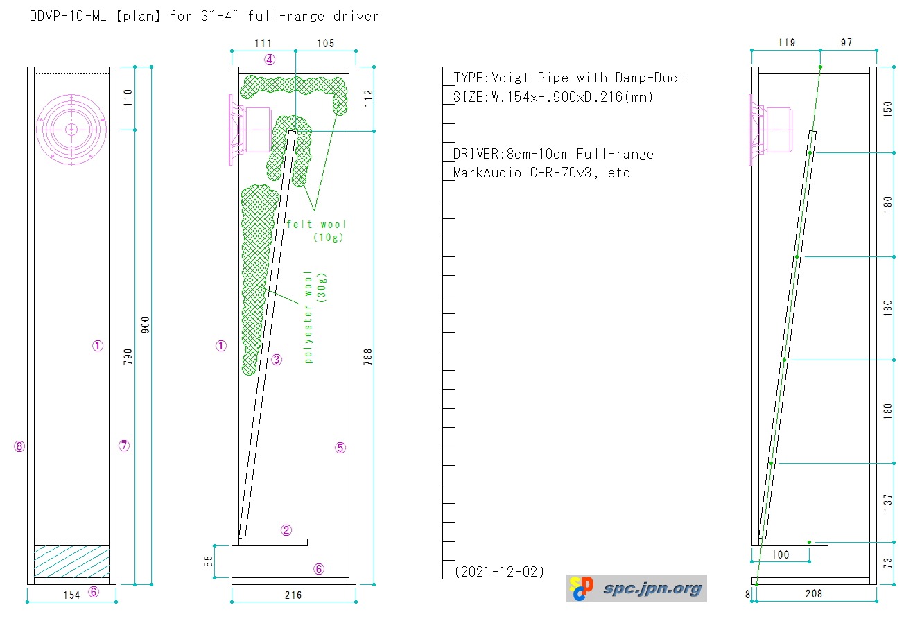

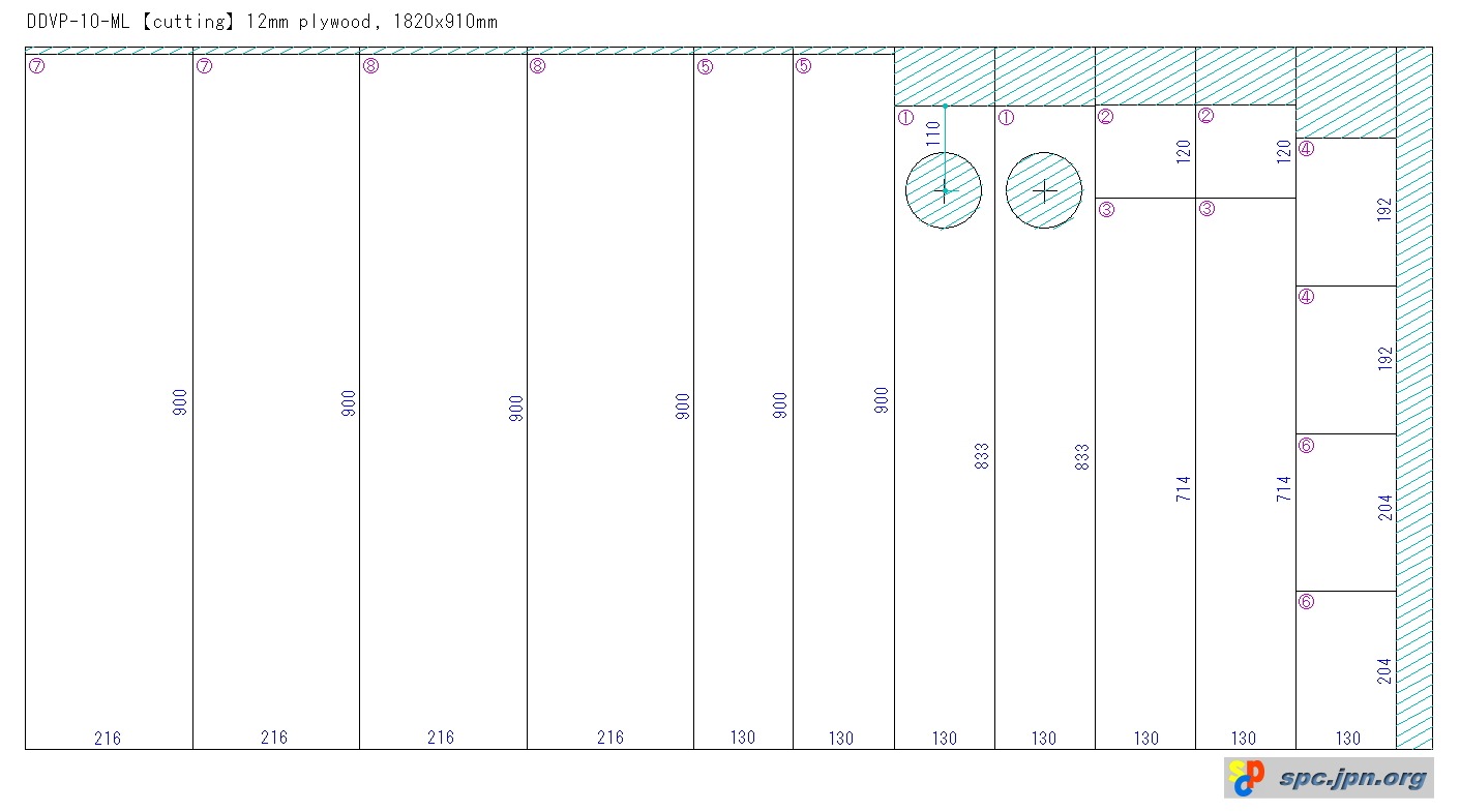

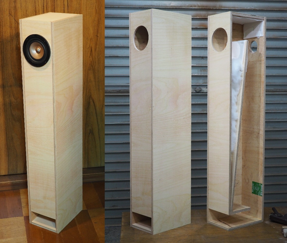

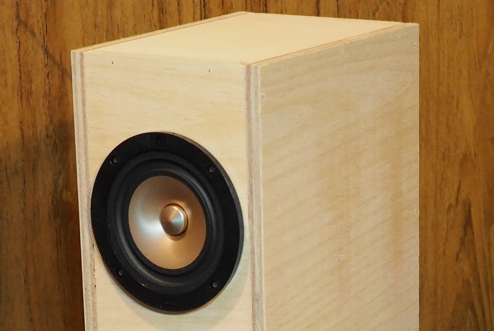

This TQWT can be made for two box in the Japanese standard size (12mm saburoku-plywood, 900mm*1800mm).
It is a reasonably priced speaker with necessary and sufficient low range and natural mid-high range.
According to the dimensions, both of those drive units have baskets physically wider than the external dimension of this box. Our friend does have a cabinet design for those units though: https://www.diyaudio.com/community/...alpair10-3-maop10-chr-90.367881/#post-6965212
