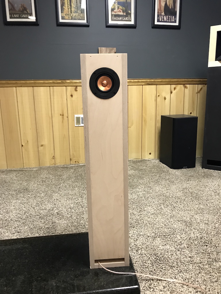

I had a set of the first gen Alpair-5 single-suspension speakers sitting around here for a while and decided it was time to do something with them!

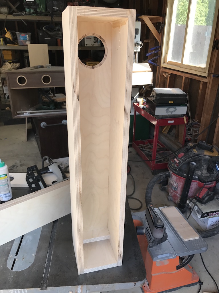

I was originally going to build a 2-way with a 12PW but found the Woden Design Giraffe ML-TL enclosure plan so decided to give that a try.
The results are incredible! Detail and transparency is excellent and on par with the other small Markaudio drivers but the amount of bass is shocking for such a small cone area! I'm guessing it is attributed to the lack of a rear suspension allowing more excursion?
Either way, these were slated for bedroom duty but now may end up in my main music room as yet another speaker selection! 😀

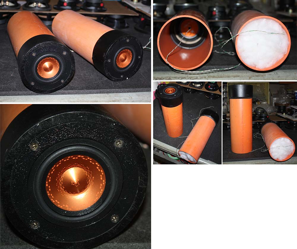

Do they have a dimple in the centre of the dustcap”.
Answering my own question, the Gen 1 dustcap was like the 1st gen CHR so quite different than what is seen in the picture posted. Here the 1st gen for comparison.

No dimple, with the new dustcap is indicative of a set of Gen 2 prototypes i guess (maybe i’ll know when i get the set of coppers i scored). The pre-procuction silver ones Mark sent us had dimples. The CHS-70 (which shipped only to the UK AFAIK) was a Pluvia 7 sans dimple. We have a couple sets of those. The dimple was 1st seen in the Alpair 10p and helps control HFs.
