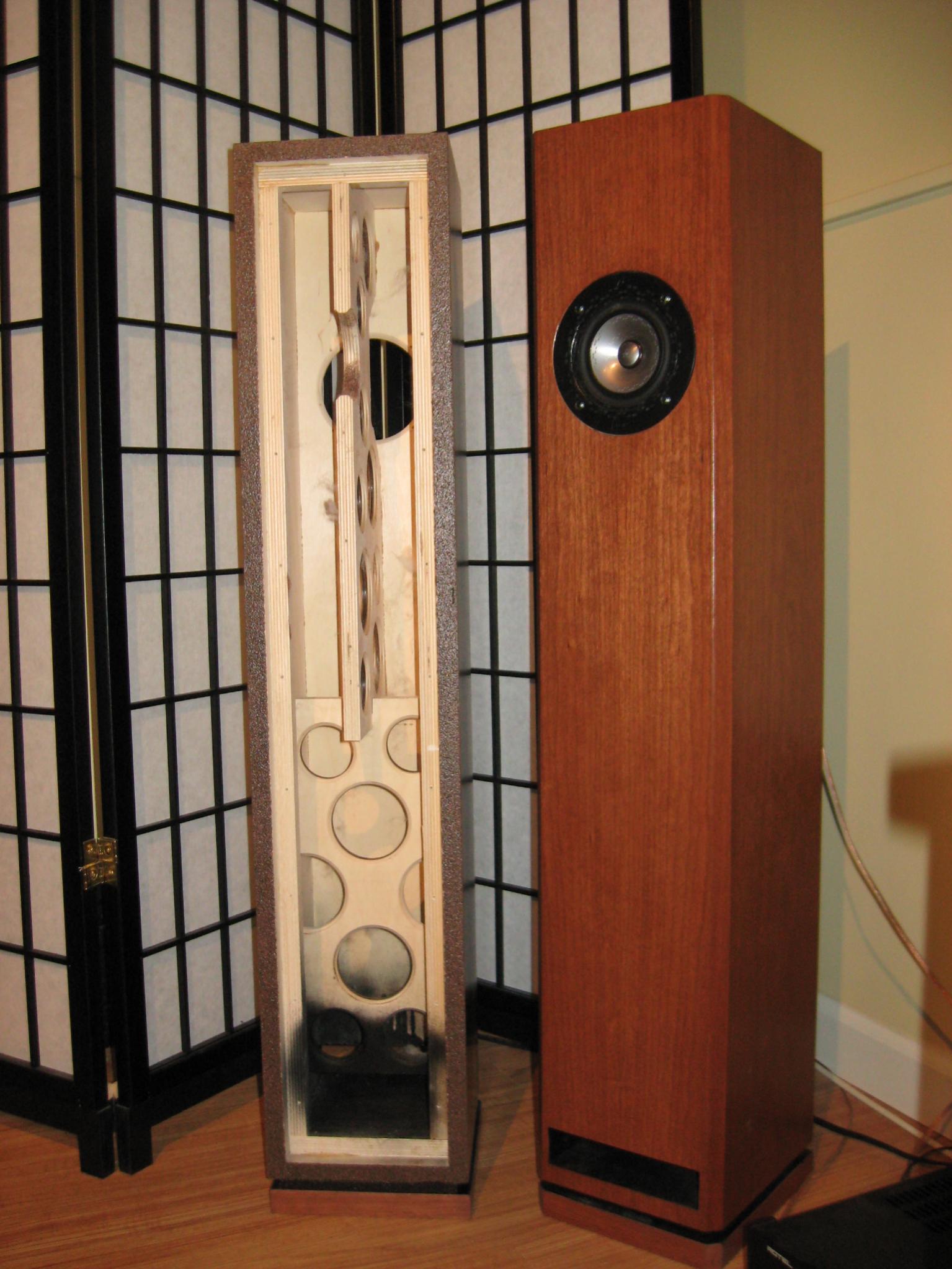

I have just completed a MLTL design for the Mark Audio Alpair 10.3 (metal cone) and 10P (paper cone) driver. This design with the one change mentioned below will work with either cone variant. My model (internal dimensions of 40", width of 6", depth of 7.5"). The driver is centered an internal distance of 8" from the top. The port is centered and located an internal distance of 36" from the top. The port has a 1.25" radius (2.5" diameter) and is 6" long for the 10.3 and 5" for the 10P. A stuffing density of 0.75 lb-ft3 is placed in the top half of the box.
Thus the overall box size (with 0.75" thick material) is 41.5"H x 7.5"W x 9.0"D.

This MLTL is a straight box with no taper. It should be easy to construct. The MJK software includes the effect of stuffing so results are cleaner than the Leonard Audio results.

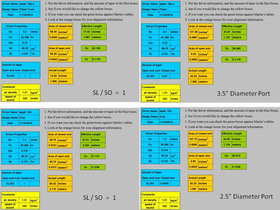

Using the T/S parameters on the Madisound site, the TL alignment spreadsheet suggests a larger cross section area(67in^2) cabinet and larger volume(~1.5cuft) for the paper cone Alpair 10P Gen.2, than the metal cone Alpair 10 Gen.3 (45in^2 and ~1cuft).
Modeling room gain might change optimal port tuning goals, and some flared ports screw in from the front baffle to allow adjustment.
Might be worth some study for the paper cone Alpair10P before you cut wood.

Plots for 10P MLTLVariant and Comments
I've done some bookkeeping in the first post in this thread (retitled to include the 10P design). As I could not change the original file download in that post, I have attached two performance files to this posting. One is the same file (but relabeled) as in the first post for the 10.3 MLTL performance while the second file is for the 10P MLTL.
I appreciate the inputs by Bob and several others. As we know a MLTL design is not unique as the modeler can vary different parameters--tube length, cross-sectional area, driver location, port location, port diameter, port length, stuffing amount, etc. You can change these factors and achieve the results that you prefer while others may prefer a slightly different design for their needs. You can also model a MLTL in your specific room with MJK's software so you can adapt it to your situation. Also as pointed out by Bob Brines you can alter the system response to suit your taste for damping.

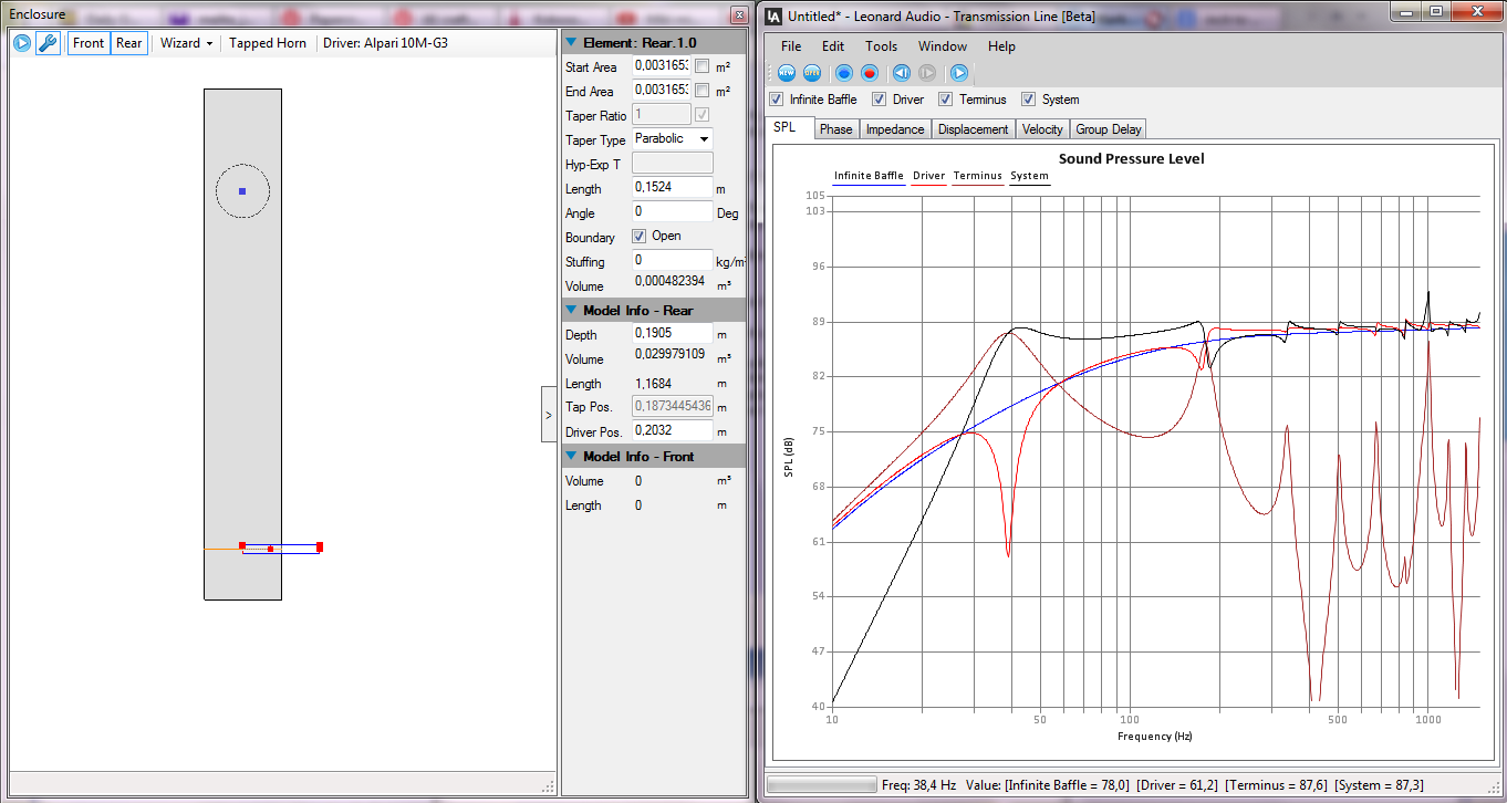

Very nice. Did you already build it?
I did simulation in Leonard Audio and it looks also very nice. Here is picture of simulation.
