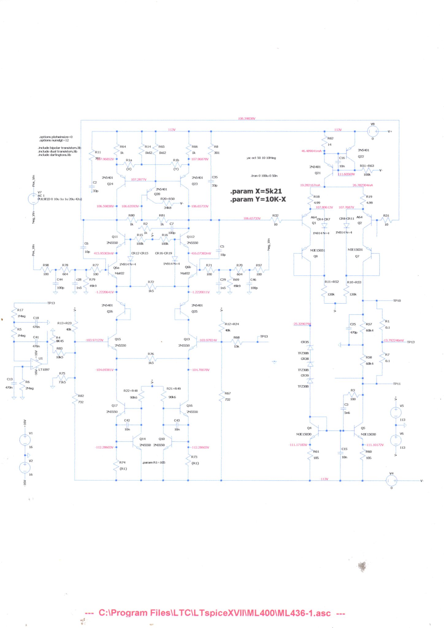

With 5mA and a Hfe of ca. 500, input current will be 10uA.
With a 49k9 input resistance, this will result in 0.5volt.
With a dual LM394 or Mat02 with a lower Hfe, you will get a higher input voltage.
Replacing the 2N5551 won't change to the input offset, the are used as cascodes to the input dual.
Trim R1 to get 0Volt on the output of the servo when the amp is stable after 30 minutes.
In the attached schematic you can see all voltages.

Hi Hans,
thanks for your extremly fast reply 🙂
i will check .... in the troubled Amp the LM394 was replaced by two thermically coupled transistors (BC550B ... looks like a bad choice .. shouldn't it be a "C" type).
Will try to get an LM394 to make both amps identical ...

#1 is done ... indeed now i have -0.45V on both input Pins. 0V on Pin 6 of the Servo Amp and +/-113V as Operating Voltage.
Will take care of #2 next week ..... hope to get the same results ... 🙂
