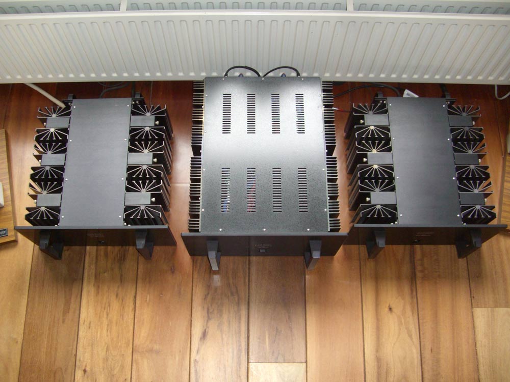

Brian,
By looking at your picture, an idea came up. Maybe it is possible to put a washer on each screw holding the top cover. If the washer is placed between the cover and the frame it will create an air-slot to let air out.
(You could even cut something like a thin gasket out from some filter
material and put there to keep dust out).
Just a crazy idea but may work.
BR / Mattias
BR / Mattias
Sounds not bad at all . Should do the same for the bottomplate because there's a need for letting cool fresh air in before you can let it out. Thanks Mattias

If you have a problem with washers rattling or don't like the silver against black, consider everyday black Neoprene O-rings. They'll damp any rattling, keep your paint or anodizing from getting scratched, and be nearly invisible against a black chassis. And they're cheap--about the same cost as a metal washer.
Grey
Grey
If using O-rings of rubber just make sure the top / bottom cover are not part
of the structural framework that make up the rigidity of the mechanical design.
Metal washers are available as black or just paint them.
Don't know the word in English but the type that is not coplanar wont rattle.
/ Mattias
