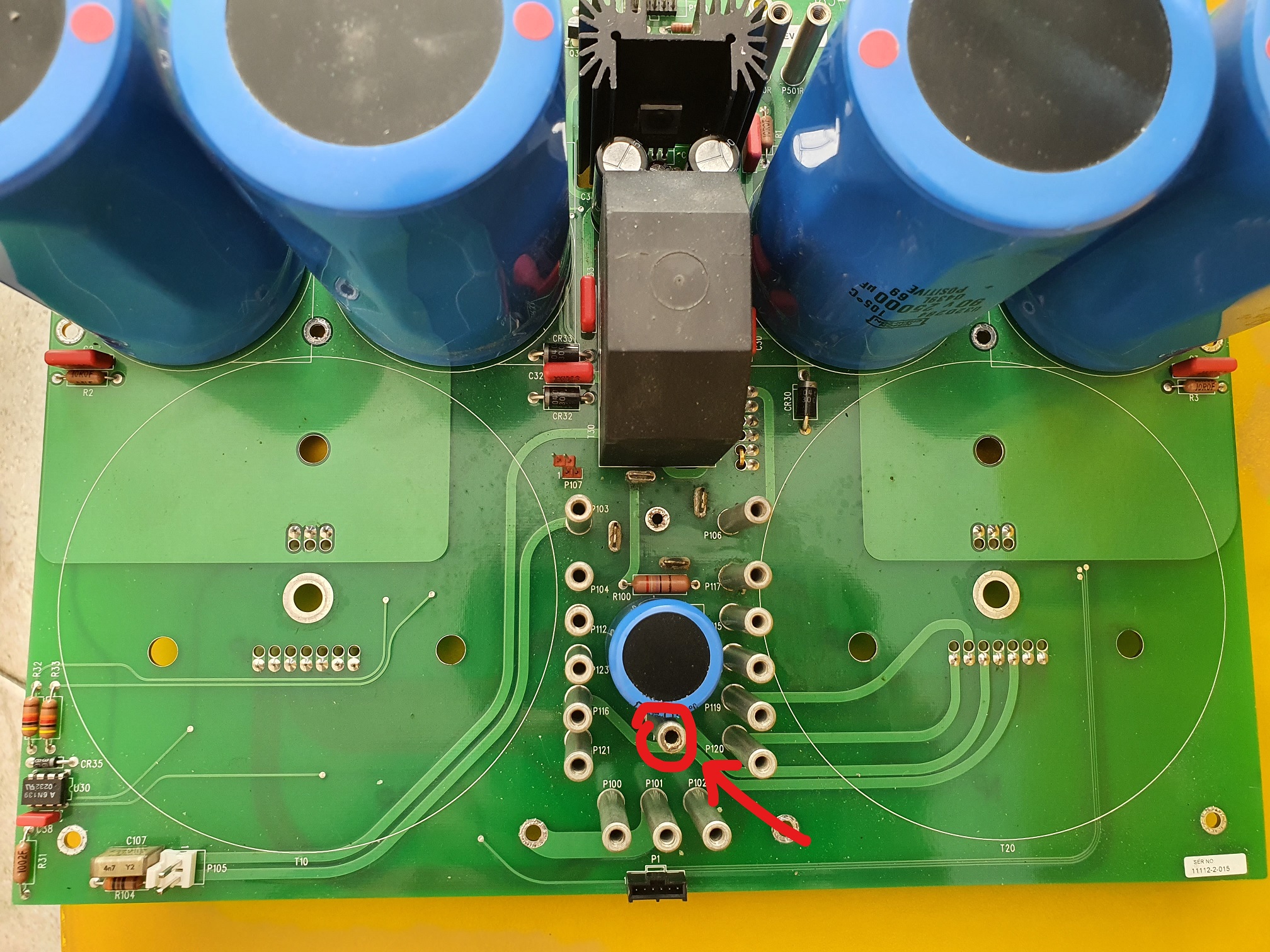

Ok, first the noise problem was on the right vg board. I found that on the left vg board there were 4 transistors replaced by an earlier repair. I saw they where replaced by the original transistors mps8099/mps8599. And also on the right board one of these was replaced by an 2n5401 which is not a good replacement for it. So i thought maybe there are problems with these transistors and i replaced them all for MPSA06/56 which is a direct replacement for the mps8099/8599 and is currently available. I just picked up a bunch at a local electronics store for 25 cents a piece. See picture 1 where i marked the transistors i changed

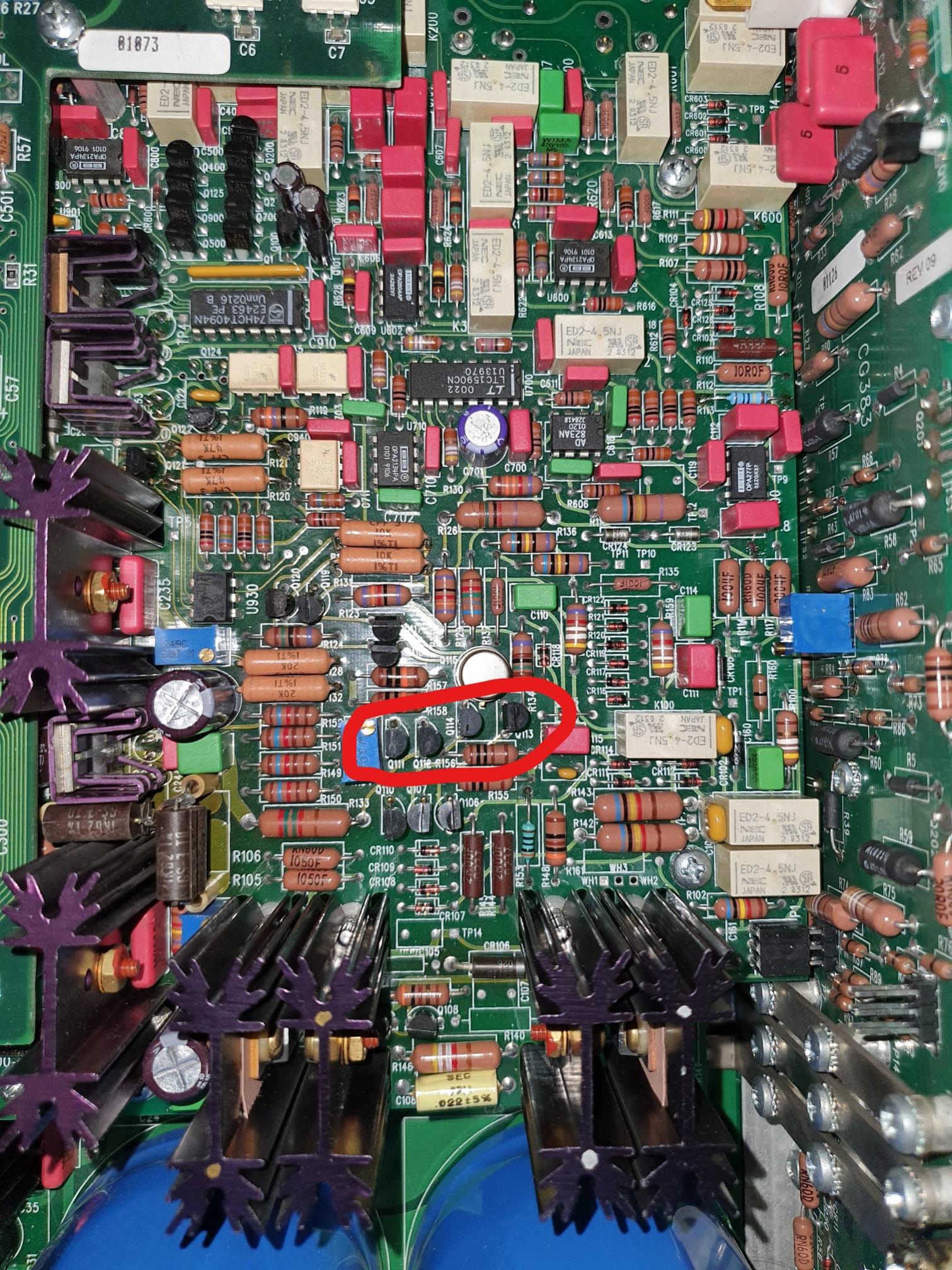

The second problem was the loud pop when turned on. When I was doing some testing I saw in the corner of my eye a little flash on the input power selection board on the power supply board. When i looked closer and tried a few times I saw a big spark fly across the leads of one of the NTC's which are on this little board. I removed it and saw on the bottom side there was a big burn mark and someone has done a repair there by scratching out the trace that goes over the 20V tap of the transformer which has a standoff which is not used for my situation (Europe 230V) but was directly under a trace on the input selection board. Apparently the back EMF of the transformer sometime creates a big spark which even jumps through the board... So I drilled out the standoff's which aren't used see picture 2.

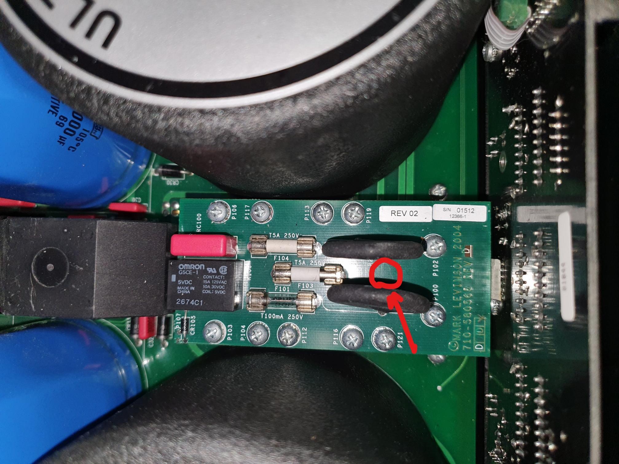

See picture 3 for the input selection board:
