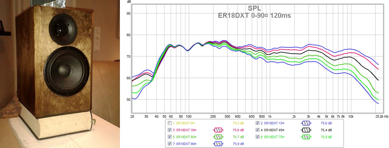

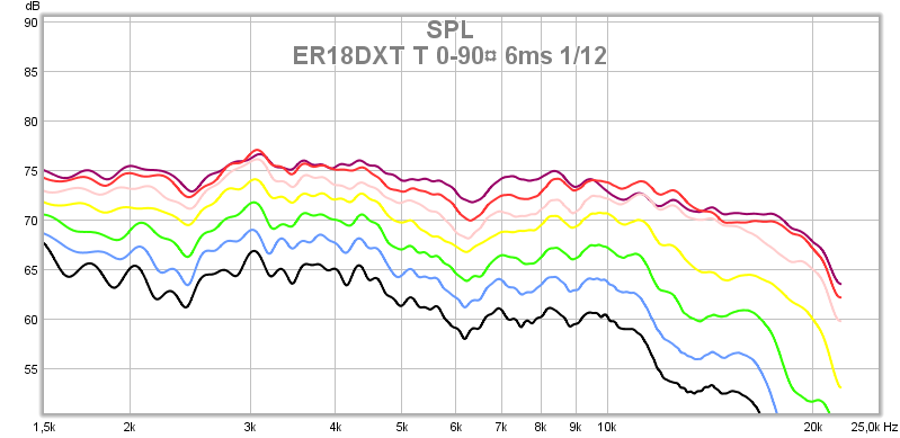

The Seas ER18DXT ported two way
And my speaker in modified Zaph L18 box (different tweeter location) - Remember, that with offset tweeter left/right off-axis responses are different!

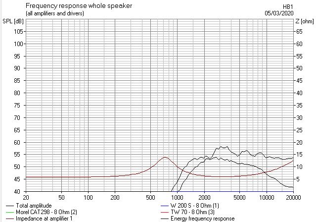

I did some recent simulation on a similar Morel CAT378 waveguide. Not hard to recreate the impedance to 6 ohms with a parallel LCR with R=10 and a small 0.1mH coil for the lift in impedance at HF.
The series LCR came out as 10R/47uF/1mH. Good enough I think. An Fs notch is designed to prevent excursion and distortion at the Fs when using a single capacitor. That's how it works. Why do something less optimal? 😕
