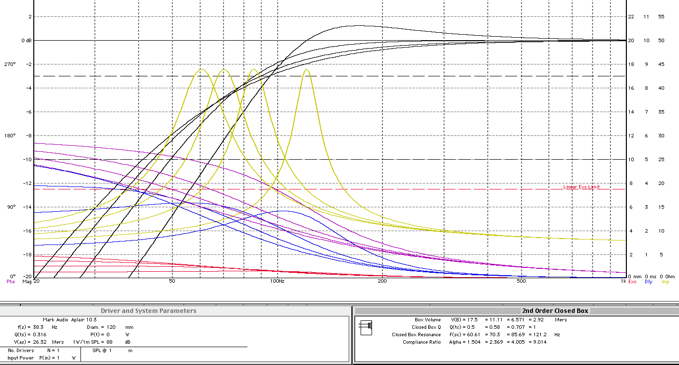

If you want a Heresy size/shaped box, then this is an opportunity to do a WAW. Put the A10.3 in a midTL out the back or in a sealed sub enclosure. With sealed you could use the natural 2nd order roll-off as 2 poles of the low pass. This does limit you to an XO of about 86 hz (butterworth, 6 litre sealed/damped).
If you use the low frequency XO, a subwoofer with extended HF would work. If crossing higher you need a more extended woofer as opposed to subwoofer.
If you stick with sealed 2nd order, a plate amp with a complementary 2nd order XO would fill out the system.
Crossing higher would allow for greater maximum loudness, and give the A10.3 a bit more room to shine mid-top.
The woofers that 1st come to mind are the CSS SDX10 which are probably extended enuff for both arrangements.

Attached are the reverse engineered plans i drew.
dave
